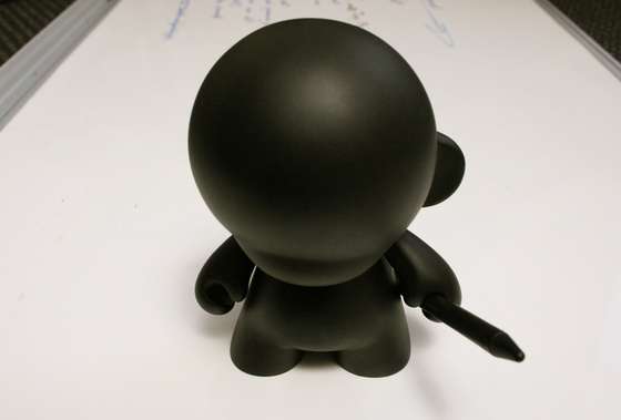

Each Munny comes with a few random accessories. A big pencil, a cape, goggles, all sorts of stuff.

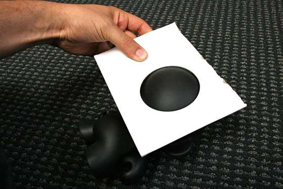

I bought two drivers that are reasonably small at 3". This was pushing it pretty close to what would fit on the Munny and to be sure everything was where it should be I measured the diameter of the back of the driver and cut that out of card stock.
I then put this card onto the face of the Munny and traced out the circle.

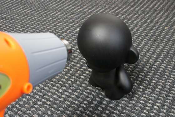

The vinyl that the Munny is made of is pretty firm when it's at room temperature, but heat it up with a hair dryer or a heat gun and it softens up oh so nicely. After that the Xacto cuts through it like butter.

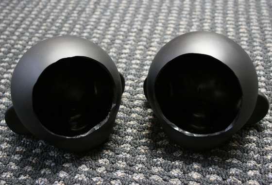

Here's how the Munny heads look without their faces. Cute, huh?

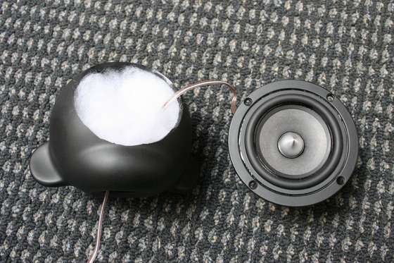

Thread the speaker wire through the neck and stuff the head with some polyfill.

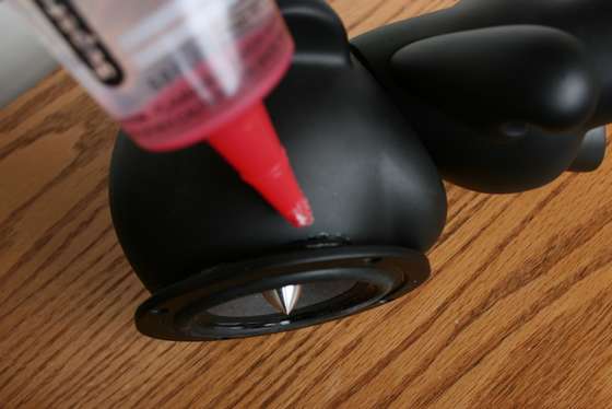

I was considering using bolts to keep the head in place, but the look was a little too S&M for my taste so I decided to seal the connection with some Lexel.
Run a bead around the whole driver, tie it up, and let it sit over the weekend.

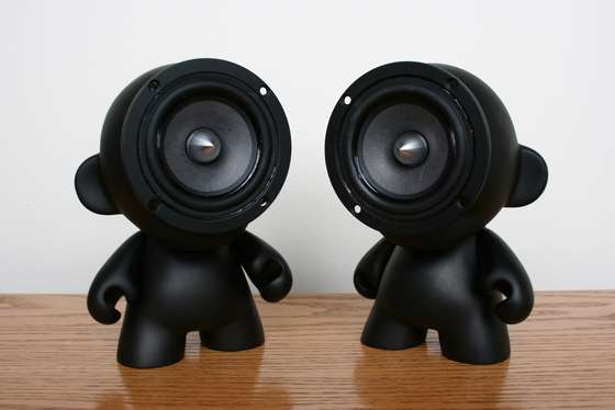

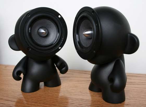

The Munny speakers are all set and ready to go. Hook them up to an amp (I'm using a Sonic Impact T-Amp), run in an input from an MP3 player or your computer and you're good to go!
IThe Munny speakers are all set and ready to go. Hook them up to an amp (I'm using a Sonic ImpaThe Munny speakers are all set and ready to go. Hook them up to an amp (I'm using a Sonic Impact T-Amp), run in an input from an MP3 player or your computer and you're good to go!
