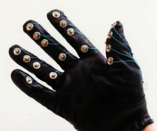

Key-Glove Recipe Ingredients
  • 21 Dritz nickel "snap on" 3/8" snaps from local fabric store ($ 5)
  • 1 pair of black leather gloves from Wilson Leather ($ 20)
  • 1 CompUSA 101 Key keyboard model #MKB931 ($ 15)
  • 1 spool wire wrap wire from Radio Shack ($3) (Douglas J.A.R. Sasse suggested: doll house wire)
  • 1 spool of black heavy duty thread ($ 1)
  • 10+ plastic zip ties ($ 1)
Directions
  1. fasten 13 male snaps to fingers of leather glove (4 each per first three fingers and 1 on pinky finger)
  2. fasten 8 male snaps to thumb (I put 4 down middle, 2 along right edge, 2 on back)
  3. cut 21 lengths of wire wrap of suitable length to reach keyboard encoder board (apprx 24inches)
  4. solder wires to buttons and run wires along back of glove
  5. sew loops across wires to hold wires onto back of glove

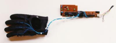

  6. remove encoder board from keyboard
  7. solder 13 wire leads from fingers onto contacts at bottom of board for pins 4-16 of longer of two plugs (CN2) for membrane keyboard
  8. solder 8 wire leads from thumb onto contacts at bottom of board for pins 1-8 of shorter of two plugs (CN1) for membrane keyboard
  9. fasten zip ties around lines between glove and encoder board
bad acii art schematic:
   cable         _____________________________________________
==============] |}     1-16         1-8       encoder ic      |
                |______________________                       |
                                       |     o    o    o      |
                                       |______________________|
_________________/////////// __\__________________________
                    keyboard contact sheet
