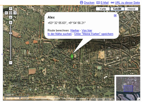

Sending a Google Maps link
Now that we have received and converted the GPS position, we are ready to send an SMS with a link to GM. The link has the following format:
http://maps.google.com/maps?q=
%29&t=k&z=
You can embed a message, which appears in the popup box. It is surrounded by encoded brackets. Further you can control the zoom factor and the type of map (k=satellite, m=map).

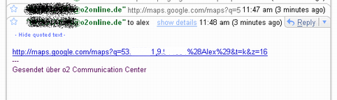

Now this link has to be send as an SMS to an SMS-to-email service that forwards the SMS as email to the given address.
Conclusion
If everything went well, you should be able to click the link and see your browser opening Google Maps with your position.
