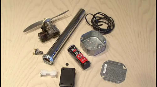

What You Need...
  • A glow-plug which you can get HERE
  • Electrical Box with cover
  • Plumbing Extension Tube (12" X 1 1/4" in diameter)
  • Hobby Box
  • Momentary Switch
  • 2-AA Battery Holder
  • Epoxy
  • Rubber grommet & wire
  • Flash cotton, flash paper and Flame Resistant Confetti
