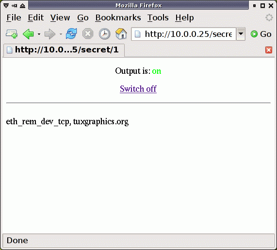

Here is a screen shot of the web-page that the eth_rem_dev_tcp-2.X displays:
Fig. 2. The atmega88 based web-server, screenshot with mozilla firefox
