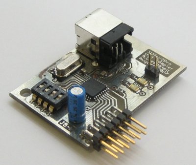

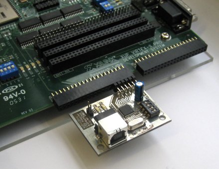

The photos below show a PCB containing a MAX3420 device. The board is designed to connect to a Digilent XUP-V2Pro FPGA development board.
F1 F2
MAX3420 USB Board MAX3420 connected to a Digilent XUP-V2Pro

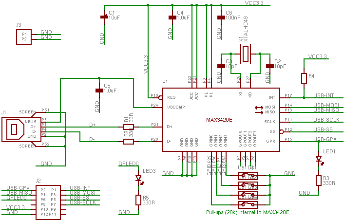

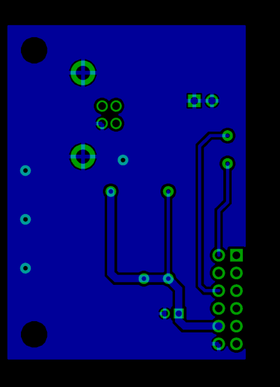

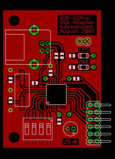

Below are the Schematic and PCB layouts for the board. Use the link below to download the Eagle CAD files.
eagle.tar.gz
The board is driven by a 3.3V supply. The connector pin arrangement allows it to be plugged directly into header J5 of a Digilent XUP-V2Pro FPGA development board, as shown in the right-hand photo above.

MAX3420 PCB Schematic (Click, for enlarge)
F4 F5
MAX3420 PCB Top Layer MAX3420 PCB Bottom Layer

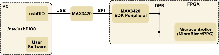

Example System
Below is an example setup of using the MAX3420 to connect a PC and a microcontroller embedded on an FPGA. There are 3 main custom parts to this system.
  • The MAX3420 PCB. This uses USB to connect to the PC and SPI to connect to the FPGA.
  • The Linux device driver. This creates a device file, /dev/usbDIO that user applications can read from and write to.
  • The EDK peripheral that connects the SPI to the OPB bus
Example MAX3420 Setup
Information on the MAX3420 has already been given above. Details on the Linux device driver and the EDK Peripheral are given below.
