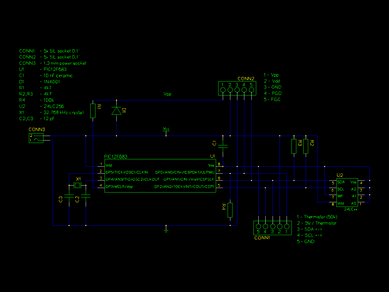

Circuit Diagram
Temperature Recorder
Click to enlarge
The circuit diagram is very simple with only the ADC interface (one resistor), I2C interface (2 resistors), EEPROM IC, ICSP (socket, 1 diode and 1 resistor), oscillator (crystal and 2 capacitors).

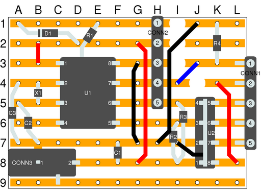

Circuit Layout version 1
This simple PCB layout diagram shows the placement of the components on the stripboard. The view is from the top of the PCB, the same as in the photograph.

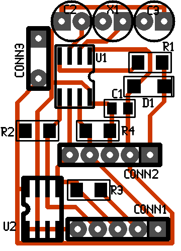

Circuit Layout version 2
This PCB layout diagram shows the components and the tracks on the custom PCB. The view of this PCB is from the side with the tracks although some of the components are mounted on the other side.

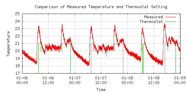

Example Results
The image below shows an example of the results that can be obtained with this device.
The temperature logger was placed next to a household thermostat for a period of about 10 days in the winter at the start of 2007. On the plot are shown the measured temperature and the thermostat settings (an "intelligent" thermostat that aims to reach the target temperature at the specified time). The measured data clearly matches the thermostat setting for the time that the heating is active and during the day and night that it is inactive the temperature drops rapidly.
