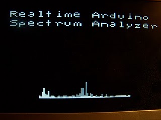

Once again, I decided to put the old travel DVD player's screen to good use by using as an output device for the Arduino. Though the DVD mechanism is broken, the screen allows for standard NTSC composite video input.. runs on an attached rechargeable battery pack (can also power the Arduino.)

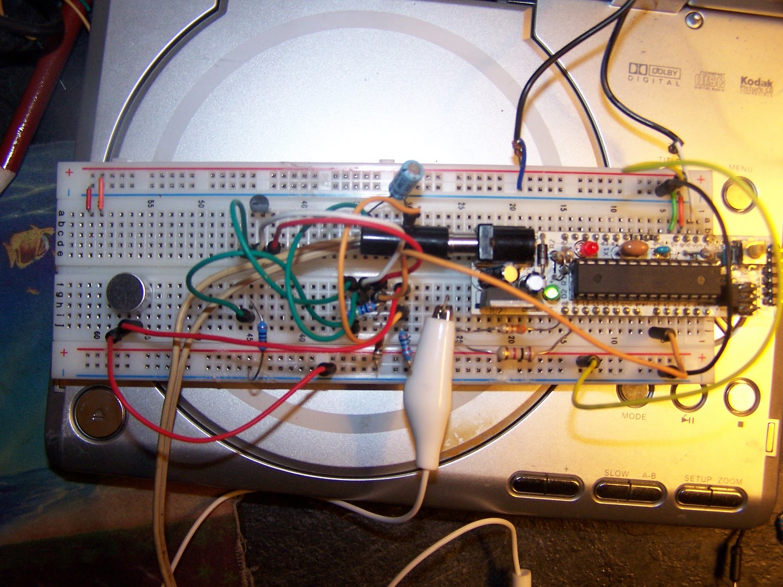

The other piece of the puzzle is collecting and processing audio, so we have something to display on our little display.
The first piece- data collection- is fairly standard. I use an electret microphone (which alone only produces a few mV output, far too low for our Arduino to use directly) with a transistor amplifier as the signal source, which is then sampled via the ADC on the Analog 0 pin of the Arduino.

So, to produce our desired outcome, we just need to get the whole show together and hope it can perform. With only a handful of cheap components (a few dollars at most), it produces a perfectly usable and quite entertaining realtime 64-band video spectrum analyzer. Though not really "useful" for any real purposes, it makes an entertaining party display out of any television with a video input...
There are a lot of improvements which can be made- the first being the amplifier gain to make it a bit more responsive, and optimization of the FFT code. In reality, it's the drawing of the bars which takes the most time per sample/display cycle..not the matrix math!
The circuit required is a simple microphone and transistor amplifier, as well as two resistors connected to D8 and D9 to provide video signal.. drawing is a much bigger pain than you'd think!
