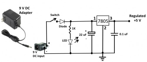

The circuit diagram of this project is shown below. A 5 V relay is driven by a PN2222 transistor that is controlled by RB3 pin of PIC16F628A. Digital inputs from the 4 push buttons are read through port pins RA2, RA3, RA4, and RB0. The functions of these push buttons are discussed in the operation section below. A standard 16×2 character LCD is used in the project to display the the device status, program menu and time. The LCD is operated in 4-bit mode, therefore, only 6 I/O pins of PIC16F628A are required to drive it. A piezoelectric buzzer provides audible tone when the timer is started and stopped. It also beeps when the device is turned on or off. The + 5V power supply for the circuit is derived from a LM7805 regulator IC. The input to the regulator is given from a 9V DC wall adapter.
Digital timer switch: Schematic Diagram
Click to enlarge
Схема питания для цифрового таймера на PIC16F628
In the circuit diagram, the pins 15 and 16 of the LCD are shown open. These pins are available only in those LCDs that have a back light illumination LED. The pins 15 and 16 are the anode and the cathode of the LED. If your LCD has the back light LED, you can connect these pins to the power supply terminals with a 39 Ω resistor in series. The backlight LED enhances the readability of the LCD display in low illumination condition.

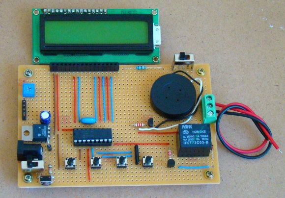

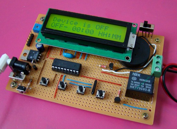

The complete circuit soldered on a general purpose prototyping circuit board is shown below.

Now lets see how it works. Suppose, the device connected to the relay switch is needed to be turned on after 2 minutes. Further, once it is turned on, it is required to be on for next 20 minutes. In this case, the off time is 00:02 and the on time is 00:20, in hh:mm format. Once the timer is started, the device will be turned on after 2 minutes and remained on for 20 minutes. After that it will be turned off again. The following video shows how to do this.
