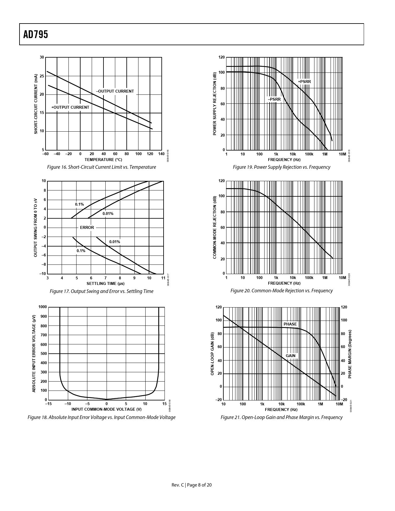

Pages / Page21 / 9 — AD795. 120. 100. A) 25. B) d. +PSRR. T N. IO T. –OUTPUT CURRENT. RRE. …
RevisionC
File Format / SizePDF / 334 Kb
AD795. 120. 100. A) 25. B) d. +PSRR. T N. IO T. –OUTPUT CURRENT. RRE. –PSRR. CU T. +OUTPUT CURRENT. Y L P. IRCUI. R S. O P. –60. –40. –20. 140. 10k. 100k. 10M
AD795 120 100 A) 25 B) d +PSRR T N IO T –OUTPUT CURRENT RRE –PSRR CU T +OUTPUT CURRENT Y L P IRCUI R S O P –60 –40 –20 140 10k 100k 10M
AD795 30 120 100 A) 25 B) d m ( ( N +PSRR T N IO T 80 –OUTPUT CURRENT C 20 RRE JE –PSRR CU T RE 60 +OUTPUT CURRENT Y L P 15 P IRCUI U -C 40 R S RT E HO W 10 S O P 20 5 0

84 00 00 Figure 16. Short-Circuit Current Limit vs. Temperature Figure 19. Power Supply Rejection vs. Frequency

84 00 00 Figure 17. Output Swing and Error vs. Settling Time Figure 20. Common-Mode Rejection vs. Frequency
1000 120 120 ) 900 V (µ 100 100 E 800 PHASE AG T ) L 700 80 80 B O d rees) ( eg R V 600 IN 60 60 D ( GA IN RRO 500 G E GAIN R OOP A UT 40 40 400 P -L N N I E SE M E 300 A OP 20 20 UT PH L 200 O 0 0 ABS 100 0

84 00 00 Figure 18. Absolute Input Error Voltage vs. Input Common-Mode Voltage Figure 21. Open-Loop Gain and Phase Margin vs. Frequency Rev. C | Page 8 of 20 Document Outline Features Applications Connection Diagram General Description Revision History Specifications Absolute Maximum Ratings Thermal Resistance ESD Caution Typical Performance Characteristics Minimizing Input Current Circuit Board Notes Offset Nulling AC Response with High Value Source and Feedback Resistance Overload Issues Input Protection Preamplifier Applications Minimizing Noise Contributions Using a T Network A pH Probe Buffer Amplifier Outline Dimensions Ordering Guide
