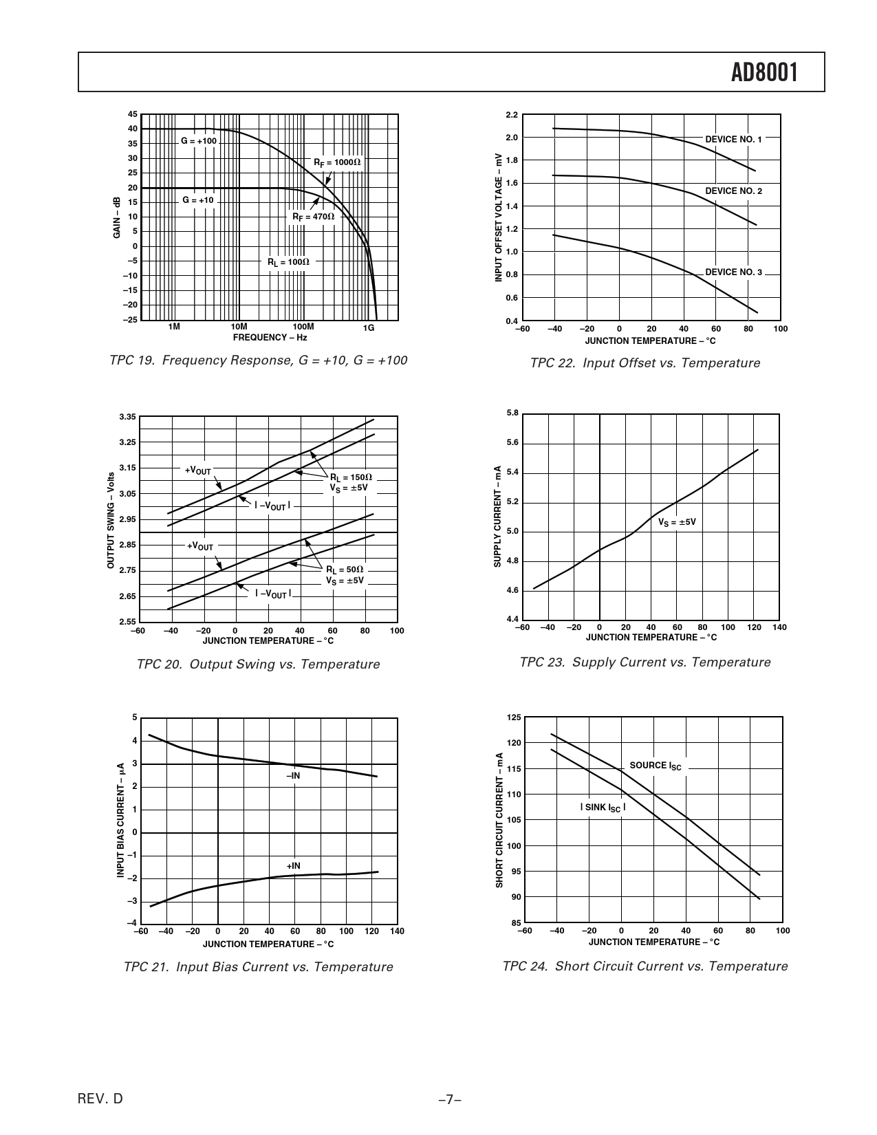

AD8001. 2.2. 2.0. DEVICE NO. 1. G = +100. 1.8. F = 1000. 1.6. DEVICE NO. 2. G = +10. 1.4. RF = 470. 1.2. GAIN – dB. 1.0. RL = 100. –10. 0.8. DEVICE NO. 3
AD8001 2.2 2.0 DEVICE NO 1 G = +100 1.8 F = 1000 1.6 DEVICE NO 2 G = +10 1.4 RF = 470 1.2 GAIN – dB 1.0 RL = 100 –10 0.8 DEVICE NO 3
AD8001
AD8001 45 2.2 40 2.0 DEVICE NO. 1 35 G = +100 30 R 1.8 F = 1000 25 1.6 20 DEVICE NO. 2 15 G = +10 1.4 10 RF = 470 5 1.2 GAIN – dB 0 1.0 –5 RL = 100 –10 0.8 DEVICE NO. 3 INPUT OFFSET VOLTAGE – mV –15 0.6 –20 –25 0.4 1M 10M 100M 1G –60 –40 –20 0 20 40 60 80 100 FREQUENCY – Hz JUNCTION TEMPERATURE – C
TPC 19. Frequency Response, G = +10, G = +100 TPC 22. Input Offset vs. Temperature
3.35 5.8 3.25 5.6 3.15 +VOUT 5.4 RL = 150 V – mA 3.05 S = 5V | 5.2 –VOUT | 2.95 VS = 5V 5.0 2.85 +VOUT 4.8 OUTPUT SWING – Volts SUPPLY CURRENT 2.75 RL = 50 VS = 5V 4.6 2.65 | –VOUT | 2.55 4.4 –60 –40 –20 0 20 40 60 80 100 –60 –40 –20 0 20 40 60 80 100 120 140 JUNCTION TEMPERATURE – C JUNCTION TEMPERATURE – C
TPC 20. Output Swing vs. Temperature TPC 23. Supply Current vs. Temperature
5 125 4 120 A 3 SOURCE I 115 SC –IN – 2 110 1 | SINK ISC | 105 0 100 –1 +IN INPUT BIAS CURRENT 95 –2 SHORT CIRCUIT CURRENT – mA –3 90 –4 85 –60 –40 –20 0 20 40 60 80 100 120 140 –60 –40 –20 0 20 40 60 80 100 JUNCTION TEMPERATURE – C JUNCTION TEMPERATURE – C
TPC 21. Input Bias Current vs. Temperature TPC 24. Short Circuit Current vs. Temperature REV. D –7– Document Outline FEATURES APPLICATIONS GENERAL DESCRIPTION FUNCTIONAL BLOCK DIAGRAMS SPECIFICATIONS ABSOLUTE MAXIMUM RATINGS ORDERING GUIDE MAXIMUM POWER DISSIPATION Typical Performance Characteristics THEORY OF OPERATION Choice of Feedback and Gain Resistors Printed Circuit Board Layout Considerations Power Supply Bypassing DC Errors and Noise Driving Capacitive Loads Communications Operation as a Video Line Driver Driving A-to-D Converters Layout Considerations OUTLINE DIMENSIONS Revision History
