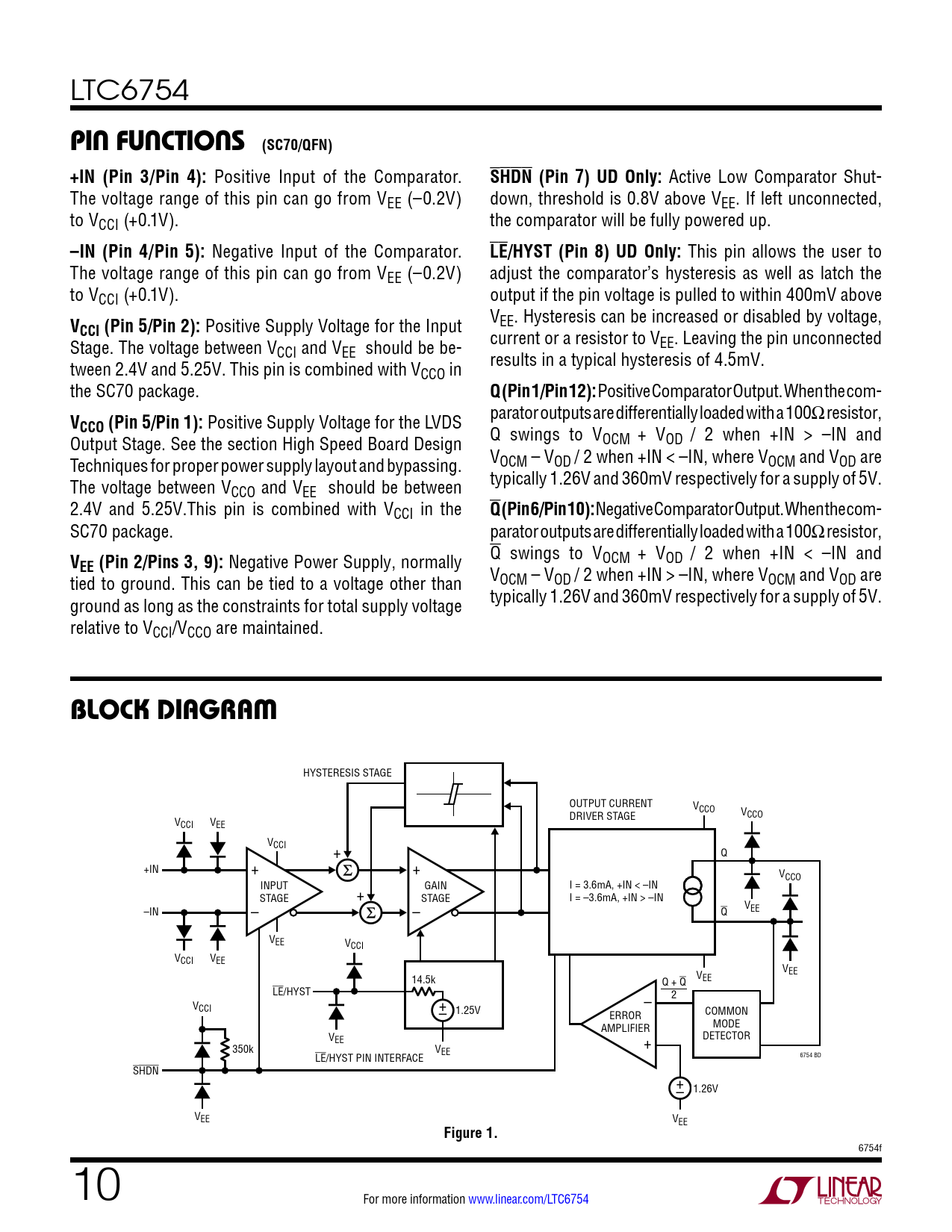

LTC6754
pin FuncTions (SC70/QFN) +IN (Pin 3/Pin 4):
Positive Input of the Comparator.
SHDN (Pin 7) UD Only:
Active Low Comparator Shut- The voltage range of this pin can go from VEE (–0.2V) down, threshold is 0.8V above VEE. If left unconnected, to VCCI (+0.1V). the comparator will be fully powered up.
–IN (Pin 4/Pin 5):
Negative Input of the Comparator.
LE/HYST (Pin 8) UD Only:
This pin allows the user to The voltage range of this pin can go from VEE (–0.2V) adjust the comparator’s hysteresis as well as latch the to VCCI (+0.1V). output if the pin voltage is pulled to within 400mV above
V
VEE. Hysteresis can be increased or disabled by voltage,
CCI (Pin 5/Pin 2):
Positive Supply Voltage for the Input Stage. The voltage between V current or a resistor to VEE. Leaving the pin unconnected CCI and VEE should be be- tween 2.4V and 5.25V. This pin is combined with V results in a typical hysteresis of 4.5mV. CCO in the SC70 package.
Q (Pin 1/Pin 12):
Positive Comparator Output. When the com-
V
parator outputs are differentially loaded with a 100Ω resistor,
CCO (Pin 5/Pin 1):
Positive Supply Voltage for the LVDS Output Stage. See the section High Speed Board Design Q swings to VOCM  +  VOD / 2 when +IN  >  –IN and Techniques for proper power supply layout and bypassing. VOCM – VOD / 2 when +IN < –IN, where VOCM and VOD are The voltage between V typically 1.26V and 360mV respectively for a supply of 5V. CCO and VEE should be between 2.4V and 5.25V.This pin is combined with VCCI in the
Q (Pin 6/Pin 10):
Negative Comparator Output. When the com- SC70 package. parator outputs are differentially loaded with a 100Ω resistor,
V
Q swings to VOCM  +  VOD  /  2 when +IN  <  –IN and
EE (Pin 2/Pins 3, 9):
Negative Power Supply, normally tied to ground. This can be tied to a voltage other than VOCM – VOD / 2 when +IN > –IN, where VOCM and VOD are ground as long as the constraints for total supply voltage typically 1.26V and 360mV respectively for a supply of 5V. relative to VCCI/VCCO are maintained.
block DiagraM
HYSTERESIS STAGE OUTPUT CURRENT VCCO VCCO V DRIVER STAGE CCI VEE VCCI + Q +IN + + VCCO INPUT GAIN I = 3.6mA, +IN < –IN STAGE + STAGE I = –3.6mA, +IN > –IN –IN – – Q VEE VEE VCCI VCCI VEE VEE 14.5k VEE Q + Q LE/HYST – 2 VCCI + 1.25V – COMMON ERROR MODE AMPLIFIER VEE + DETECTOR 350k VEE 6754 BD LE/HYST PIN INTERFACE SHDN +– 1.26V VEE VEE
Figure 1.
