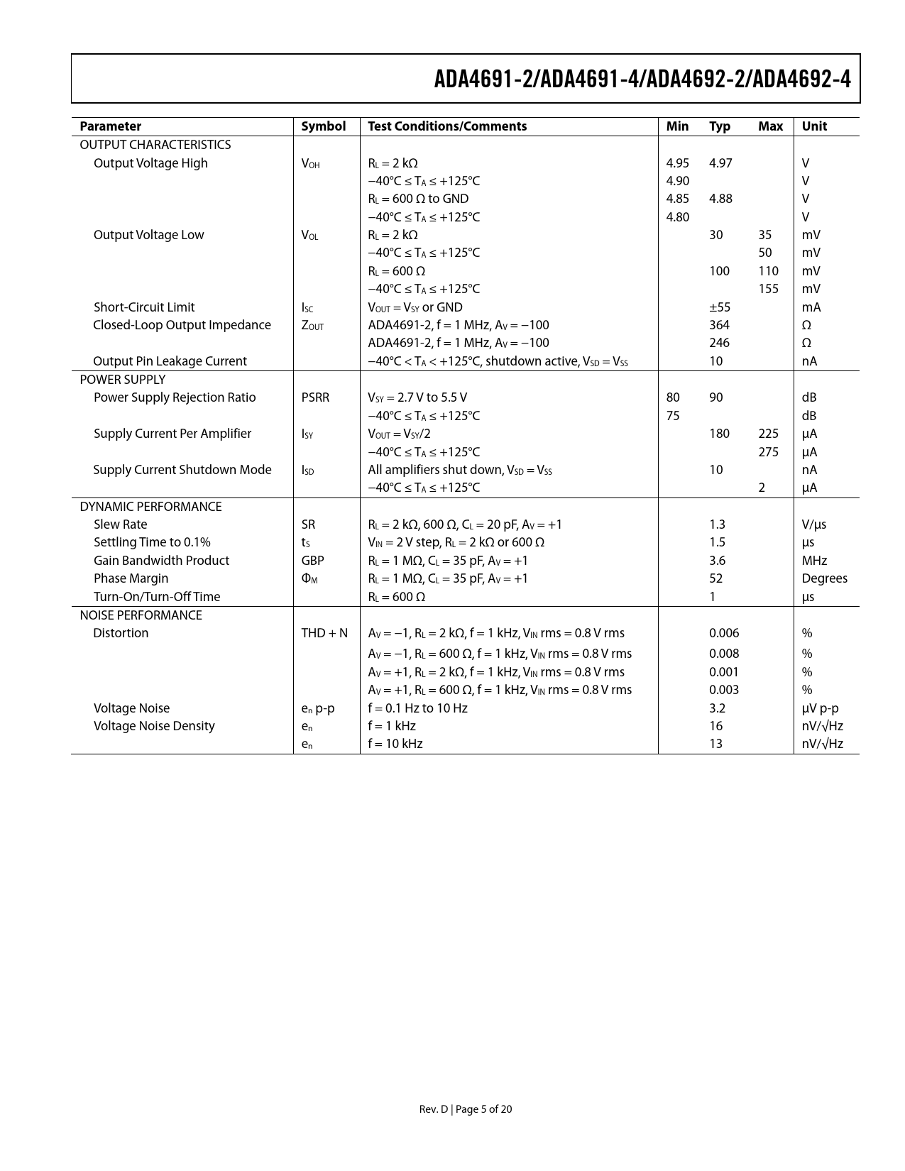

ADA4691-2/ADA4691-4/ADA4692-2/ADA4692-4. Parameter Symbol. Test. Conditions/Comments. Min. Typ. Max. Unit
ADA4691-2/ADA4691-4/ADA4692-2/ADA4692-4 Parameter Symbol Test Conditions/Comments Min Typ Max Unit
OUTPUT CHARACTERISTICS Output Voltage High VOH RL = 2 kΩ 4.95 4.97 V −40°C ≤ TA ≤ +125°C 4.90 V RL = 600 Ω to GND 4.85 4.88 V −40°C ≤ TA ≤ +125°C 4.80 V Output Voltage Low VOL RL = 2 kΩ 30 35 mV −40°C ≤ TA ≤ +125°C 50 mV RL = 600 Ω 100 110 mV −40°C ≤ TA ≤ +125°C 155 mV Short-Circuit Limit ISC VOUT = VSY or GND ±55 mA Closed-Loop Output Impedance ZOUT ADA4691-2, f = 1 MHz, AV = −100 364 Ω ADA4691-2, f = 1 MHz, AV = −100 246 Ω Output Pin Leakage Current −40°C < TA < +125°C, shutdown active, VSD = VSS 10 nA POWER SUPPLY Power Supply Rejection Ratio PSRR VSY = 2.7 V to 5.5 V 80 90 dB −40°C ≤ TA ≤ +125°C 75 dB Supply Current Per Amplifier ISY VOUT = VSY/2 180 225 μA −40°C ≤ TA ≤ +125°C 275 μA Supply Current Shutdown Mode ISD All amplifiers shut down, VSD = VSS 10 nA −40°C ≤ TA ≤ +125°C 2 μA DYNAMIC PERFORMANCE Slew Rate SR RL = 2 kΩ, 600 Ω, CL = 20 pF, AV = +1 1.3 V/μs Settling Time to 0.1% tS VIN = 2 V step, RL = 2 kΩ or 600 Ω 1.5 μs Gain Bandwidth Product GBP RL = 1 MΩ, CL = 35 pF, AV = +1 3.6 MHz Phase Margin ΦM RL = 1 MΩ, CL = 35 pF, AV = +1 52 Degrees Turn-On/Turn-Off Time RL = 600 Ω 1 μs NOISE PERFORMANCE Distortion THD + N AV = −1, RL = 2 kΩ, f = 1 kHz, VIN rms = 0.8 V rms 0.006 % AV = −1, RL = 600 Ω, f = 1 kHz, VIN rms = 0.8 V rms 0.008 % AV = +1, RL = 2 kΩ, f = 1 kHz, VIN rms = 0.8 V rms 0.001 % AV = +1, RL = 600 Ω, f = 1 kHz, VIN rms = 0.8 V rms 0.003 % Voltage Noise en p-p f = 0.1 Hz to 10 Hz 3.2 μV p-p Voltage Noise Density en f = 1 kHz 16 nV/√Hz en f = 10 kHz 13 nV/√Hz Rev. D | Page 5 of 20 Document Outline FEATURES APPLICATIONS GENERAL DESCRIPTION TABLE OF CONTENTS REVISION HISTORY SPECIFICATIONS ELECTRICAL CHARACTERISTICS—2.7 V OPERATION ELECTRICAL CHARACTERISTICS—5 V OPERATION ABSOLUTE MAXIMUM RATINGS THERMAL RESISTANCE ESD CAUTION PIN CONFIGURATIONS TYPICAL PERFORMANCE CHARACTERISTICS SHUTDOWN OPERATION INPUT PIN CHARACTERISTICS INPUT THRESHOLD OUTLINE DIMENSIONS ORDERING GUIDE
