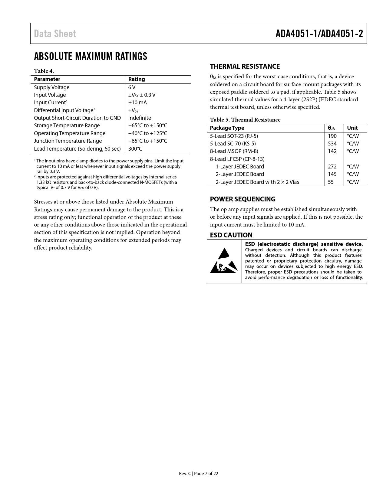

Data Sheet. ADA4051-1/ADA4051-2. ABSOLUTE MAXIMUM RATINGS. THERMAL RESISTANCE. Table 4. Parameter. Rating
Data Sheet ADA4051-1/ADA4051-2 ABSOLUTE MAXIMUM RATINGS THERMAL RESISTANCE Table 4 Parameter Rating
link to page 7
Data Sheet ADA4051-1/ADA4051-2 ABSOLUTE MAXIMUM RATINGS THERMAL RESISTANCE Table 4. Parameter Rating
θJA is specified for the worst-case conditions, that is, a device Supply Voltage 6 V soldered on a circuit board for surface-mount packages with its Input Voltage ±V exposed paddle soldered to a pad, if applicable. Table 5 shows SY ± 0.3 V Input Current1 ±10 mA simulated thermal values for a 4-layer (2S2P) JEDEC standard Differential Input Voltage2 ±V thermal test board, unless otherwise specified. SY Output Short-Circuit Duration to GND Indefinite
Table 5. Thermal Resistance
Storage Temperature Range −65°C to +150°C
Package Type θJA Unit
Operating Temperature Range −40°C to +125°C 5-Lead SOT-23 (RJ-5) 190 °C/W Junction Temperature Range −65°C to +150°C 5-Lead SC-70 (KS-5) 534 °C/W Lead Temperature (Soldering, 60 sec) 300°C 8-Lead MSOP (RM-8) 142 °C/W 1 The input pins have clamp diodes to the power supply pins. Limit the input 8-Lead LFCSP (CP-8-13) current to 10 mA or less whenever input signals exceed the power supply 1-Layer JEDEC Board 272 °C/W rail by 0.3 V. 2-Layer JEDEC Board 145 °C/W 2 Inputs are protected against high differential voltages by internal series 1.33 kΩ resistors and back-to-back diode-connected N-MOSFETs (with a 2-Layer JEDEC Board with 2 × 2 Vias 55 °C/W typical VT of 0.7 V for VCM of 0 V). Stresses at or above those listed under Absolute Maximum
POWER SEQUENCING
Ratings may cause permanent damage to the product. This is a The op amp supplies must be established simultaneously with stress rating only; functional operation of the product at these or before any input signals are applied. If this is not possible, the or any other conditions above those indicated in the operational input current must be limited to 10 mA. section of this specification is not implied. Operation beyond
