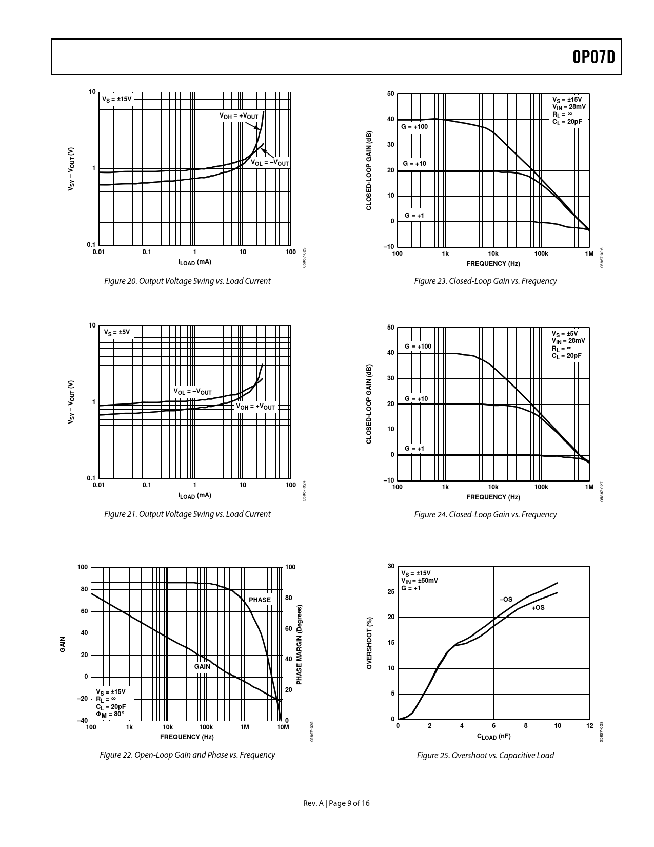

Pages / Page17 / 10 — OP07D. VS = ±15V. VS = ±15V VIN = 28mV. OH = +VOUT. L = ∞. CL = 20pF. G = …
RevisionA
File Format / SizePDF / 242 Kb
OP07D. VS = ±15V. VS = ±15V VIN = 28mV. OH = +VOUT. L = ∞. CL = 20pF. G = +100. ) dB (. (V). OL = –VOUT. G = +10. – V. -LOOP. SYV. D E. LOS C. G = +1
OP07D VS = ±15V VS = ±15V VIN = 28mV OH = +VOUT L = ∞ CL = 20pF G = +100 ) dB ( (V) OL = –VOUT G = +10 – V -LOOP SYV D E LOS C G = +1
OP07D 10 50 VS = ±15V VS = ±15V VIN = 28mV V R OH = +VOUT L = ∞ 40 CL = 20pF G = +100 ) dB ( 30 IN (V) UT V GA OL = –VOUT G = +10 O 1 20 – V -LOOP SYV D E 10 LOS C G = +1 0 0.1 –10 0.01 0.1 1 10 100
023
100 1k 10k 100k 1M
026
ILOAD (mA) FREQUENCY (Hz)
05867- 05867- Figure 20. Output Voltage Swing vs. Load Current Figure 23. Closed-Loop Gain vs. Frequency
10 50 VS = ±5V VS = ±5V VIN = 28mV G = +100 R 40 L = ∞ CL = 20pF ) dB ( 30 IN (V) V UT OL = –VOUT GA O G = +10 1 V 20 – V OH = +VOUT -LOOP SYV D E 10 LOS C G = +1 0 0.1 –10 0.01 0.1 1 10 100
024
100 1k 10k 100k 1M
027
05867- 05867- Figure 21. Output Voltage Swing vs. Load Current Figure 24. Closed-Loop Gain vs. Frequency
100 100 30 VS = ±15V VIN = ±50mV 80 G = +1 25 80 PHASE –OS +OS 60 rees) ) 20 60 (% Deg 40 T O IN IN ( O 15 GA SH 20 ARG 40 M VER E GAIN O 10 0 HAS P 20 VS = ±15V 5 –20 RL = ∞ CL = 20pF ΦM = 80° –40 0 0 100 1k 10k 100k 1M 10M
025
0 2 4 6 8 10 12
028
FREQUENCY (Hz) CLOAD (nF)
