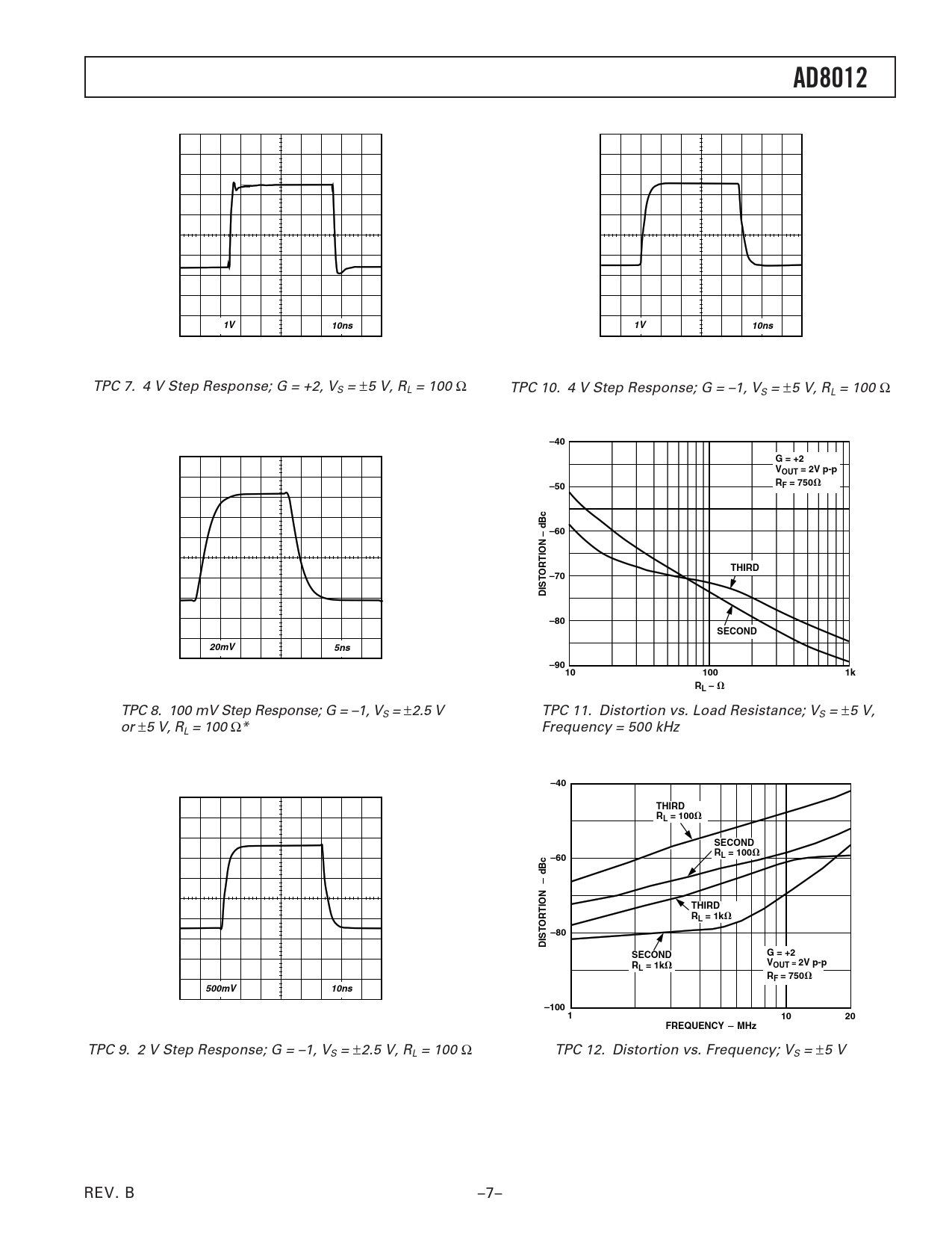

AD8012. 10ns. –40. G = +2 VOUT = 2V p-p. –50. RF = 750. –60. THIRD. –70. DISTORTION – dBc. –80. SECOND. 20mV. 5ns. –9010. 100. RL –. THIRD RL = 100
AD8012 10ns –40 G = +2 VOUT = 2V p-p –50 RF = 750 –60 THIRD –70 DISTORTION – dBc –80 SECOND 20mV 5ns –9010 100 RL – THIRD RL = 100
AD8012 1V 10ns 1V 10ns
TPC 7. 4 V Step Response; G = +2, VS = ±5 V, RL = 100 Ω TPC 10. 4 V Step Response; G = –1, VS = ±5 V, RL = 100 Ω
–40 G = +2 VOUT = 2V p-p –50 RF = 750 –60 THIRD –70 DISTORTION – dBc –80 SECOND 20mV 5ns –9010 100 1k RL –
TPC 8. 100 mV Step Response; G = –1, VS = ±2.5 V TPC 11. Distortion vs. Load Resistance; VS = ±5 V, or ±5 V, RL = 100 Ω* Frequency = 500 kHz
–40 THIRD RL = 100 SECOND RL = 100 –60 dBc THIRD RL = 1k –80 DISTORTION SECOND G = +2 R V L = 1k OUT = 2V p-p RF = 750 500mV 10ns –100 1 10 20 FREQUENCY MHz
TPC 9. 2 V Step Response; G = –1, VS = ±2.5 V, RL = 100 Ω TPC 12. Distortion vs. Frequency; VS = ±5 V REV. B –7– Document Outline FEATURES APPLICATIONS PRODUCT DESCRIPTION FUNCTIONAL BLOCK DIAGRAM SPECIFICATIONS DUAL SUPPLY SINGLE SUPPLY MAXIMUM POWER DISSIPATION Test Circuits ABSOLUTE MAXIMUM RATINGS ORDERING GUIDE Typical Performance Characteristics THEORY OF OPERATION DC GAIN CHARACTERISTICS APPLICATIONS Line Driving for HDSL Choosing the Appropriate Turns Ratio for the Transformer LAYOUT CONSIDERATIONS OUTLINE DIMENSIONS Revision History
