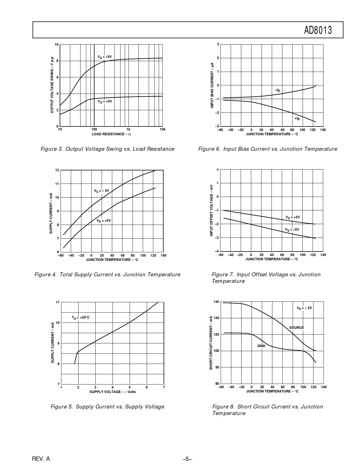

AD8013. VS =. –IB. VS = +5V. INPUT BIAS CURRENT – µA. OUTPUT VOLTAGE SWING – V p-p. +IB. 100. 10k. –60. –40. –20. 120. 140. LOAD RESISTANCE –
AD8013 VS = –IB VS = +5V INPUT BIAS CURRENT – µA OUTPUT VOLTAGE SWING – V p-p +IB 100 10k –60 –40 –20 120 140 LOAD RESISTANCE –
AD8013 10 3 VS =
5V 2 8 1 6 0 –IB 4 –1 VS = +5V INPUT BIAS CURRENT – µA 2 OUTPUT VOLTAGE SWING – V p-p –2 +IB 0 –3 10 100 1k 10k –60 –40 –20 0 20 40 60 80 100 120 140 LOAD RESISTANCE –
JUNCTION TEMPERATURE –
C
Figure 3. Output Voltage Swing vs. Load Resistance Figure 6. Input Bias Current vs. Junction Temperature
12 2 11 1 VS =
5V 10 0 9 –1 VS = +5V VS = +5V 8 –2 VS =
5V SUPPLY CURRENT – mA INPUT OFFSET VOLTAGE – mV 7 –3 6 –4 –60 –40 –20 0 20 40 60 80 100 120 140 –60 –40 –20 0 20 40 60 80 100 120 140 JUNCTION TEMPERATURE –
C JUNCTION TEMPERATURE –
C
Figure 4. Total Supply Current vs. Junction Temperature Figure 7. Input Offset Voltage vs. Junction Temperature
11 140 VS =
5V TA = +25
C 130 10 SOURCE 120 9 SINK 100 SUPPLY CURRENT – mA 8 SHORT CIRCUIT CURRENT – mA 90 7 80 1 2 3 4 5 6 7 –60 –40 –20 0 20 40 60 80 100 120 140 SUPPLY VOLTAGE –
Volts JUNCTION TEMPERATURE –
C
Figure 5. Supply Current vs. Supply Voltage Figure 8. Short Circuit Current vs. Junction Temperature REV. A –5–
