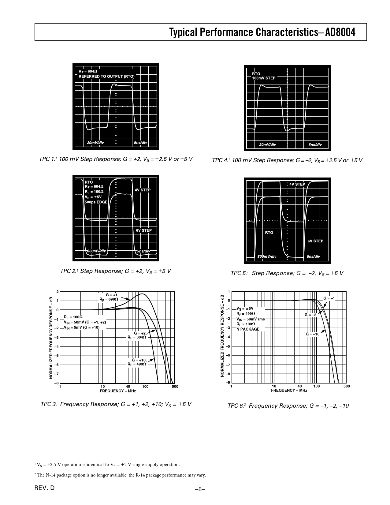

Typical Performance Characteristics– AD8004. G = +1,. G = –1. RF = 698. VS =. RF = 499. G = –2. RL = 100. VIN = 50mV rms
Typical Performance Characteristics– AD8004 G = +1, G = –1 RF = 698 VS = RF = 499 G = –2 RL = 100 VIN = 50mV rms
TPC 1.1 100 mV Step Response; G = +2, VS = ±2.5 V or ±5 V TPC 4.1 100 mV Step Response; G = –2, VS = ±2.5 V or ±5 V TPC 2.1 Step Response; G = +2, VS = ±5 V TPC 5.1 Step Response; G = –2, VS = ±5 V
2 1 G = +1, G = –1 1 RF = 698 0 –1 VS = 5V 0 RF = 499 G = –2 RL = 100 –2 –1 VIN = 50mV rms VIN = 50mV (G = +1, +2) RL = 100 –2 VIN = 5mV (G = +10) –3 N PACKAGE G = +2, G = –10 –3 R –4 F = 604 –4 –5 –5 –6 G = +10, –6 RF = 499 –7 –7 –8 NORMALIZED FREQUENCY RESPONSE – dB NORMALIZED FREQUENCY RESPONSE – dB –8 –9 1 10 40 100 500 1 10 40 100 500 FREQUENCY – MHz FREQUENCY – MHz
TPC 3. Frequency Response; G = +1, +2, +10; VS = ±5 V TPC 6.2 Frequency Response; G = –1, –2, –10 1 VS = ±2.5 V operation is identical to VS = +5 V single-supply operation. 2 The N-14 package option is no longer available; the R-14 package performance may vary. REV. D –5– Document Outline FEATURES APPLICATIONS GENERAL DESCRIPTION CONNECTION DIAGRAM SPECIFICATIONS ABSOLUTE MAXIMUM RATINGS ORDERING GUIDE MAXIMUM POWER DISSIPATION Typical Performance Characteristics THEORY OF OPERATION DC AND AC CHARACTERISTICS DRIVING CAPACITIVE LOADS OPTIMIZING FLATNESS DRIVING A SINGLE-SUPPLY A/D CONVERTER LAYOUT CONSIDERATIONS OUTLINE DIMENSIONS Revision History
