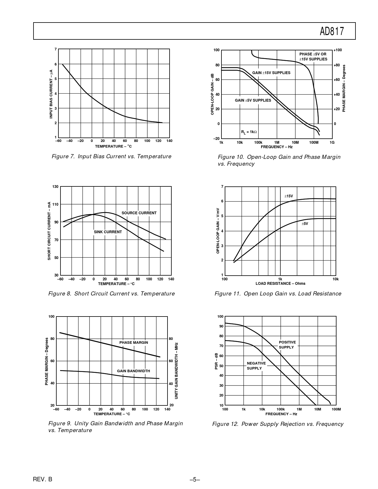

AD817. 100. +100. PHASE. 5V OR. 15V SUPPLIES. +80. GAIN. +60. +40. 5V SUPPLIES. +20. PHASE MARGIN – Degrees. OPEN-LOOP GAIN – dB
AD817 100 +100 PHASE 5V OR 15V SUPPLIES +80 GAIN +60 +40 5V SUPPLIES +20 PHASE MARGIN – Degrees OPEN-LOOP GAIN – dB
AD817 7 100 +100 PHASE
5V OR
15V SUPPLIES 6 80 +80
µ
A GAIN
15V SUPPLIES 5 60 +60 4 40 +40 GAIN
5V SUPPLIES 3 20 +20 PHASE MARGIN – Degrees OPEN-LOOP GAIN – dB INPUT BIAS CURRENT – 2 0 0 R = 1k
L 1 –20 –60 –40 –20 0 20 40 60 80 100 120 140 1k 10k 100k 1M 10M 100M 1G TEMPERATURE –
C FREQUENCY – Hz
Figure 7. Input Bias Current vs. Temperature Figure 10. Open-Loop Gain and Phase Margin vs. Frequency
130 7
15V 6 110 SOURCE CURRENT 5 90
5V SINK CURRENT 4 70 3 OPEN-LOOP GAIN – V/mV 50 SHORT CIRCUIT CURRENT – mA 2 30 1 –60 –40 –20 0 20 40 60 80 100 120 140 100 1k 10k TEMPERATURE –
C LOAD RESISTANCE – Ohms
Figure 8. Short Circuit Current vs. Temperature Figure 11. Open Loop Gain vs. Load Resistance
100 100 90 80 80 80 PHASE MARGIN POSITIVE 70 SUPPLY 60 60 60 NEGATIVE 50 PSR – dB SUPPLY GAIN BANDWIDTH 40 40 PHASE MARGIN – Degrees 40 30 20 UNITY GAIN BANDWIDTH – MHz 20 20 10 –60 –40 –20 0 20 40 60 80 100 120 140 100 1k 10k 100k 1M 10M 100M TEMPERATURE –
C FREQUENCY – Hz
Figure 9. Unity Gain Bandwidth and Phase Margin Figure 12. Power Supply Rejection vs. Frequency vs. Temperature REV. B –5–
