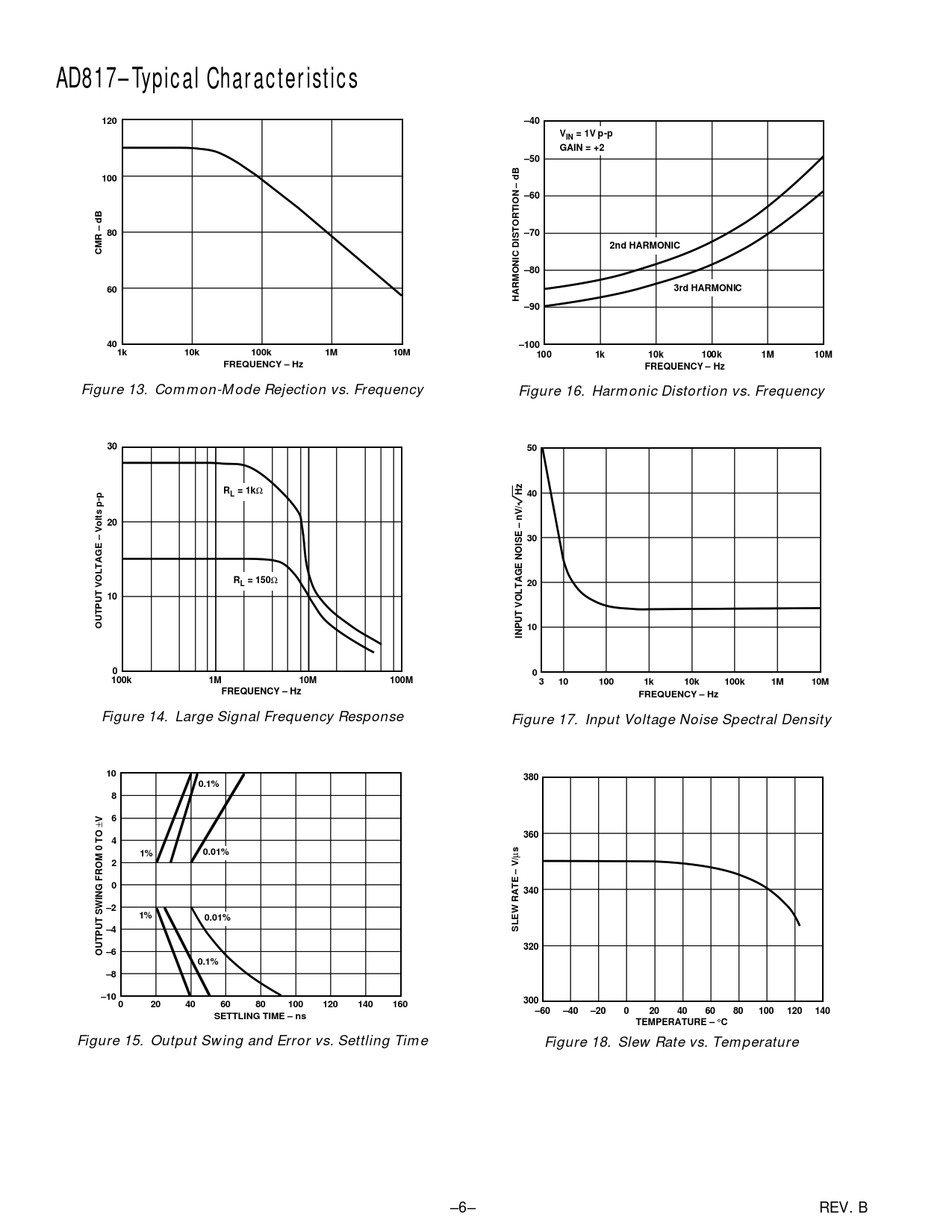

Pages / Page14 / 8 — AD817–Typical Characteristics. 120. –40. V = 1V p-p. GAIN = +2. –50. 100. …

AD817–Typical Characteristics. 120. –40. V = 1V p-p. GAIN = +2. –50. 100. d – N –60. IO T R O. T –70. 2nd HARMONIC. CMR – dB. IC DIS N O –80
AD817–Typical Characteristics 120 –40 V = 1V p-p GAIN = +2 –50 100 d – N –60 IO T R O T –70 2nd HARMONIC CMR – dB IC DIS N O –80
AD817–Typical Characteristics 120 –40 V = 1V p-p IN GAIN = +2 –50 B 100 d – N –60 IO T R O 80 T –70 2nd HARMONIC CMR – dB IC DIS N O –80 60 3rd HARMONIC HARM –90 40 –100 1k 10k 100k 1M 10M 100 1k 10k 100k 1M 10M FREQUENCY – Hz FREQUENCY – Hz
Figure 13. Common-Mode Rejection vs. Frequency Figure 16. Harmonic Distortion vs. Frequency
30 50 R = 1k
L 40 20 30 R = 150
L 20 10 OUTPUT VOLTAGE – Volts p-p 10 INPUT VOLTAGE NOISE – nV/ Hz 0 0 100k 1M 10M 100M 3 10 100 1k 10k 100k 1M 10M FREQUENCY – Hz FREQUENCY – Hz
Figure 14. Large Signal Frequency Response Figure 17. Input Voltage Noise Spectral Density
10 380 0.1% 8 6
V 360 4 1% 0.01%
µ
s 2 0 340 –2 1% 0.01% –4 SLEW RATE – V/ 320 OUTPUT SWING FROM 0 TO –6 0.1% –8 –10 0 20 40 60 80 100 120 140 160 300 –60 –40 –20 0 20 40 60 80 100 120 140 SETTLING TIME – ns TEMPERATURE –
C
Figure 15. Output Swing and Error vs. Settling Time Figure 18. Slew Rate vs. Temperature –6– REV. B
