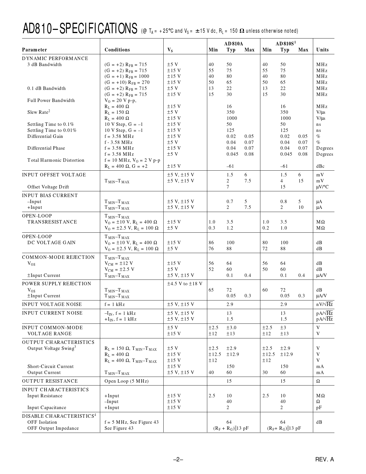

AD810–SPECIFICATIONS (@ TA = +25. C and VS =. 15 V dc, RL = 150. unless otherwise noted). AD810A. AD810S1. Parameter. Conditions. Min
AD810–SPECIFICATIONS (@ TA = +25 C and VS = 15 V dc, RL = 150 unless otherwise noted) AD810A AD810S1 Parameter Conditions Min
AD810
8
C and VS =
6
15 V dc, RL = 150
V
unless otherwise noted) AD810A AD810S1 Parameter Conditions VS Min Typ Max Min Typ Max Units
DYNAMIC PERFORMANCE 3 dB Bandwidth (G = +2) RFB = 715 ±5 V 40 50 40 50 MHz (G = +2) RFB = 715 ± 15 V 55 75 55 75 MHz (G = +1) RFB = 1000 ± 15 V 40 80 40 80 MHz (G = +10) RFB = 270 ± 15 V 50 65 50 65 MHz 0.1 dB Bandwidth (G = +2) RFB = 715 ±5 V 13 22 13 22 MHz (G = +2) RFB = 715 ± 15 V 15 30 15 30 MHz Full Power Bandwidth VO = 20 V p-p, RL = 400 Ω ±15 V 16 16 MHz Slew Rate2 RL = 150 Ω ±5 V 350 350 V/µs RL = 400 Ω ±15 V 1000 1000 V/µs Settling Time to 0.1% 10 V Step, G = –1 ±15 V 50 50 ns Settling Time to 0.01% 10 V Step, G = –1 ±15 V 125 125 ns Differential Gain f = 3.58 MHz ±15 V 0.02 0.05 0.02 0.05 % f - 3.58 MHz ±5 V 0.04 0.07 0.04 0.07 % Differential Phase f = 3.58 MHz ±15 V 0.04 0.07 0.04 0.07 Degrees f = 3.58 MHz ±5 V 0.045 0.08 0.045 0.08 Degrees Total Harmonic Distortion f = 10 MHz, VO = 2 V p-p RL = 400 Ω, G = +2 ±15 V –61 –61 dBc INPUT OFFSET VOLTAGE ±5 V, ±15 V 1.5 6 1.5 6 mV T ± MIN–TMAX 5 V, ± 15 V 2 7.5 4 15 mV Offset Voltage Drift 7 15 µV/°C INPUT BIAS CURRENT –Input T ± MIN–TMAX 5 V, ± 15 V 0.7 5 0.8 5 µA +Input T ± MIN–TMAX 5 V, ± 15 V 2 7.5 2 10 µA OPEN-LOOP TMIN–TMAX TRANSRESISTANCE VO = ± 10 V, RL = 400 Ω ±15 V 1.0 3.5 1.0 3.5 MΩ VO = ± 2.5 V, RL = 100 Ω ±5 V 0.3 1.2 0.2 1.0 MΩ OPEN-LOOP TMIN–TMAX DC VOLTAGE GAIN VO = ± 10 V, RL = 400 Ω ±15 V 86 100 80 100 dB VO = ± 2.5 V, RL = 100 Ω ±5 V 76 88 72 88 dB COMMON-MODE REJECTION TMIN–TMAX VOS VCM = ± 12 V ± 15 V 56 64 56 64 dB VCM = ± 2.5 V ±5 V 52 60 50 60 dB ±Input Current T ± MIN–TMAX 5 V, ± 15 V 0.1 0.4 0.1 0.4 µA/V POWER SUPPLY REJECTION ±4.5 V to ±18 V VOS TMIN–TMAX 65 72 60 72 dB ±Input Current TMIN–TMAX 0.05 0.3 0.05 0.3 µA/V INPUT VOLTAGE NOISE f = 1 kHz ±5 V, ±15 V 2.9 2.9 nV/√Hz INPUT CURRENT NOISE –IIN, f = 1 kHz ±5 V, ±15 V 13 13 pA/√Hz +IIN, f = 1 kHz ±5 V, ±15 V 1.5 1.5 pA/√Hz INPUT COMMON-MODE ±5 V ±2.5 ±3.0 ±2.5 ±3 V VOLTAGE RANGE ±15 V ±12 ±13 ±12 ±13 V OUTPUT CHARACTERISTICS Output Voltage Swing3 R ± L = 150 Ω, TMIN–TMAX 5 V ±2.5 ±2.9 ±2.5 ±2.9 V RL = 400 Ω ±15 V ±12.5 ±12.9 ±12.5 ±12.9 V R ± L = 400 Ω, TMIN–TMAX 15 V ±12 ±12 V Short-Circuit Current ±15 V 150 150 mA Output Current T ± MIN–TMAX 5 V, ± 15 V 40 60 30 60 mA OUTPUT RESISTANCE Open Loop (5 MHz) 15 15 Ω INPUT CHARACTERISTICS Input Resistance +Input ±15 V 2.5 10 2.5 10 MΩ –Input ±15 V 40 40 Ω Input Capacitance +Input ±15 V 2 2 pF DISABLE CHARACTERISTICS4 OFF Isolation f = 5 MHz, See Figure 43 64 64 dB OFF Output Impedance See Figure 43 (RF + RG)i13 pF (RF+ RG)i13 pF –2– REV. A
