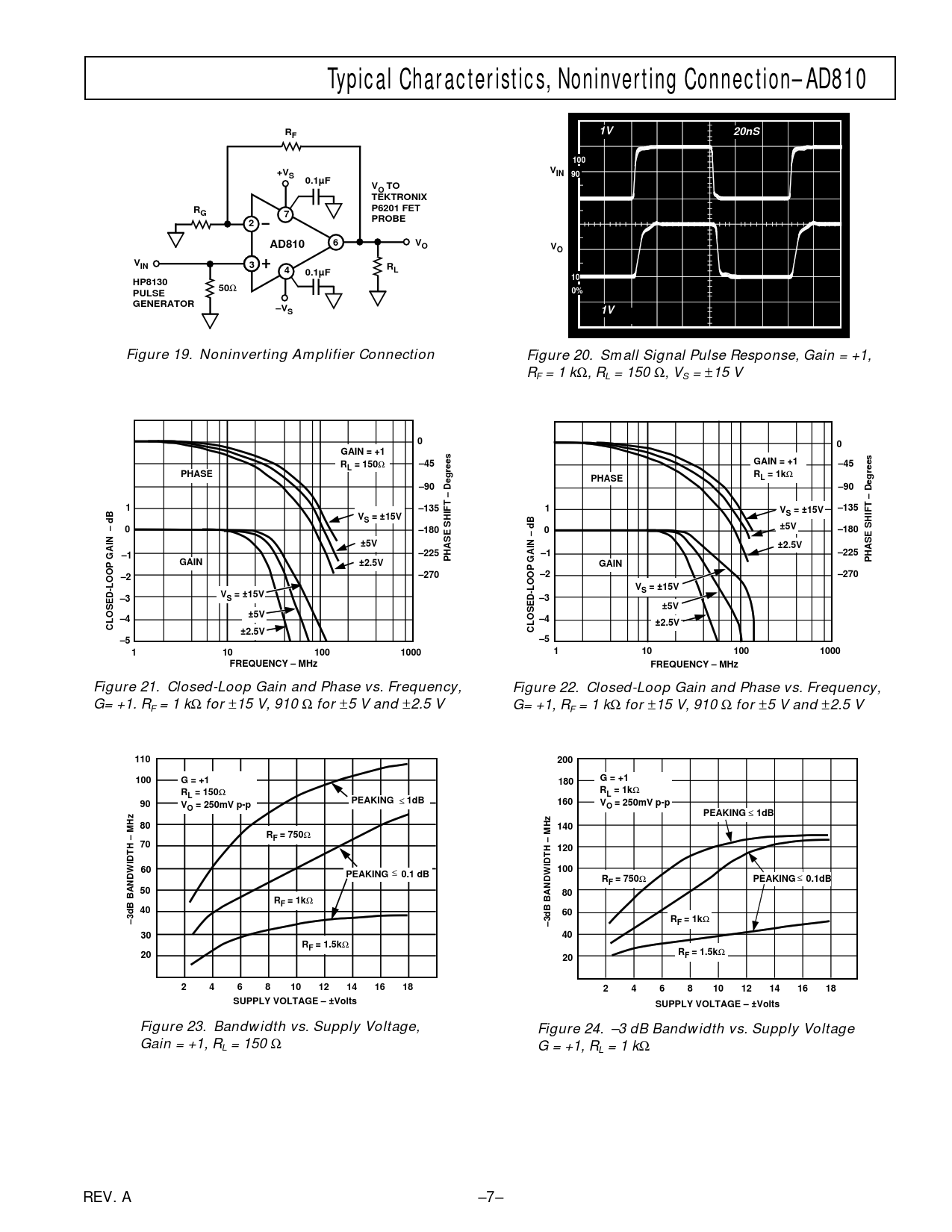

Typical Characteristics, Noninverting Connection–AD810. 20nS. 100. 0.1µF. VO TO. TEKTRONIX. P6201 FET. PROBE. AD810. VIN. HP8130
Typical Characteristics, Noninverting Connection–AD810 20nS 100 0.1µF VO TO TEKTRONIX P6201 FET PROBE AD810 VIN HP8130
AD810
Typical Characteristics, Noninverting Connection–AD810 R 1V 20nS F 100 V +V IN 90 S 0.1µF VO TO TEKTRONIX R P6201 FET G 7 PROBE 2 AD810 6 VO VO VIN 3 4 R 0.1µF L 10 HP8130 50
0% PULSE GENERATOR –VS 1V
Figure 19. Noninverting Amplifier Connection Figure 20. Small Signal Pulse Response, Gain = +1, RF = 1 kΩ, RL = 150 Ω, VS = ±15 V
0 0 GAIN = +1 –45 GAIN = +1 R –45 L = 150
PHASE RL = 1k
PHASE –90 –90 1 –135 1 –135 VS = ±15V VS = ±15V 0 –180 0 ±5V –180 ±5V ±2.5V –225 –1 –225 –1 PHASE SHIFT – Degrees PHASE SHIFT – Degrees GAIN ±2.5V GAIN –270 –2 –270 –2 VS = ±15V –3 VS = ±15V –3 ±5V ±5V –4 –4 ±2.5V CLOSED-LOOP GAIN – dB CLOSED-LOOP GAIN – dB ±2.5V –5 –5 1 10 100 1000 10 100 1 1000 FREQUENCY – MHz FREQUENCY – MHz
Figure 21. Closed-Loop Gain and Phase vs. Frequency, Figure 22. Closed-Loop Gain and Phase vs. Frequency, G= +1. RF = 1 kΩ for ±15 V, 910 Ω for ±5 V and ±2.5 V G= +1, RF = 1 kΩ for ±15 V, 910 Ω for ±5 V and ±2.5 V
110 200 100 G = +1 180 G = +1 R RL = 1k
L = 150
Ω ≤
160 90 V V O = 250mV p-p O = 250mV p-p PEAKING 1dB PEAKING 1dB
80 140 RF = 750
70 120 60 100 PEAKING 0.1 dB
R PEAKING 0.1dB
F = 750
50 80 RF = 1k
40 60 –3dB BANDWIDTH – MHz R –3dB BANDWIDTH – MHz F = 1k
30 40 RF = 1.5k
R 20 20 F = 1.5k
2 4 6 8 10 12 14 16 18 2 4 6 8 10 12 14 16 18 SUPPLY VOLTAGE – ±Volts SUPPLY VOLTAGE – ±Volts
Figure 23. Bandwidth vs. Supply Voltage, Figure 24. –3 dB Bandwidth vs. Supply Voltage Gain = +1, RL = 150 Ω G = +1, RL = 1 kΩ REV. A –7–
