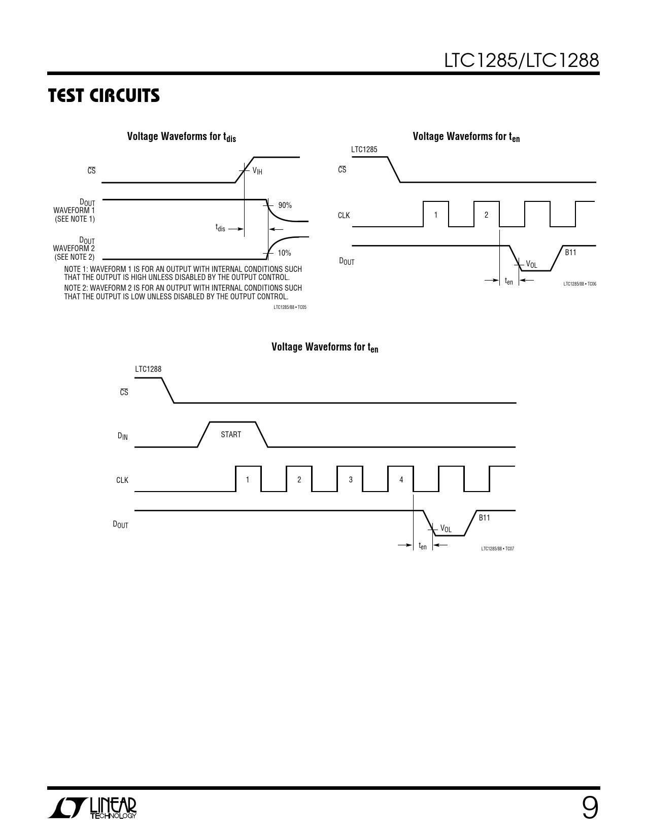

TEST CIRCUITS. Voltage Waveforms for tdis. Voltage Waveforms for ten
TEST CIRCUITS Voltage Waveforms for tdis Voltage Waveforms for ten
LTC1285/LTC1288
LTC1285 CS VIH CS DOUT 90% WAVEFORM 1 CLK 1 2 (SEE NOTE 1) tdis DOUT WAVEFORM 2 10% B11 (SEE NOTE 2) DOUT V NOTE 1: WAVEFORM 1 IS FOR AN OUTPUT WITH INTERNAL CONDITIONS SUCH OL THAT THE OUTPUT IS HIGH UNLESS DISABLED BY THE OUTPUT CONTROL. ten LTC1285/88 • TC06 NOTE 2: WAVEFORM 2 IS FOR AN OUTPUT WITH INTERNAL CONDITIONS SUCH THAT THE OUTPUT IS LOW UNLESS DISABLED BY THE OUTPUT CONTROL. LTC1285/88 • TC05
LTC1288 CS DIN START CLK 1 2 3 4 B11 DOUT VOL ten LTC1285/88 • TC07 9
