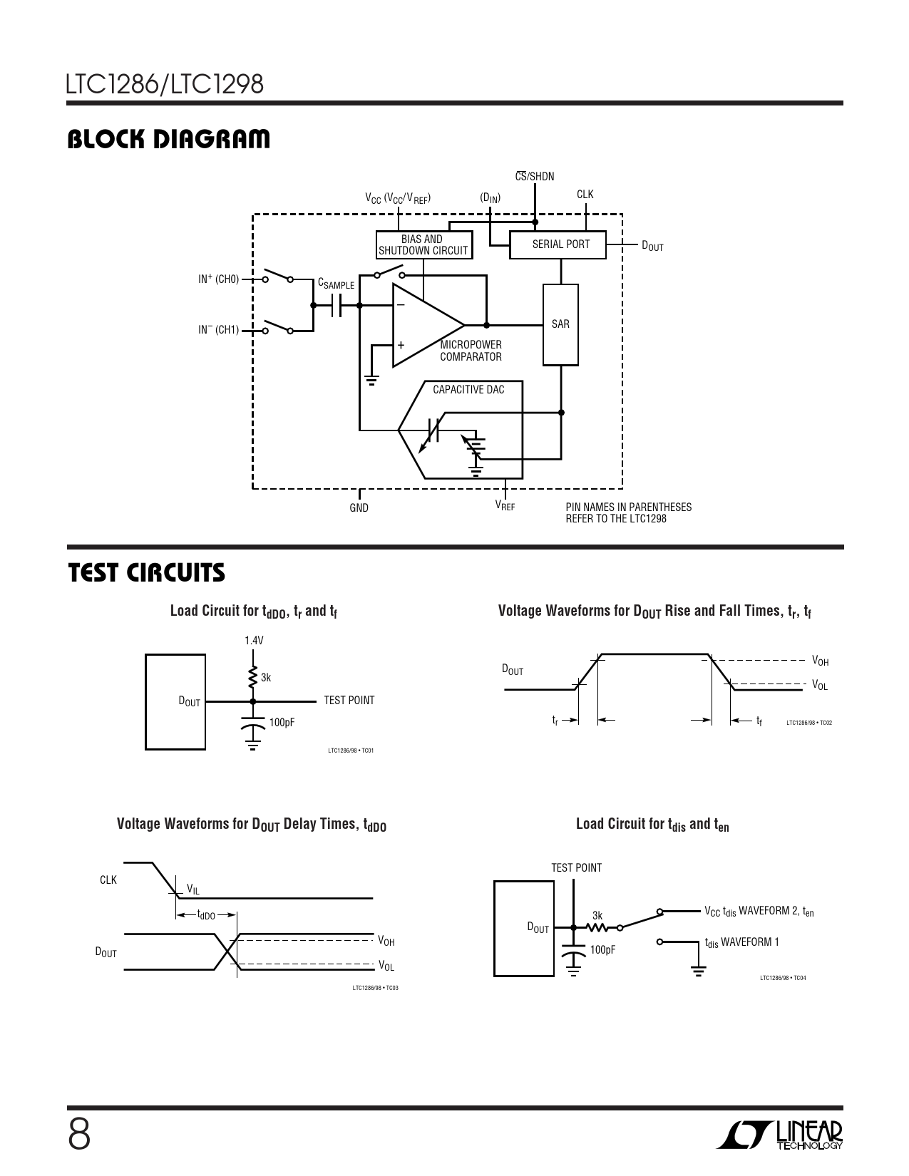

LTC1286/LTC1298
W BLOCK DIAGRAM
CS/SHDN V CLK CC (VCC/ V REF) (DIN) BIAS AND SERIAL PORT DOUT SHUTDOWN CIRCUIT IN+ (CH0) CSAMPLE – SAR IN– (CH1) + MICROPOWER COMPARATOR CAPACITIVE DAC V GND REF PIN NAMES IN PARENTHESES REFER TO THE LTC1298
TEST CIRCUITS Load Circuit for t Voltage Waveforms for D dDO, tr and tf OUT Rise and Fall Times, tr, tf
1.4V VOH DOUT 3k VOL DOUT TEST POINT 100pF tr tf LTC1286/98 • TC02 LTC1286/98 • TC01
Voltage Waveforms for D Load Circuit for t OUT Delay Times, tdDO dis and ten
TEST POINT CLK VIL t V dDO 3k CC tdis WAVEFORM 2, ten DOUT VOH tdis WAVEFORM 1 DOUT 100pF VOL LTC1286/98 • TC04 LTC1286/98 • TC03 8
