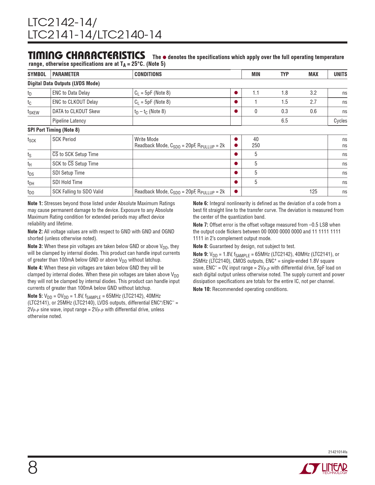

TIMING CHARACTERISTICS. The. denotes the specifications which apply over the full operating temperature
TIMING CHARACTERISTICS The denotes the specifications which apply over the full operating temperature
LTC2142-14/ LTC2141-14/LTC2140-14
l
denotes the specifications which apply over the full operating temperature range, otherwise specifications are at TA = 25°C. (Note 5) SYMBOL PARAMETER CONDITIONS MIN TYP MAX UNITS Digital Data Outputs (LVDS Mode)
tD ENC to Data Delay CL = 5pF (Note 8) l 1.1 1.8 3.2 ns tC ENC to CLKOUT Delay CL = 5pF (Note 8) l 1 1.5 2.7 ns tSKEW DATA to CLKOUT Skew tD – tC (Note 8) l 0 0.3 0.6 ns Pipeline Latency 6.5 Cycles
SPI Port Timing (Note 8)
tSCK SCK Period Write Mode l 40 ns Readback Mode, CSDO = 20pF, RPULLUP = 2k l 250 ns tS CS to SCK Setup Time l 5 ns tH SCK to CS Setup Time l 5 ns tDS SDI Setup Time l 5 ns tDH SDI Hold Time l 5 ns tDO SCK Falling to SDO Valid Readback Mode, CSDO = 20pF, RPULLUP = 2k l 125 ns
