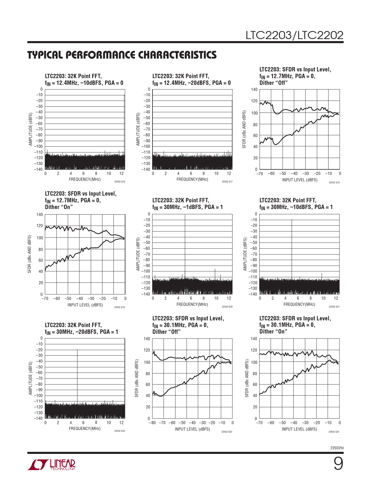

Pages / Page32 / 9 — TYPICAL PERFORMANCE CHARACTERISTICS. LTC2203: SFDR vs Input Level,. …
TYPICAL PERFORMANCE CHARACTERISTICS. LTC2203: SFDR vs Input Level,. LTC2203: 32K Point FFT,. fIN = 12.7MHz, PGA = 0,
TYPICAL PERFORMANCE CHARACTERISTICS LTC2203: SFDR vs Input Level, LTC2203: 32K Point FFT, fIN = 12.7MHz, PGA = 0,
LTC2203/LTC2202
TYPICAL PERFORMANCE CHARACTERISTICS LTC2203: SFDR vs Input Level, LTC2203: 32K Point FFT, LTC2203: 32K Point FFT, fIN = 12.7MHz, PGA = 0, fIN = 12.4MHz, –10dBFS, PGA = 0 fIN = 12.4MHz, –20dBFS, PGA = 0 Dither “Off”
0 0 140 –10 –10 –20 –20 120 –30 –30 –40 –40 100 –50 –50 –60 –60 80 –70 –70 –80 –80 60 –90 –90 AMPLITUDE (dBFS) –100 AMPLITUDE (dBFS) –100 SFDR (dBc AND dBFS) 40 –110 –110 –120 –120 20 –130 –130 –140 –140 0 0 2 4 6 8 10 12 0 2 4 6 8 10 12 –70 –60 –50 –40 –30 –20 –10 0 FREQUENCY(MHz) FREQUENCY(MHz) INPUT LEVEL (dBFS) 22032 G16 22032 G17 22032 G18
LTC2203: SFDR vs Input Level, fIN = 12.7MHz, PGA = 0, LTC2203: 32K Point FFT, LTC2203: 32K Point FFT, Dither “On” fIN = 30MHz, –1dBFS, PGA = 1 fIN = 30MHz, –10dBFS, PGA = 1
140 0 0 –10 –10 120 –20 –20 –30 –30 100 –40 –40 –50 –50 80 –60 –60 –70 –70 60 –80 –80 –90 –90 AMPLITUDE (dBFS) AMPLITUDE (dBFS) SFDR (dBc AND dBFS) 40 –100 –100 –110 –110 20 –120 –120 –130 –130 0 –140 –140 –70 –60 –50 –40 –30 –20 –10 0 0 2 4 6 8 10 12 0 2 4 6 8 10 12 INPUT LEVEL (dBFS) FREQUENCY(MHz) FREQUENCY(MHz) 22032 G19 22032 G20 22032 G21
LTC2203: SFDR vs Input Level, LTC2203: SFDR vs Input Level, LTC2203: 32K Point FFT, fIN = 30.1MHz, PGA = 0, fIN = 30.1MHz, PGA = 0, fIN = 30MHz, –20dBFS, PGA = 1 Dither “Off” Dither “On”
