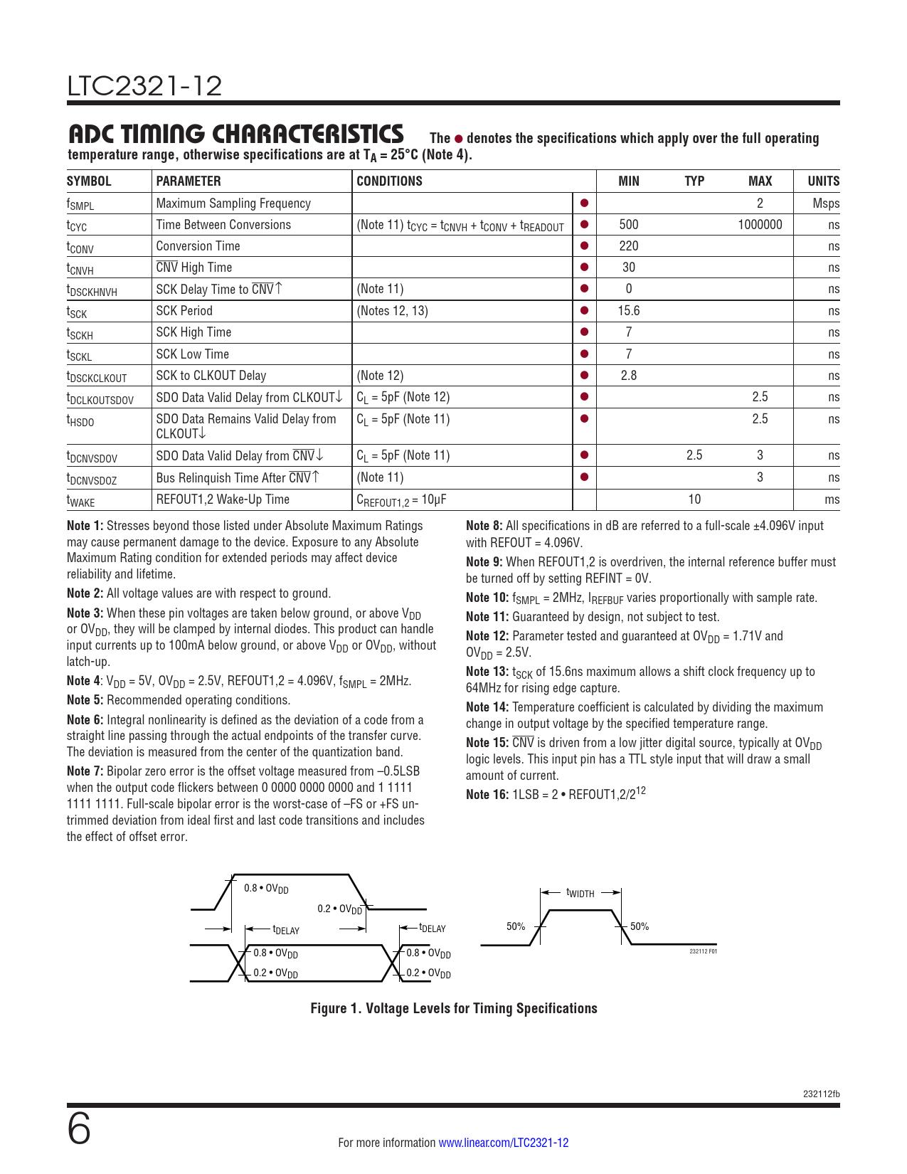

ADC. TIMING CHARACTERISTICS The. denotes the specifications which apply over the full operating
ADC TIMING CHARACTERISTICS The denotes the specifications which apply over the full operating
LTC2321-12
l
denotes the specifications which apply over the full operating temperature range, otherwise specifications are at TA = 25°C (Note 4). SYMBOL PARAMETER CONDITIONS MIN TYP MAX UNITS
fSMPL Maximum Sampling Frequency l 2 Msps tCYC Time Between Conversions (Note 11) tCYC = tCNVH + tCONV + tREADOUT l 500 1000000 ns tCONV Conversion Time l 220 ns tCNVH CNV High Time l 30 ns tDSCKHNVH SCK Delay Time to CNV↑ (Note 11) l 0 ns tSCK SCK Period (Notes 12, 13) l 15.6 ns tSCKH SCK High Time l 7 ns tSCKL SCK Low Time l 7 ns tDSCKCLKOUT SCK to CLKOUT Delay (Note 12) l 2.8 ns tDCLKOUTSDOV SDO Data Valid Delay from CLKOUT↓ CL = 5pF (Note 12) l 2.5 ns tHSDO SDO Data Remains Valid Delay from CL = 5pF (Note 11) l 2.5 ns CLKOUT↓ tDCNVSDOV SDO Data Valid Delay from CNV↓ CL = 5pF (Note 11) l 2.5 3 ns tDCNVSDOZ Bus Relinquish Time After CNV↑ (Note 11) l 3 ns tWAKE REFOUT1,2 Wake-Up Time CREFOUT1,2 = 10μF 10 ms
Note 1:
Note 8:
All specifications in dB are referred to a full-scale ±4.096V input may cause permanent damage to the device. Exposure to any Absolute with REFOUT = 4.096V. Maximum Rating condition for extended periods may affect device
Note 9:
When REFOUT1,2 is overdriven, the internal reference buffer must reliability and lifetime. be turned off by setting REFINT = 0V.
Note 2:
All voltage values are with respect to ground.
Note 10:
fSMPL = 2MHz, IREFBUF varies proportionally with sample rate.
Note 3:
When these pin voltages are taken below ground, or above VDD
Note 11:
Guaranteed by design, not subject to test. or OVDD, they will be clamped by internal diodes. This product can handle
Note 12:
Parameter tested and guaranteed at OV input currents up to 100mA below ground, or above V DD = 1.71V and DD or OVDD, without OV latch-up. DD = 2.5V.
Note 13:
t
Note 4
: V SCK of 15.6ns maximum allows a shift clock frequency up to DD = 5V, OVDD = 2.5V, REFOUT1,2 = 4.096V, fSMPL = 2MHz. 64MHz for rising edge capture.
Note 5:
Recommended operating conditions.
Note 14:
Temperature coefficient is calculated by dividing the maximum
Note 6:
Integral nonlinearity is defined as the deviation of a code from a change in output voltage by the specified temperature range. straight line passing through the actual endpoints of the transfer curve.
Note 15:
CNV is driven from a low jitter digital source, typically at OV The deviation is measured from the center of the quantization band. DD logic levels. This input pin has a TTL style input that will draw a small
Note 7:
Bipolar zero error is the offset voltage measured from –0.5LSB amount of current. when the output code flickers between 0 0000 0000 0000 and 1 1111
Note 16:
1LSB = 2 • REFOUT1,2/212 1111 1111. Full-scale bipolar error is the worst-case of –FS or +FS un- trimmed deviation from ideal first and last code transitions and includes the effect of offset error. 0.8 • OVDD tWIDTH 0.2 • OVDD t tDELAY 50% 50% DELAY 232112 F01 0.8 • OVDD 0.8 • OVDD 0.2 • OVDD 0.2 • OVDD
Figure 1. Voltage Levels for Timing Specifications
