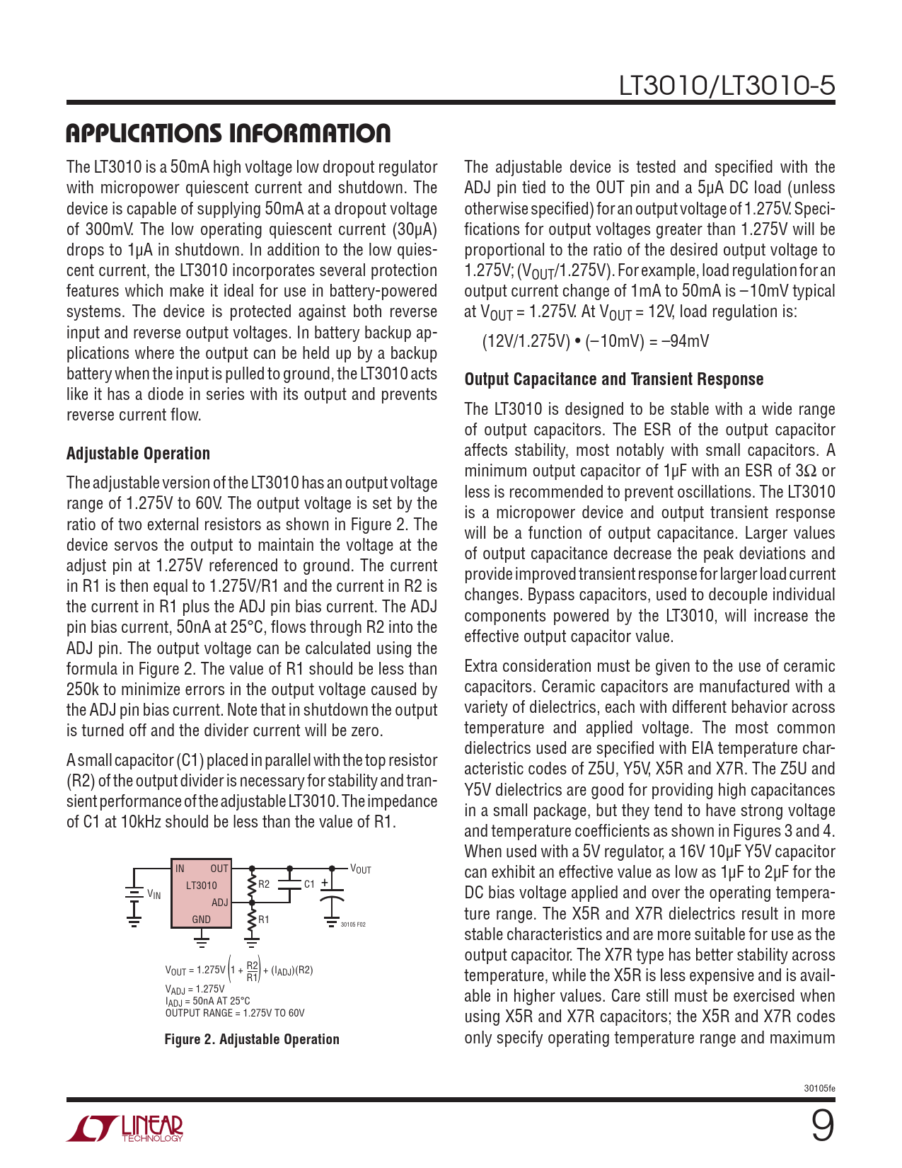

Adjustable Operation
affects stability, most notably with small capacitors. A minimum output capacitor of 1µF with an ESR of 3Ω or The adjustable version of the LT3010 has an output voltage less is recommended to prevent oscillations. The LT3010 range of 1.275V to 60V. The output voltage is set by the is a micropower device and output transient response ratio of two external resistors as shown in Figure 2. The will be a function of output capacitance. Larger values device servos the output to maintain the voltage at the of output capacitance decrease the peak deviations and adjust pin at 1.275V referenced to ground. The current provide improved transient response for larger load current in R1 is then equal to 1.275V/R1 and the current in R2 is changes. Bypass capacitors, used to decouple individual the current in R1 plus the ADJ pin bias current. The ADJ components powered by the LT3010, will increase the pin bias current, 50nA at 25°C, flows through R2 into the effective output capacitor value. ADJ pin. The output voltage can be calculated using the formula in Figure 2. The value of R1 should be less than Extra consideration must be given to the use of ceramic 250k to minimize errors in the output voltage caused by capacitors. Ceramic capacitors are manufactured with a the ADJ pin bias current. Note that in shutdown the output variety of dielectrics, each with different behavior across is turned off and the divider current will be zero. temperature and applied voltage. The most common dielectrics used are specified with EIA temperature char- A small capacitor (C1) placed in parallel with the top resistor acteristic codes of Z5U, Y5V, X5R and X7R. The Z5U and (R2) of the output divider is necessary for stability and tran- Y5V dielectrics are good for providing high capacitances sient performance of the adjustable LT3010. The impedance in a small package, but they tend to have strong voltage of C1 at 10kHz should be less than the value of R1. and temperature coefficients as shown in Figures 3 and 4. When used with a 5V regulator, a 16V 10µF Y5V capacitor IN OUT VOUT can exhibit an effective value as low as 1µF to 2µF for the LT3010 R2 C1 + VIN DC bias voltage applied and over the operating tempera- ADJ GND R1 ture range. The X5R and X7R dielectrics result in more 30105 F02 stable characteristics and are more suitable for use as the output capacitor. The X7R type has better stability across R2 VOUT = 1.275V 1 + + (I ( )R1 ADJ)(R2) temperature, while the X5R is less expensive and is avail- VADJ = 1.275V I able in higher values. Care still must be exercised when ADJ = 50nA AT 25°C OUTPUT RANGE = 1.275V TO 60V using X5R and X7R capacitors; the X5R and X7R codes
Figure 2. Adjustable Operation
