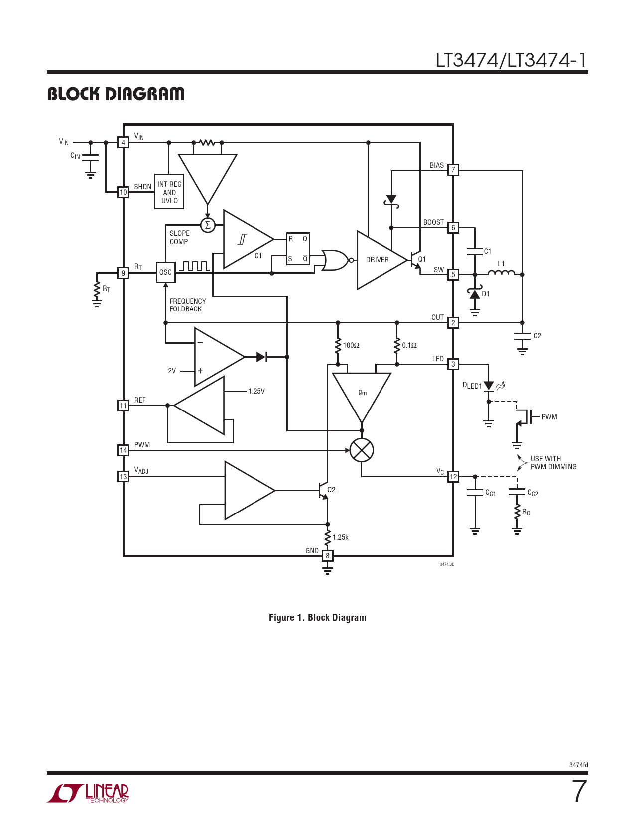

Pages / Page20 / 7 — BLOCK DIAGRAM. Figure 1. Block Diagram
File Format / SizePDF / 226 Kb
BLOCK DIAGRAM Figure 1 Block Diagram
LT3474/LT3474-1
BLOCK DIAGRAM
VIN VIN 4 CIN BIAS 7 SHDN INT REG 10 AND UVLO ∑ BOOST 6 SLOPE COMP R Q C1 C1 S Q DRIVER Q1 R L1 T 9 OSC SW 5 RT D1 FREQUENCY FOLDBACK OUT 2 – C2 100Ω 0.1Ω LED + 3 2V DLED1 1.25V gm REF 11 PWM PWM 14 USE WITH V PWM DIMMING ADJ VC 13 12 Q2 CC1 CC2 RC 1.25k GND 8 3474 BD
