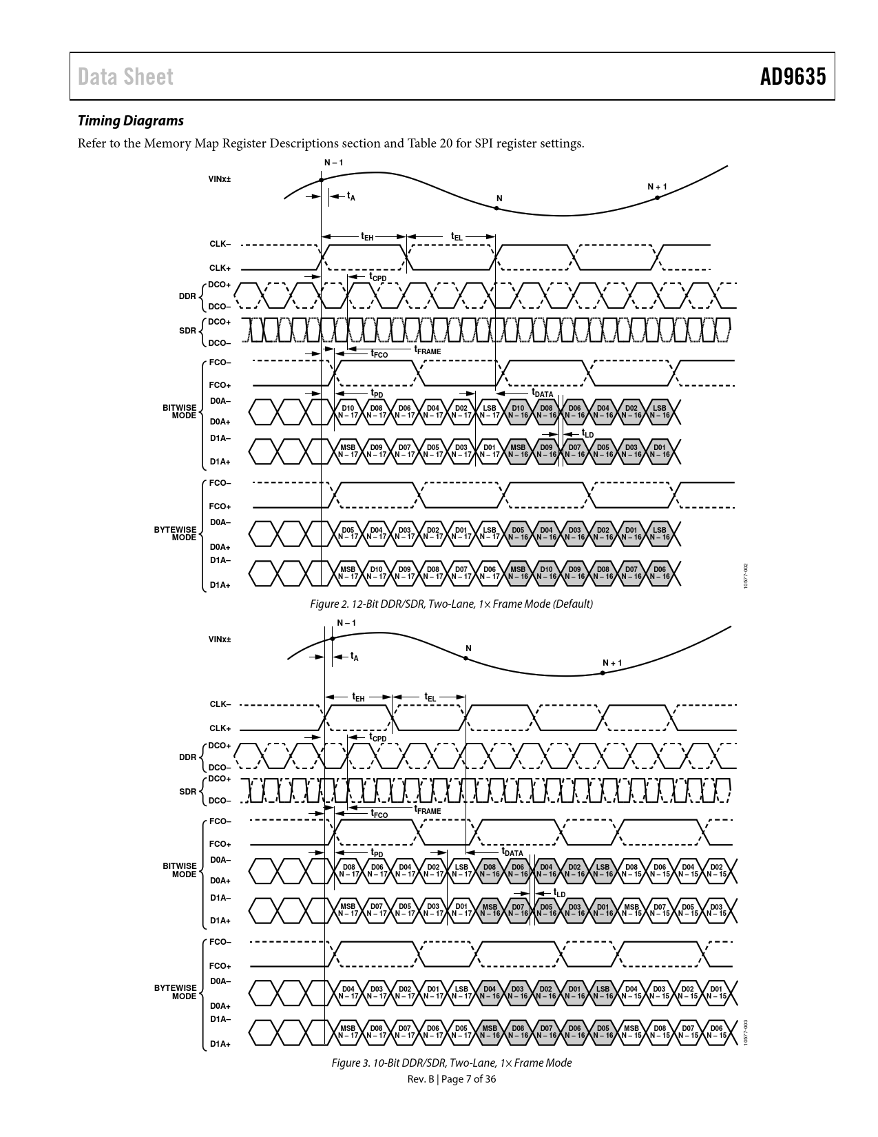

Data Sheet AD9635 Timing Diagrams
Refer to the Memory Map Register Descriptions section and Table 20 for SPI register settings.
N – 1 VINx± N + 1 tA N tEH tEL CLK– CLK+ tCPD DCO+ DDR DCO– DCO+ SDR DCO– tFRAME tFCO FCO– FCO+ t t PD DATA D0A– BITWISE D10 D08 D06 D04 D02 LSB D10 D08 D06 D04 D02 LSB MODE N – 17 N – 17 N – 17 N – 17 N – 17 N – 17 N – 16 N – 16 N – 16 N – 16 N – 16 N – 16 D0A+ t D1A– LD MSB D09 D07 D05 D03 D01 MSB D09 D07 D05 D03 D01 N – 17 N – 17 N – 17 N – 17 N – 17 N – 17 N – 16 N – 16 N – 16 N – 16 N – 16 N – 16 D1A+ FCO– FCO+ D0A– BYTEWISE D05 D04 D03 D02 D01 LSB D05 D04 D03 D02 D01 LSB MODE N – 17 N – 17 N – 17 N – 17 N – 17 N – 17 N – 16 N – 16 N – 16 N – 16 N – 16 N – 16 D0A+ D1A– MSB D10 D09 D08 D07 D06 MSB D10 D09 D08 D07 D06
002
10577- Figure 2. 12-Bit DDR/SDR, Two-Lane, 1× Frame Mode (Default)
N – 1 VINx± N tA N + 1 tEH tEL CLK– CLK+ tCPD DCO+ DDR DCO– DCO+ SDR DCO– tFRAME tFCO FCO– FCO+ t t PD DATA D0A– BITWISE D08 D06 D04 D02 LSB D08 D06 D04 D02 LSB D08 D06 D04 D02 MODE N – 17 N – 17 N – 17 N – 17 N – 17 N – 16 N – 16 N – 16 N – 16 N – 16 N – 15 N – 15 N – 15 N – 15 D0A+ t D1A– LD MSB D07 D05 D03 D01 MSB D07 D05 D03 D01 MSB D07 D05 D03 N – 17 N – 17 N – 17 N – 17 N – 17 N – 16 N – 16 N – 16 N – 16 N – 16 N – 15 N – 15 N – 15 N – 15 D1A+ FCO– FCO+ D0A– BYTEWISE D04 D03 D02 D01 LSB D04 D0 D03 D02 D01 LSB D04 D03 D02 D01 MODE N – 17 N – 17 N – 17 N – 17 N – 17 N – 16 N N – 16 N – 16 N – 16 N – 16 N – 15 N – 15 N – 15 N – 15 D0A+ D1A–
003
MSB D08 D07 D06 D05 MSB D08 D07 D06 D05 MSB D08 D07 D06 N – 17 N – 17 N – 17 N – 17 N – 17 N – 16 N – 16 N – 16 N – 16 N – 16 N – 15 N – 15 N – 15 N – 15 D1A+
