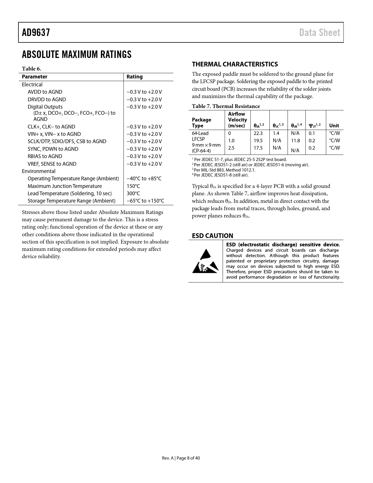

AD9637. Data Sheet. ABSOLUTE MAXIMUM RATINGS. THERMAL CHARACTERISTICS. Table 6. Parameter. Rating. Table 7. Thermal Resistance
AD9637 Data Sheet ABSOLUTE MAXIMUM RATINGS THERMAL CHARACTERISTICS Table 6 Parameter Rating Table 7 Thermal Resistance
link to page 9 link to page 9 link to page 9 link to page 9 link to page 9
AD9637 Data Sheet ABSOLUTE MAXIMUM RATINGS THERMAL CHARACTERISTICS Table 6. Parameter Rating
The exposed paddle must be soldered to the ground plane for Electrical the LFCSP package. Soldering the exposed paddle to the printed AVDD to AGND −0.3 V to +2.0 V circuit board (PCB) increases the reliability of the solder joints DRVDD to AGND −0.3 V to +2.0 V and maximizes the thermal capability of the package. Digital Outputs −0.3 V to +2.0 V
(D± x, DCO+, DCO−, FCO+, FCO−) to
Airflow
AGND
Package Velocity
CLK+, CLK− to AGND −0.3 V to +2.0 V
Type (m/sec) θ 1, 2 1, 3 1, 4 1, 2 JA θJC θJB
Ψ
JT Unit
VIN+ x, VIN− x to AGND −0.3 V to +2.0 V 64-Lead 0 22.3 1.4 N/A 0.1 °C/W SCLK/DTP, SDIO/DFS, CSB to AGND −0.3 V to +2.0 V LFCSP 1.0 19.5 N/A 11.8 0.2 °C/W 9 mm × 9 mm SYNC, PDWN to AGND −0.3 V to +2.0 V (CP-64-4) 2.5 17.5 N/A N/A 0.2 °C/W RBIAS to AGND −0.3 V to +2.0 V 1 Per JEDEC 51-7, plus JEDEC 25-5 2S2P test board. VREF, SENSE to AGND −0.3 V to +2.0 V 2 Per JEDEC JESD51-2 (stil air) or JEDEC JESD51-6 (moving air). Environmental 3 Per MIL-Std 883, Method 1012.1. 4 Per JEDEC JESD51-8 (still air). Operating Temperature Range (Ambient) −40°C to +85°C Maximum Junction Temperature 150°C Typical θJA is specified for a 4-layer PCB with a solid ground Lead Temperature (Soldering, 10 sec) 300°C plane. As shown Table 7, airflow improves heat dissipation, Storage Temperature Range (Ambient) −65°C to +150°C which reduces θJA. In addition, metal in direct contact with the package leads from metal traces, through holes, ground, and Stresses above those listed under Absolute Maximum Ratings power planes reduces θ may cause permanent damage to the device. This is a stress JA. rating only; functional operation of the device at these or any other conditions above those indicated in the operational
