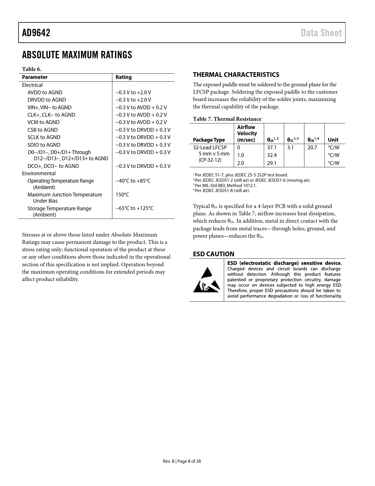

AD9642. Data Sheet. ABSOLUTE MAXIMUM RATINGS. Table 6. Parameter Rating. THERMAL CHARACTERISTICS. Table 7. Thermal Resistance
AD9642 Data Sheet ABSOLUTE MAXIMUM RATINGS Table 6 Parameter Rating THERMAL CHARACTERISTICS Table 7 Thermal Resistance
link to page 9
AD9642 Data Sheet ABSOLUTE MAXIMUM RATINGS Table 6. Parameter Rating THERMAL CHARACTERISTICS
Electrical The exposed paddle must be soldered to the ground plane for the AVDD to AGND −0.3 V to +2.0 V LFCSP package. Soldering the exposed paddle to the customer DRVDD to AGND −0.3 V to +2.0 V board increases the reliability of the solder joints, maximizing VIN+, VIN− to AGND −0.3 V to AVDD + 0.2 V the thermal capability of the package. CLK+, CLK− to AGND −0.3 V to AVDD + 0.2 V
VCM to AGND −0.3 V to AVDD + 0.2 V
Airflow
CSB to AGND −0.3 V to DRVDD + 0.3 V
Velocity
SCLK to AGND −0.3 V to DRVDD + 0.3 V
Package Type (m/sec) θ 1, 2 1, 3 1, 4 JA θJC θJB Unit
SDIO to AGND −0.3 V to DRVDD + 0.3 V 32-Lead LFCSP 0 37.1 3.1 20.7 °C/W D0−/D1−, D0+/D1+ Through −0.3 V to DRVDD + 0.3 V 5 mm × 5 mm 1.0 32.4 °C/W D12−/D13−, D12+/D13+ to AGND (CP-32-12) 2.0 29.1 °C/W DCO+, DCO− to AGND −0.3 V to DRVDD + 0.3 V Environmental 1 Per JEDEC 51-7, plus JEDEC 25-5 2S2P test board. Operating Temperature Range −40°C to +85°C 2 Per JEDEC JESD51-2 (still air) or JEDEC JESD51-6 (moving air). 3 (Ambient) Per MIL-Std 883, Method 1012.1. 4 Per JEDEC JESD51-8 (still air). Maximum Junction Temperature 150°C Under Bias Storage Temperature Range −65°C to +125°C Typical θJA is specified for a 4-layer PCB with a solid ground (Ambient) plane. As shown in Table 7, airflow increases heat dissipation, which reduces θJA. In addition, metal in direct contact with the package leads from metal traces—through holes, ground, and Stresses at or above those listed under Absolute Maximum power planes—reduces the θJA. Ratings may cause permanent damage to the product. This is a stress rating only; functional operation of the product at these or any other conditions above those indicated in the operational
