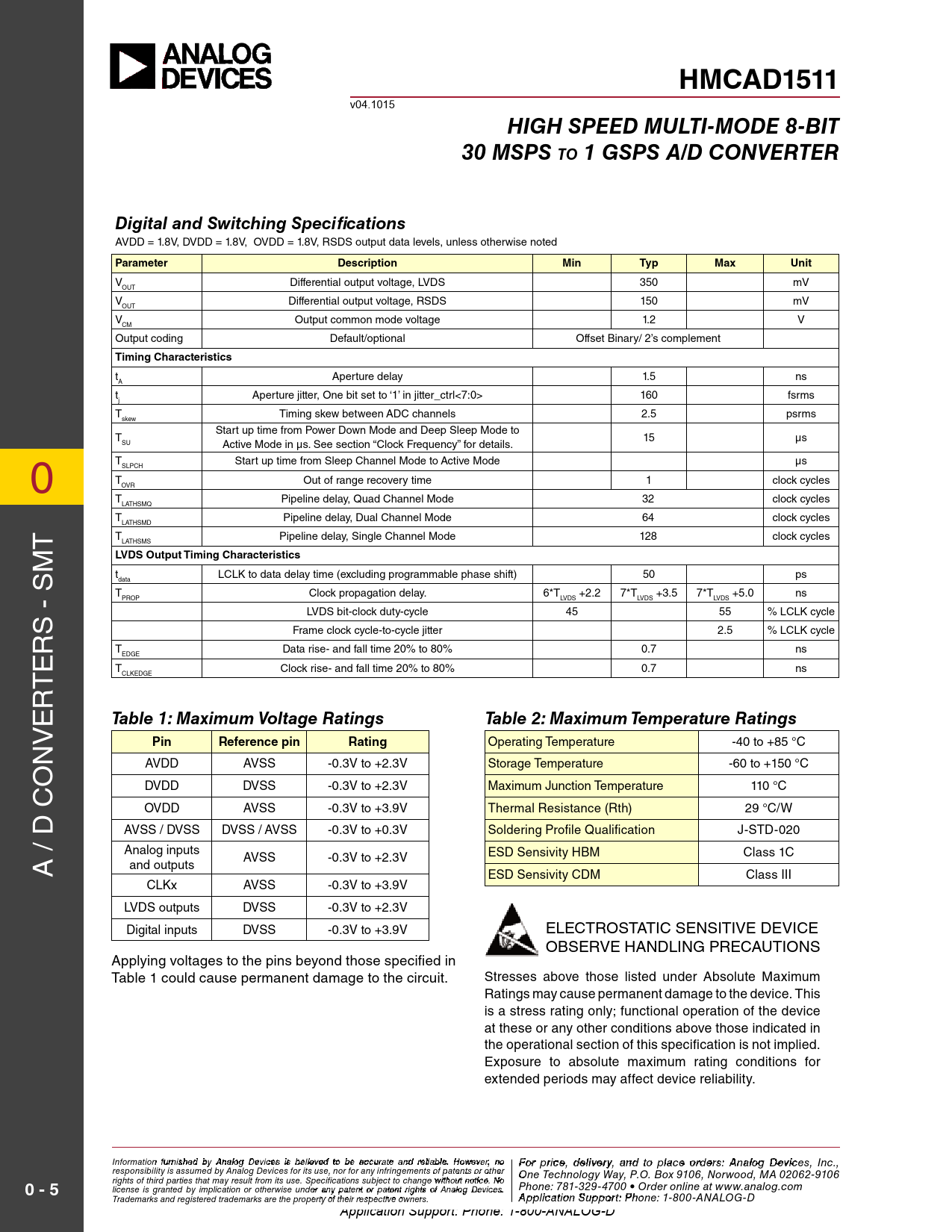

HigH Speed Multi-Mode 8-Bit 30 MSpS to 1 gSpS A/d Converter digital and Switching Specifications
AvDD = 1.8v, DvDD = 1.8v, ovDD = 1.8v, rsDs output data levels, unless otherwise noted
Parameter Description Min Typ Max Unit
v Differential output voltage, LvDs 350 mv oUt v Differential output voltage, rsDs 150 mv oUt v output common mode voltage 1.2 v CM output coding Default/optional offset Binary/ 2’s complement
Timing Characteristics
t Aperture delay 1.5 ns A t Aperture jitter, one bit set to ‘1’ in jitter_ctrl<7:0> 160 fsrms j t timing skew between ADC channels 2.5 psrms skew start up time from Power Down Mode and Deep sleep Mode to t 15 µs sU Active Mode in µs. see section “Clock Frequency” for details. 0 t start up time from sleep Channel Mode to Active Mode µs sLPCH t out of range recovery time 1 clock cycles ovr t Pipeline delay, Quad Channel Mode 32 clock cycles LAtHsMQ t Pipeline delay, Dual Channel Mode 64 clock cycles LAtHsMD t t Pipeline delay, single Channel Mode 128 clock cycles LAtHsMs M
LVDS Output Timing Characteristics
s t LCLK to data delay time (excluding programmable phase shift) 50 ps data t Clock propagation delay. 6*t +2.2 7*t +3.5 7*t +5.0 ns ProP LvDs LvDs LvDs s - LvDs bit-clock duty-cycle 45 55 % LCLK cycle r Frame clock cycle-to-cycle jitter 2.5 % LCLK cycle e t Data rise- and fall time 20% to 80% 0.7 ns eDGe t t Clock rise- and fall time 20% to 80% 0.7 ns CLKeDGe r e
table 1: Maximum voltage ratings table 2: Maximum temperature ratings
v n
Pin Reference pin Rating
operating temperature -40 to +85 °C o AvDD Avss -0.3v to +2.3v storage temperature -60 to +150 °C DvDD Dvss -0.3v to +2.3v Maximum Junction temperature 110 °C ovDD Avss -0.3v to +3.9v thermal resistance (rth) 29 °C/W /D C Avss / Dvss Dvss / Avss -0.3v to +0.3v soldering Profile Qualification J-stD-020 Analog inputs A Avss -0.3v to +2.3v esD sensivity HBM Class 1C and outputs esD sensivity CDM Class III CLKx Avss -0.3v to +3.9v LvDs outputs Dvss -0.3v to +2.3v Digital inputs Dvss -0.3v to +3.9v eLeCtrostAtIC sensItIve DevICe oBserve HAnDLInG PreCAUtIons Applying voltages to the pins beyond those specified in table 1 could cause permanent damage to the circuit. stresses above those listed under Absolute Maximum ratings may cause permanent damage to the device. this is a stress rating only; functional operation of the device at these or any other conditions above those indicated in the operational section of this specification is not implied. exposure to absolute maximum rating conditions for extended periods may affect device reliability. Informatio For price, delivery, and to place orders: Analog Devices, Inc., One Technology Way, P.O. Box 9106, Norwood, n furnished by Analog Devices is believed to be accurate and reliable. However, no For price, delivery, and to place orders: Analog Devices, Inc., responsibility is assumed by Analog Devices for its use, nor for any infringement MA 02062-9106 s of patents or other One Technology Way, P.O. Box 9106, Norwood, MA 02062-9106
