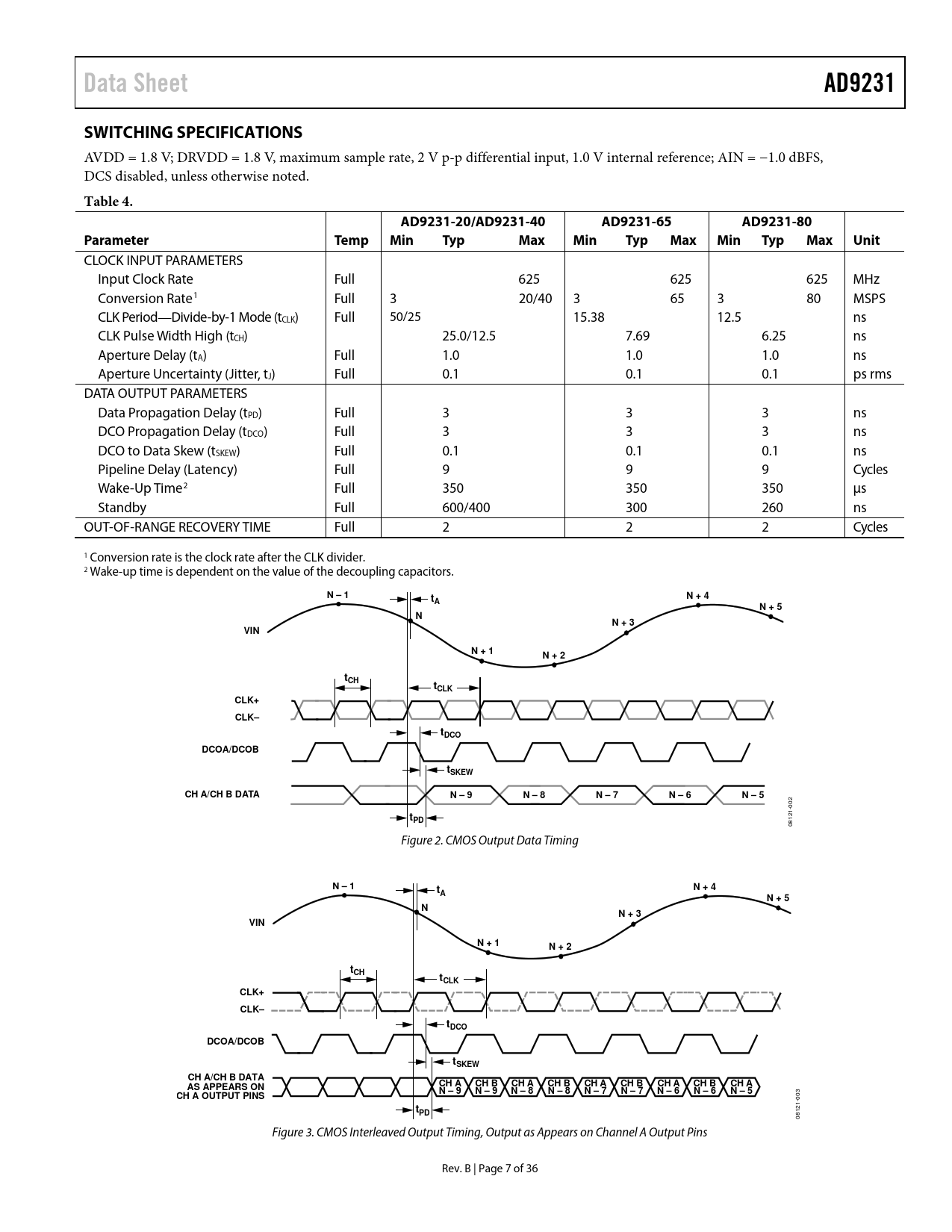

Data Sheet AD9231 SWITCHING SPECIFICATIONS
AVDD = 1.8 V; DRVDD = 1.8 V, maximum sample rate, 2 V p-p differential input, 1.0 V internal reference; AIN = −1.0 dBFS, DCS disabled, unless otherwise noted.
Table 4. AD9231-20/AD9231-40 AD9231-65 AD9231-80 Parameter Temp Min Typ Max Min Typ Max Min Typ Max Unit
CLOCK INPUT PARAMETERS Input Clock Rate Full 625 625 625 MHz Conversion Rate1 Full 3 20/40 3 65 3 80 MSPS CLK Period—Divide-by-1 Mode (tCLK) Full 50/25 15.38 12.5 ns CLK Pulse Width High (tCH) 25.0/12.5 7.69 6.25 ns Aperture Delay (tA) Full 1.0 1.0 1.0 ns Aperture Uncertainty (Jitter, tJ) Full 0.1 0.1 0.1 ps rms DATA OUTPUT PARAMETERS Data Propagation Delay (tPD) Full 3 3 3 ns DCO Propagation Delay (tDCO) Full 3 3 3 ns DCO to Data Skew (tSKEW) Full 0.1 0.1 0.1 ns Pipeline Delay (Latency) Full 9 9 9 Cycles Wake-Up Time2 Full 350 350 350 µs Standby Full 600/400 300 260 ns OUT-OF-RANGE RECOVERY TIME Full 2 2 2 Cycles 1 Conversion rate is the clock rate after the CLK divider. 2 Wake-up time is dependent on the value of the decoupling capacitors.
N – 1 N + 4 tA N + 5 N N + 3 VIN N + 1 N + 2 tCH tCLK CLK+ CLK– tDCO DCOA/DCOB tSKEW CH A/CH B DATA N – 9 N – 8 N – 7 N – 6 N – 5
002
tPD
08121- Figure 2. CMOS Output Data Timing
N – 1 N + 4 tA N + 5 N N + 3 VIN N + 1 N + 2 tCH tCLK CLK+ CLK– tDCO DCOA/DCOB tSKEW CH A/CH B DATA CH A CH B CH A CH B CH A CH B CH A CH B CH A AS APPEARS ON N – 9 N – 9 N – 8 N – 8 N – 7 N – 7 N – 6 N – 6 N – 5 CH A OUTPUT PINS
003
tPD
08121- Figure 3. CMOS Interleaved Output Timing, Output as Appears on Channel A Output Pins Rev. B | Page 7 of 36 Document Outline FEATURES APPLICATIONS FUNCTIONAL BLOCK DIAGRAM PRODUCT HIGHLIGHTS REVISION HISTORY GENERAL DESCRIPTION SPECIFICATIONS DC SPECIFICATIONS AC SPECIFICATIONS DIGITAL SPECIFICATIONS SWITCHING SPECIFICATIONS TIMING SPECIFICATIONS ABSOLUTE MAXIMUM RATINGS THERMAL CHARACTERISTICS ESD CAUTION PIN CONFIGURATION AND FUNCTION DESCRIPTIONS TYPICAL PERFORMANCE CHARACTERISTICS AD9231-80 AD9231-65 AD9231-40 AD9231-20 EQUIVALENT CIRCUITS THEORY OF OPERATION ADC ARCHITECTURE ANALOG INPUT CONSIDERATIONS Input Common Mode Differential Input Configurations Single-Ended Input Configuration VOLTAGE REFERENCE Internal Reference Connection External Reference Operation CLOCK INPUT CONSIDERATIONS Clock Input Options Input Clock Divider Clock Duty Cycle Jitter Considerations CHANNEL/CHIP SYNCHRONIZATION POWER DISSIPATION AND STANDBY MODE DIGITAL OUTPUTS Digital Output Enable Function (OEB) TIMING Data Clock Output (DCO) BUILT-IN SELF-TEST (BIST) AND OUTPUT TEST BUILT-IN SELF-TEST (BIST) OUTPUT TEST MODES SERIAL PORT INTERFACE (SPI) CONFIGURATION USING THE SPI HARDWARE INTERFACE CONFIGURATION WITHOUT THE SPI SPI ACCESSIBLE FEATURES MEMORY MAP READING THE MEMORY MAP REGISTER TABLE OPEN LOCATIONS DEFAULT VALUES Logic Levels Transfer Register Map Channel-Specific Registers MEMORY MAP REGISTER TABLE MEMORY MAP REGISTER DESCRIPTIONS Sync Control (Register 0x100) Bits[7:3]—Reserved Bit 2—Clock Divider Next Sync Only Bit 1—Clock Divider Sync Enable Bit 0—Master Sync Enable Bit 7—Enable OEB Pin 47 Bit 3—Enable GCLK Detect Bit 2—Run GCLK Bit 0—Disable SDIO Pull-Down APPLICATIONS INFORMATION DESIGN GUIDELINES Power and Ground Recommendations Exposed Paddle Thermal Heat Sink Recommendations VCM RBIAS Reference Decoupling SPI Port OUTLINE DIMENSIONS ORDERING GUIDE
