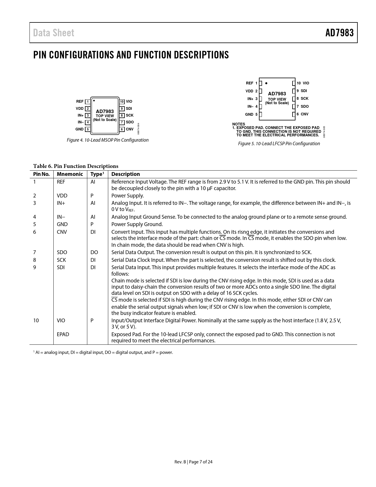

Data Sheet. AD7983. PIN CONFIGURATIONS AND FUNCTION DESCRIPTIONS. REF 1. 10 VIO. VDD 2. 9 SDI. IN+ 3. TOP VIEW. 8 SCK. REF. (Not to Scale)
Data Sheet AD7983 PIN CONFIGURATIONS AND FUNCTION DESCRIPTIONS REF 1 10 VIO VDD 2 9 SDI IN+ 3 TOP VIEW 8 SCK REF (Not to Scale)
Data Sheet AD7983 PIN CONFIGURATIONS AND FUNCTION DESCRIPTIONS REF 1 10 VIO VDD 2 9 SDI AD7983 IN+ 3 TOP VIEW 8 SCK REF 1 10 VIO (Not to Scale) IN– 4 7 SDO VDD 2 9 SDI AD7983 IN+ 3 8 GND 5 6 CNV TOP VIEW SCK (Not to Scale) IN– 4 7 SDO NOTES
004
GND 1. EXPOSED PAD. CONNECT THE EXPOSED PAD 5 6 CNV
005
TO GND. THIS CONNECTION IS NOT REQUIRED
06974-
TO MEET THE ELECTRICAL PERFORMANCES.
06974- Figure 4. 10-Lead MSOP Pin Configuration Figure 5. 10-Lead LFCSP Pin Configuration
Table 6. Pin Function Descriptions Pin No. Mnemonic Type1 Description
1 REF AI Reference Input Voltage. The REF range is from 2.9 V to 5.1 V. It is referred to the GND pin. This pin should be decoupled closely to the pin with a 10 µF capacitor. 2 VDD P Power Supply. 3 IN+ AI Analog Input. It is referred to IN−. The voltage range, for example, the difference between IN+ and IN−, is 0 V to VREF. 4 IN− AI Analog Input Ground Sense. To be connected to the analog ground plane or to a remote sense ground. 5 GND P Power Supply Ground. 6 CNV DI Convert Input. This input has multiple functions. On its risng edge, it initiates the conversions and selects the interface mode of the part: chain or CS mode. In CS mode, it enables the SDO pin when low. In chain mode, the data should be read when CNV is high. 7 SDO DO Serial Data Output. The conversion result is output on this pin. It is synchronized to SCK. 8 SCK DI Serial Data Clock Input. When the part is selected, the conversion result is shifted out by this clock. 9 SDI DI Serial Data Input. This input provides multiple features. It selects the interface mode of the ADC as follows: Chain mode is selected if SDI is low during the CNV rising edge. In this mode, SDI is used as a data input to daisy-chain the conversion results of two or more ADCs onto a single SDO line. The digital data level on SDI is output on SDO with a delay of 16 SCK cycles. CS mode is selected if SDI is high during the CNV rising edge. In this mode, either SDI or CNV can enable the serial output signals when low; if SDI or CNV is low when the conversion is complete, the busy indicator feature is enabled. 10 VIO P Input/Output Interface Digital Power. Nominally at the same supply as the host interface (1.8 V, 2.5 V, 3 V, or 5 V). EPAD Exposed Pad. For the 10-lead LFCSP only, connect the exposed pad to GND. This connection is not required to meet the electrical performances. 1 AI = analog input, DI = digital input, DO = digital output, and P = power. Rev. B | Page 7 of 24 Document Outline Features Applications Application Diagram General Description Table of Contents Revision History Specifications Timing Specifications Absolute Maximum Ratings ESD Caution Pin Configurations and Function Descriptions Typical Performance Characteristics Terminology Theory of Operation Circuit Information Converter Operation Transfer Functions Typical Connection Diagram Analog Inputs Driver Amplifier Choice Voltage Reference Input Power Supply Digital Interface CS MODE, 3-Wire Without Busy Indicator CS Mode, 3-Wire with Busy Indicator CS Mode, 4-Wire Without Busy Indicator CS Mode, 4-Wire with Busy Indicator Chain Mode Without Busy Indicator Chain Mode with Busy Indicator Application Hints Layout Evaluating the Performance of the AD7983 Outline Dimensions Ordering Guide
