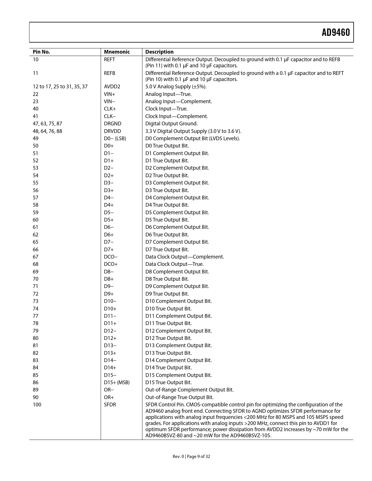

10 REFT Differential Reference Output. Decoupled to ground with 0.1 μF capacitor and to REFB (Pin 11) with 0.1 μF and 10 μF capacitors. 11 REFB Differential Reference Output. Decoupled to ground with a 0.1 μF capacitor and to REFT (Pin 10) with 0.1 μF and 10 μF capacitors. 12 to 17, 25 to 31, 35, 37 AVDD2 5.0 V Analog Supply (±5%). 22 VIN+ Analog Input—True. 23 VIN− Analog Input—Complement. 40 CLK+ Clock Input—True. 41 CLK− Clock Input—Complement. 47, 63, 75, 87 DRGND Digital Output Ground. 48, 64, 76, 88 DRVDD 3.3 V Digital Output Supply (3.0 V to 3.6 V). 49 D0− (LSB) D0 Complement Output Bit (LVDS Levels). 50 D0+ D0 True Output Bit. 51 D1− D1 Complement Output Bit. 52 D1+ D1 True Output Bit. 53 D2− D2 Complement Output Bit. 54 D2+ D2 True Output Bit. 55 D3− D3 Complement Output Bit. 56 D3+ D3 True Output Bit. 57 D4− D4 Complement Output Bit. 58 D4+ D4 True Output Bit. 59 D5− D5 Complement Output Bit. 60 D5+ D5 True Output Bit. 61 D6− D6 Complement Output Bit. 62 D6+ D6 True Output Bit. 65 D7− D7 Complement Output Bit. 66 D7+ D7 True Output Bit. 67 DCO− Data Clock Output—Complement. 68 DCO+ Data Clock Output—True. 69 D8− D8 Complement Output Bit. 70 D8+ D8 True Output Bit. 71 D9− D9 Complement Output Bit. 72 D9+ D9 True Output Bit. 73 D10− D10 Complement Output Bit. 74 D10+ D10 True Output Bit. 77 D11− D11 Complement Output Bit. 78 D11+ D11 True Output Bit. 79 D12− D12 Complement Output Bit. 80 D12+ D12 True Output Bit. 81 D13− D13 Complement Output Bit. 82 D13+ D13 True Output Bit. 83 D14− D14 Complement Output Bit. 84 D14+ D14 True Output Bit. 85 D15− D15 Complement Output Bit. 86 D15+ (MSB) D15 True Output Bit. 89 OR− Out-of-Range Complement Output Bit. 90 OR+ Out-of-Range True Output Bit. 100 SFDR SFDR Control Pin. CMOS-compatible control pin for optimizing the configuration of the AD9460 analog front end. Connecting SFDR to AGND optimizes SFDR performance for applications with analog input frequencies <200 MHz for 80 MSPS and 105 MSPS speed grades. For applications with analog inputs >200 MHz, connect this pin to AVDD1 for optimum SFDR performance; power dissipation from AVDD2 increases by ~70 mW for the AD9460BSVZ-80 and ~20 mW for the AD9460BSVZ-105. Rev. 0 | Page 9 of 32 Document Outline FEATURES FUNCTIONAL BLOCK DIAGRAM APPLICATIONS GENERAL DESCRIPTION PRODUCT HIGHLIGHTS TABLE OF CONTENTS REVISION HISTORY SPECIFICATIONS DC SPECIFICATIONS AC SPECIFICATIONS DIGITAL SPECIFICATIONS SWITCHING SPECIFICATIONS TIMING DIAGRAMS ABSOLUTE MAXIMUM RATINGS THERMAL RESISTANCE ESD CAUTION PIN CONFIGURATIONS AND FUNCTION DESCRIPTIONS EQUIVALENT CIRCUITS TYPICAL PERFORMANCE CHARACTERISTICS TERMINOLOGY THEORY OF OPERATION ANALOG INPUT AND REFERENCE OVERVIEW Internal Reference Connection Internal Reference Trim External Reference Operation Analog Inputs CLOCK INPUT CONSIDERATIONS Jitter Considerations POWER CONSIDERATIONS DIGITAL OUTPUTS LVDS Mode CMOS Mode TIMING OPERATIONAL MODE SELECTION Data Format Select Output Mode Select Duty Cycle Stabilizer SFDR Enhancement EVALUATION BOARD OUTLINE DIMENSIONS ORDERING GUIDE
