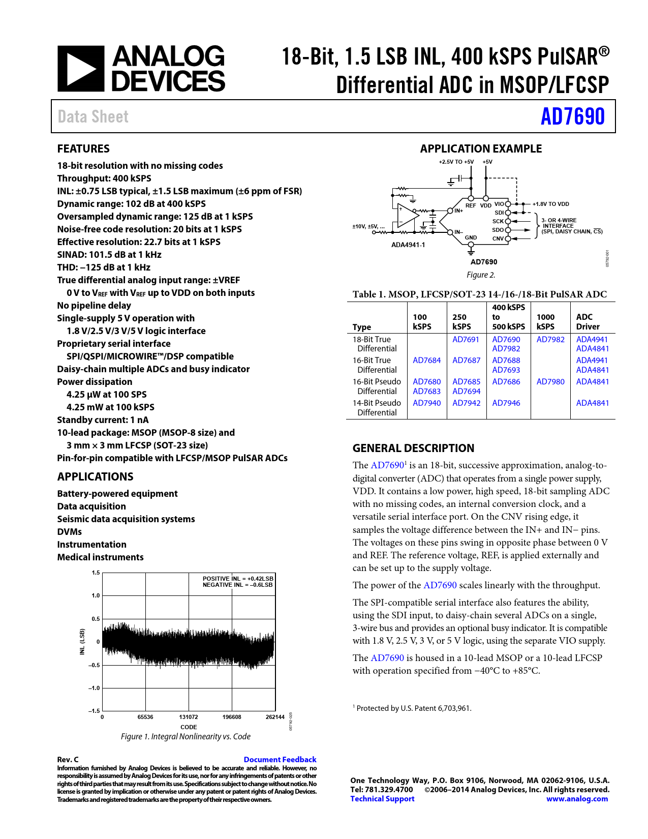

18-Bit, 1.5 LSB INL, 400 kSPS PulSAR®. Differential ADC in MSOP/LFCSP. Data Sheet. AD7690. FEATURES. APPLICATION EXAMPLE
![Datasheet AD7690 Analog Devices, Revision: C](https://www.rlocman.ru/datasheet/img.php?di=125323)
18-Bit, 1.5 LSB INL, 400 kSPS PulSAR® Differential ADC in MSOP/LFCSP Data Sheet AD7690 FEATURES APPLICATION EXAMPLE +2.5V TO +5V +5V 18-bit resolution with no missing codes Throughput: 400 kSPS INL: ±0.75 LSB typical, ±1.5 LSB maximum (±6 ppm of FSR) Dynamic range: 102 dB at 400 kSPS REF VDD VIO +1.8V TO VDD IN+ SDI Oversampled dynamic range: 125 dB at 1 kSPS SCK 3- OR 4-WIRE Noise-free code resolution: 20 bits at 1 kSPS ±10V, ±5V, ... INTERFACE IN– SDO (SPI, DAISY CHAIN, CS) GND Effective resolution: 22.7 bits at 1 kSPS CNV ADA4941-1 SINAD: 101.5 dB at 1 kHz
-001
AD7690
792
THD: −125 dB at 1 kHz
05 Figure 2.
True differential analog input range: ±VREF 0 V to VREF with VREF up to VDD on both inputs Table 1. MSOP, LFCSP/SOT-23 14-/16-/18-Bit PulSAR ADC No pipeline delay 400 kSPS Single-supply 5 V operation with 100 250 to 1000 ADC 1.8 V/2.5 V/3 V/5 V logic interface Type kSPS kSPS 500 kSPS kSPS Driver
18-Bit True AD7691 AD7690 AD7982 ADA4941
Proprietary serial interface
Differential AD7982 ADA4841
SPI/QSPI/MICROWIRE™/DSP compatible
16-Bit True AD7684 AD7687 AD7688 ADA4941
Daisy-chain multiple ADCs and busy indicator
Differential AD7693 ADA4841
Power dissipation
16-Bit Pseudo AD7680 AD7685 AD7686 AD7980 ADA4841
4.25 μW at 100 SPS
Differential AD7683 AD7694
4.25 mW at 100 kSPS
14-Bit Pseudo AD7940 AD7942 AD7946 ADA4841 Differential
Standby current: 1 nA 10-lead package: MSOP (MSOP-8 size) and 3 mm × 3 mm LFCSP (SOT-23 size) GENERAL DESCRIPTION Pin-for-pin compatible with LFCSP/MSOP PulSAR ADCs
The AD76901 is an 18-bit, successive approximation, analog-to-
APPLICATIONS
digital converter (ADC) that operates from a single power supply,
Battery-powered equipment
VDD. It contains a low power, high speed, 18-bit sampling ADC
Data acquisition
with no missing codes, an internal conversion clock, and a
Seismic data acquisition systems
versatile serial interface port. On the CNV rising edge, it
DVMs
samples the voltage difference between the IN+ and IN− pins.
Instrumentation
The voltages on these pins swing in opposite phase between 0 V
Medical instruments
and REF. The reference voltage, REF, is applied externally and can be set up to the supply voltage.
1.5 POSITIVE INL = +0.42LSB NEGATIVE INL = –0.6LSB
The power of the AD7690 scales linearly with the throughput.
1.0
The SPI-compatible serial interface also features the ability,
0.5
using the SDI input, to daisy-chain several ADCs on a single,
3-wire bus and provides an optional busy indicator. It is compatible
B S L 0
with 1.8 V, 2.5 V, 3 V, or 5 V logic, using the separate VIO supply.
L ( IN
The AD7690 is housed in a 10-lead MSOP or a 10-lead LFCSP
–0.5
with operation specified from −40°C to +85°C.
–1.0
1 Protected by U.S. Patent 6,703,961.
–1.5 0 65536 131072 196608 262144
025
CODE
05792- Figure 1. Integral Nonlinearity vs. Code
