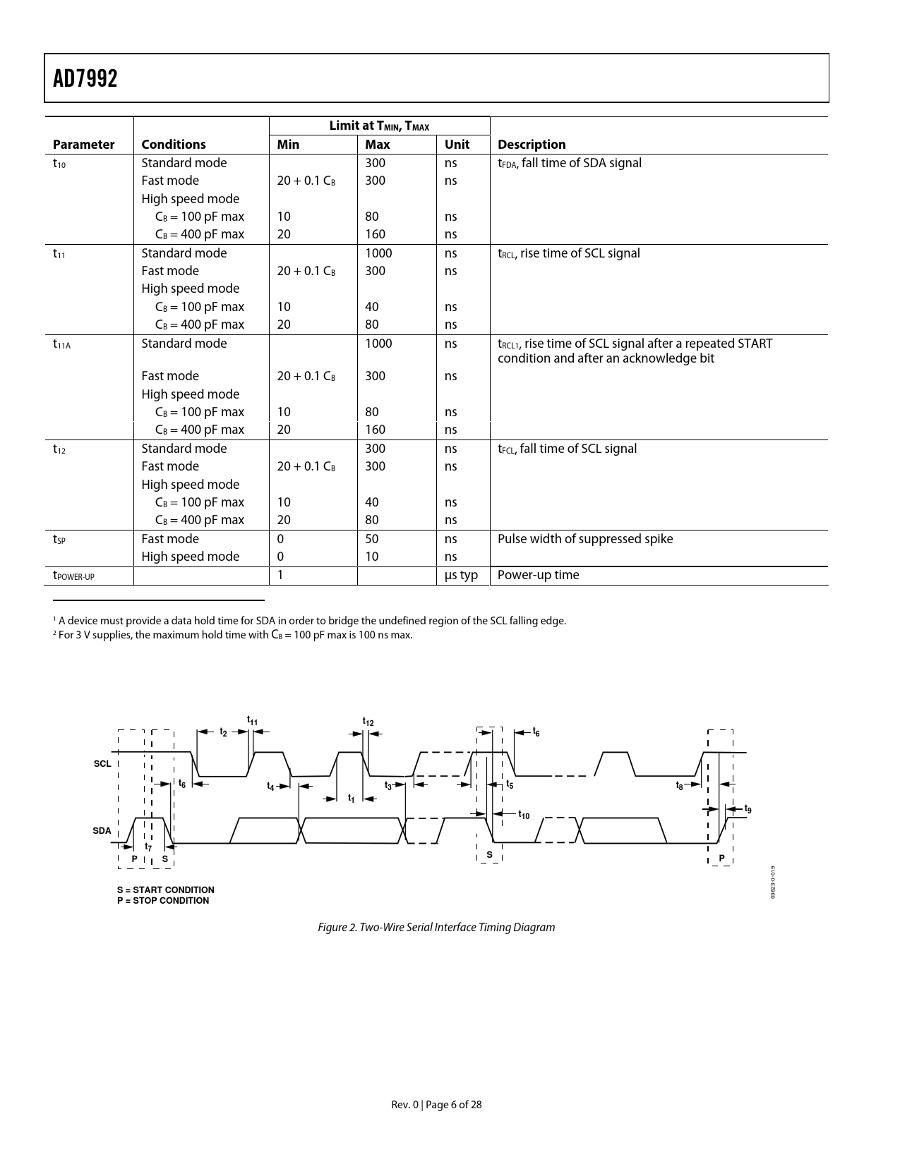

AD7992. Limit at TMIN, TMAX. Parameter Conditions. Min. Max. Unit Description. t11. t12. SCL. t10. SDA
AD7992 Limit at TMIN, TMAX Parameter Conditions Min Max Unit Description t11 t12 SCL t10 SDA
t10 Standard mode 300 ns tFDA, fall time of SDA signal Fast mode 20 + 0.1 CB 300 ns High speed mode CB = 100 pF max 10 80 ns CB = 400 pF max 20 160 ns t11 Standard mode 1000 ns tRCL, rise time of SCL signal Fast mode 20 + 0.1 CB 300 ns High speed mode CB = 100 pF max 10 40 ns CB = 400 pF max 20 80 ns t11A Standard mode 1000 ns tRCL1, rise time of SCL signal after a repeated START condition and after an acknowledge bit Fast mode 20 + 0.1 CB 300 ns High speed mode CB = 100 pF max 10 80 ns CB = 400 pF max 20 160 ns t12 Standard mode 300 ns tFCL, fall time of SCL signal Fast mode 20 + 0.1 CB 300 ns High speed mode CB = 100 pF max 10 40 ns CB = 400 pF max 20 80 ns tSP Fast mode 0 50 ns Pulse width of suppressed spike High speed mode 0 10 ns tPOWER-UP 1 µs typ Power-up time 1 A device must provide a data hold time for SDA in order to bridge the undefined region of the SCL falling edge. 2 For 3 V supplies, the maximum hold time with CB = 100 pF max is 100 ns max.
t11 t12 t2 t6 SCL t6 t t 4 t3 5 t8 t1 t9 t10 SDA t7 P S S P S = START CONDITION P = STOP CONDITION
