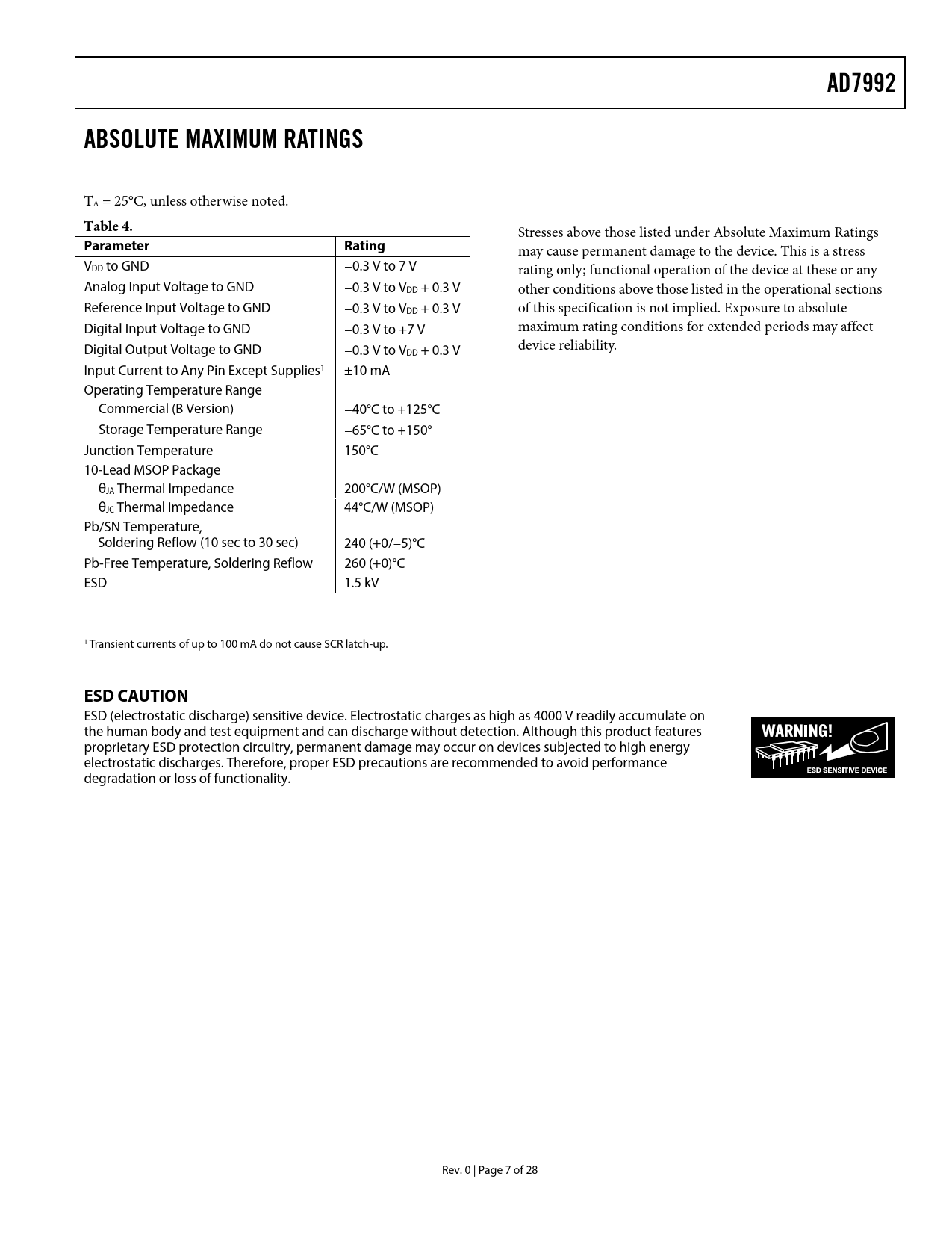

AD7992 ABSOLUTE MAXIMUM RATINGS
TA = 25°C, unless otherwise noted.
Table 4.
Stresses above those listed under Absolute Maximum Ratings
Parameter Rating
may cause permanent damage to the device. This is a stress VDD to GND −0.3 V to 7 V rating only; functional operation of the device at these or any Analog Input Voltage to GND −0.3 V to VDD + 0.3 V other conditions above those listed in the operational sections Reference Input Voltage to GND −0.3 V to VDD + 0.3 V of this specification is not implied. Exposure to absolute Digital Input Voltage to GND −0.3 V to +7 V maximum rating conditions for extended periods may affect Digital Output Voltage to GND −0.3 V to V device reliability. DD + 0.3 V Input Current to Any Pin Except Supplies1 ±10 mA Operating Temperature Range Commercial (B Version) −40°C to +125°C Storage Temperature Range −65°C to +150° Junction Temperature 150°C 10-Lead MSOP Package θJA Thermal Impedance 200°C/W (MSOP) θJC Thermal Impedance 44°C/W (MSOP) Pb/SN Temperature, Soldering Reflow (10 sec to 30 sec) 240 (+0/−5)°C Pb-Free Temperature, Soldering Reflow 260 (+0)°C ESD 1.5 kV 1 Transient currents of up to 100 mA do not cause SCR latch-up.
ESD CAUTION
ESD (electrostatic discharge) sensitive device. Electrostatic charges as high as 4000 V readily accumulate on the human body and test equipment and can discharge without detection. Although this product features proprietary ESD protection circuitry, permanent damage may occur on devices subjected to high energy electrostatic discharges. Therefore, proper ESD precautions are recommended to avoid performance degradation or loss of functionality. Rev. 0 | Page 7 of 28 Document Outline FEATURES GENERAL DESCRIPTION FUNCTIONAL BLOCK DIAGRAM PRODUCT HIGHLIGHTS SPECIFICATIONS I2C TIMING SPECIFICATIONS ABSOLUTE MAXIMUM RATINGS ESD CAUTION PIN CONFIGURATION AND PIN FUNCTION DESCRIPTIONS TERMINOLOGY TYPICAL PERFORMANCE CHARACTERISTICS CIRCUIT INFORMATION CONVERTER OPERATION TYPICAL CONNECTION DIAGRAM ANALOG INPUT INTERNAL REGISTER STRUCTURE ADDRESS POINTER REGISTER CONFIGURATION REGISTER CONVERSION RESULT REGISTER LIMIT REGISTERS ALERT STATUS REGISTER CYCLE TIMER REGISTER SAMPLE DELAY AND BIT TRIAL DELAY SERIAL INTERFACE SERIAL BUS ADDRESS WRITING TO THE AD7992 WRITING TO THE ADDRESS POINTER REGISTER FOR A SUBSEQUENT REA WRITING A SINGLE BYTE OF DATA TO THE ALERT STATUS REGISTER, WRITING TWO BYTES OF DATA TO A LIMITREGISTER OR HYSTERESIS READING DATA FROM THE AD7992 ALERT/BUSY PIN SMBus ALERT PLACING THE AD7992-1 INTO HIGH SPEED MODE THE ADDRESS SELECT (AS) PIN MODES OF OPERATION MODE 1—USING THE /CONVST PIN MODE 2 – COMMAND MODE MODE 3—AUTOMATIC CYCLE MODE OUTLINE DIMENSIONS ORDERING GUIDE
