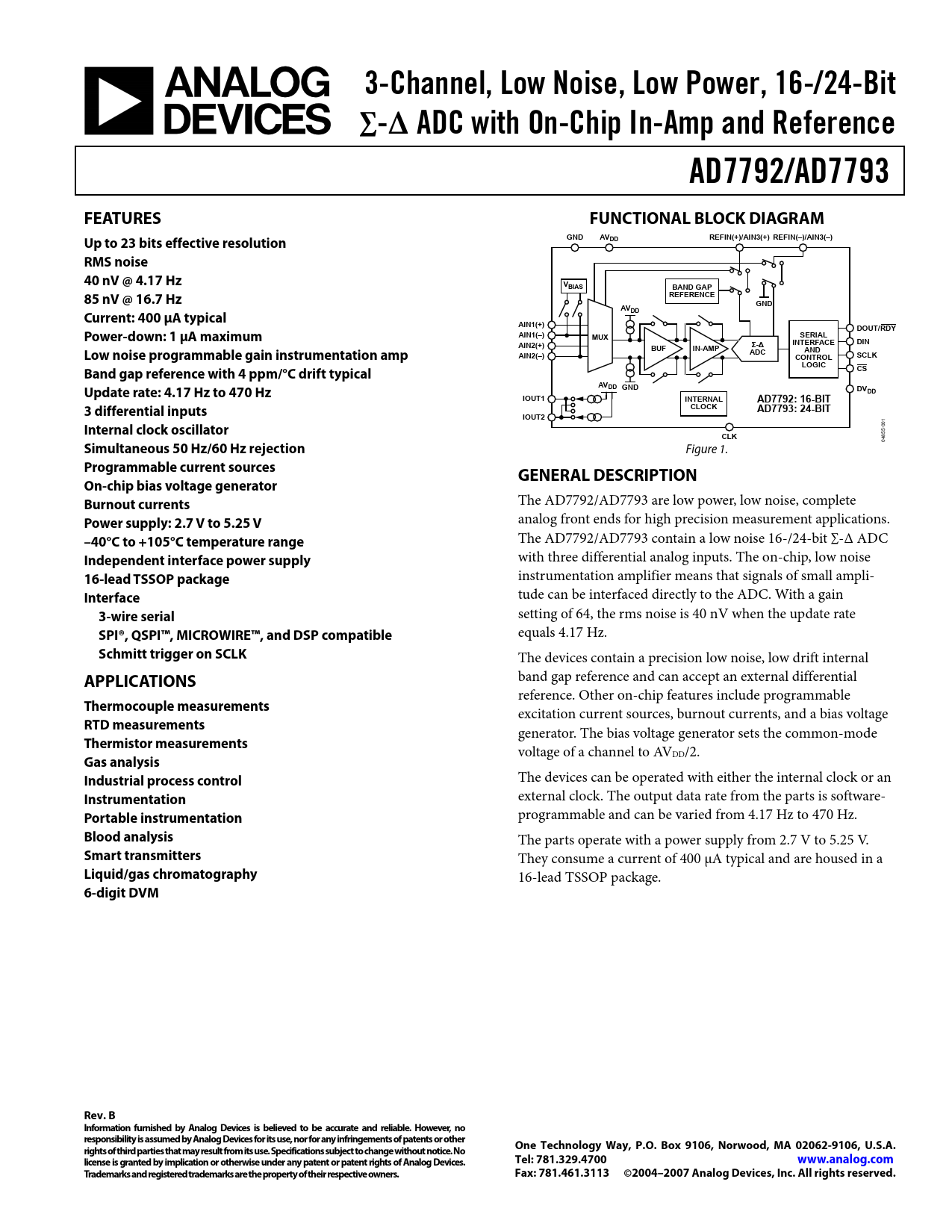

3-Channel, Low Noise, Low Power, 16-/24-Bit ∑-Δ ADC with On-Chip In-Amp and Reference AD7792/AD7793 FEATURES FUNCTIONAL BLOCK DIAGRAM GND AV REFIN(+)/AIN3(+) Up to 23 bits effective resolution DD REFIN(–)/AIN3(–) RMS noise 40 nV @ 4.17 Hz VBIAS BAND GAP 85 nV @ 16.7 Hz REFERENCE GND AVDD Current: 400 μA typical AIN1(+) DOUT/RDY Power-down: 1 μA maximum AIN1(–) SERIAL MUX INTERFACE DIN AIN2(+) Σ-Δ BUF IN-AMP AND Low noise programmable gain instrumentation amp ADC AIN2(–) SCLK CONTROL LOGIC CS Band gap reference with 4 ppm/°C drift typical AVDD GND Update rate: 4.17 Hz to 470 Hz DVDD IOUT1 INTERNAL AD7792: 16-BIT 3 differential inputs CLOCK AD7793: 24-BIT IOUT2

The AD7792/AD7793 are low power, low noise, complete
Power supply: 2.7 V to 5.25 V
analog front ends for high precision measurement applications.
–40°C to +105°C temperature range
The AD7792/AD7793 contain a low noise 16-/24-bit ∑-Δ ADC
Independent interface power supply
with three differential analog inputs. The on-chip, low noise
16-lead TSSOP package
instrumentation amplifier means that signals of small ampli-
Interface
tude can be interfaced directly to the ADC. With a gain
3-wire serial
setting of 64, the rms noise is 40 nV when the update rate
SPI®, QSPI™, MICROWIRE™, and DSP compatible
equals 4.17 Hz.
Schmitt trigger on SCLK
The devices contain a precision low noise, low drift internal
APPLICATIONS
band gap reference and can accept an external differential reference. Other on-chip features include programmable
Thermocouple measurements
excitation current sources, burnout currents, and a bias voltage
RTD measurements
generator. The bias voltage generator sets the common-mode
Thermistor measurements
voltage of a channel to AVDD/2.
Gas analysis Industrial process control
The devices can be operated with either the internal clock or an
Instrumentation
external clock. The output data rate from the parts is software-
Portable instrumentation
programmable and can be varied from 4.17 Hz to 470 Hz.
Blood analysis
The parts operate with a power supply from 2.7 V to 5.25 V.
Smart transmitters
They consume a current of 400 μA typical and are housed in a
Liquid/gas chromatography
16-lead TSSOP package.
