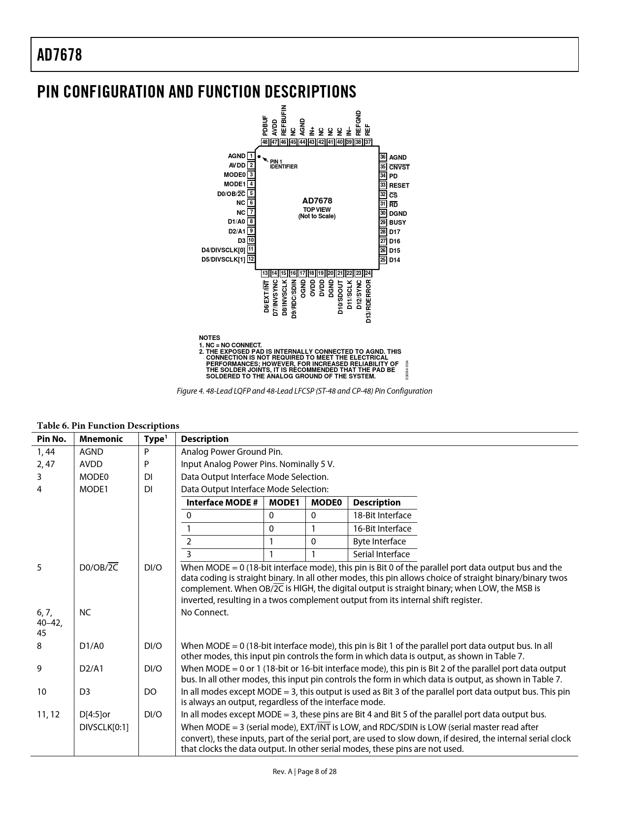

AD7678. PIN CONFIGURATION AND FUNCTION DESCRIPTIONS. BUF. DBU. 48 47 46 45 44 43 42 41 40 39 38 37. AGND 1. 36 AGND. PIN 1. AVDD 2
AD7678 PIN CONFIGURATION AND FUNCTION DESCRIPTIONS BUF DBU 48 47 46 45 44 43 42 41 40 39 38 37 AGND 1 36 AGND PIN 1 AVDD 2
link to page 11 link to page 11 link to page 11
AD7678 PIN CONFIGURATION AND FUNCTION DESCRIPTIONS IN F ND D BUF G D F ND F F DBU + P AV RE NC AG IN NC NC NC IN RE RE 48 47 46 45 44 43 42 41 40 39 38 37 AGND 1 36 AGND PIN 1 AVDD 2 IDENTIFIER 35 CNVST MODE0 3 34 PD MODE1 4 33 RESET 5 D0/OB/2C 32 CS NC 6 AD7678 31 RD TOP VIEW NC 7 30 (Not to Scale) DGND D1/A0 8 29 BUSY D2/A1 9 28 D17 D3 10 27 D16 11 D4/DIVSCLK[0] 26 D15 D5/DIVSCLK[1] 12 25 D14 13 14 15 16 17 18 19 20 21 22 23 24 C K D D D T K R N IN N D D ND U L NC /INT O Y CL D T O C Y R S S S X OV DV DG D S R V V OG /S E S 1 DC/ /IN IN DE R D1 D12/ D6/ 7 /R D D8/ D10/ 3 D9/ D1 NOTES 1. NC = NO CONNECT. 2. THE EXPOSED PAD IS INTERNALLY CONNECTED TO AGND. THIS CONNECTION IS NOT REQUIRED TO MEET THE ELECTRICAL
4
PERFORMANCES; HOWEVER, FOR INCREASED RELIABILITY OF
00 4-
THE SOLDER JOINTS, IT IS RECOMMENDED THAT THE PAD BE
08
SOLDERED TO THE ANALOG GROUND OF THE SYSTEM.
03 Figure 4. 48-Lead LQFP and 48-Lead LFCSP (ST-48 and CP-48) Pin Configuration
Table 6. Pin Function Descriptions Pin No. Mnemonic Type1 Description
1, 44 AGND P Analog Power Ground Pin. 2, 47 AVDD P Input Analog Power Pins. Nominally 5 V. 3 MODE0 DI Data Output Interface Mode Selection. 4 MODE1 DI Data Output Interface Mode Selection:
Interface MODE # MODE1 MODE0 Description
0 0 0 18-Bit Interface 1 0 1 16-Bit Interface 2 1 0 Byte Interface 3 1 1 Serial Interface 5 D0/OB/2C DI/O When MODE = 0 (18-bit interface mode), this pin is Bit 0 of the parallel port data output bus and the data coding is straight binary. In all other modes, this pin allows choice of straight binary/binary twos complement. When OB/2C is HIGH, the digital output is straight binary; when LOW, the MSB is inverted, resulting in a twos complement output from its internal shift register. 6, 7, NC No Connect. 40–42, 45 8 D1/A0 DI/O When MODE = 0 (18-bit interface mode), this pin is Bit 1 of the parallel port data output bus. In all other modes, this input pin controls the form in which data is output, as shown in Table 7. 9 D2/A1 DI/O When MODE = 0 or 1 (18-bit or 16-bit interface mode), this pin is Bit 2 of the parallel port data output bus. In all other modes, this input pin controls the form in which data is output, as shown in Table 7. 10 D3 DO In all modes except MODE = 3, this output is used as Bit 3 of the parallel port data output bus. This pin is always an output, regardless of the interface mode. 11, 12 D[4:5]or DI/O In all modes except MODE = 3, these pins are Bit 4 and Bit 5 of the parallel port data output bus. DIVSCLK[0:1] When MODE = 3 (serial mode), EXT/INT is LOW, and RDC/SDIN is LOW (serial master read after convert), these inputs, part of the serial port, are used to slow down, if desired, the internal serial clock that clocks the data output. In other serial modes, these pins are not used. Rev. A | Page 8 of 28 Document Outline Specifications Timing Specifications Absolute Maximum Ratings ESD Caution Pin Configuration and Function Descriptions Definition of Specifications Integral Nonlinearity Error (INL) Differential Nonlinearity Error (DNL) Gain Error Zero Error Spurious-Free Dynamic Range (SFDR) Effective Number of Bits (ENOB) Total Harmonic Distortion (THD) Dynamic Range Signal-to-Noise Ratio (SNR) Signal-to-(Noise + Distortion) Ratio (S/[N+D]) Aperture Delay Transient Response Typical Performance Characteristics Circuit Information Converter Operation Transfer Functions Typical Connection Diagram Analog Inputs Driver Amplifier Choice Single-to-Differential Driver Voltage Reference Power Supply Power Dissipation versus Throughput Conversion Control Digital Interface Parallel Interface Serial Interface Master Serial Interface Internal Clock Slave Serial Interface External Clock External Discontinuous Clock Data Read after Conversion External Clock Data Read during Conversion Microprocessor Interfacing SPI Interface (ADSP-219x) Application Hints Layout Evaluating the AD7678’s Performance Outline Dimensions Ordering Guide
