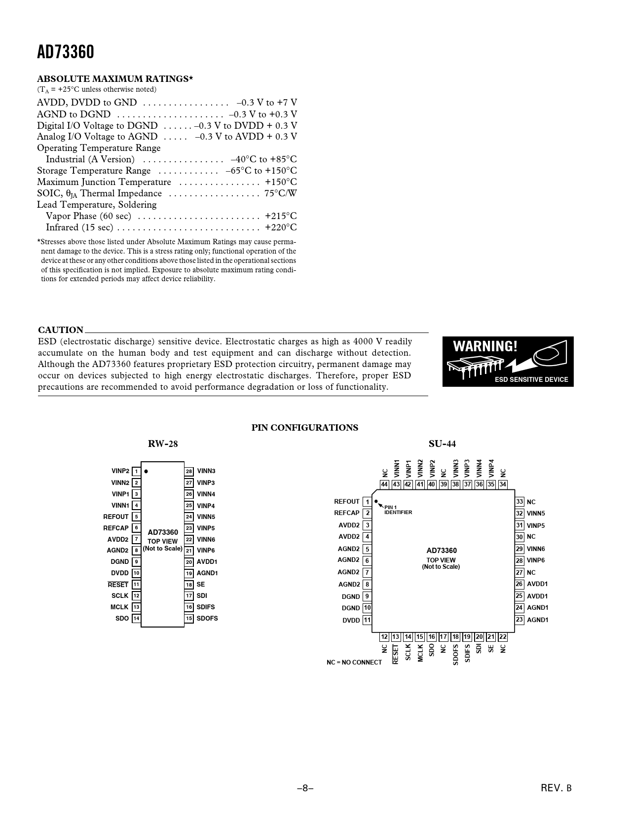

AD73360. ABSOLUTE MAXIMUM RATINGS*. CAUTION. WARNING!. ESD SENSITIVE DEVICE. PIN CONFIGURATIONS. RW-28. SU-44. VINP2 1. VINN3. VINN1. VINP1
AD73360 ABSOLUTE MAXIMUM RATINGS* CAUTION WARNING! ESD SENSITIVE DEVICE PIN CONFIGURATIONS RW-28 SU-44 VINP2 1 VINN3 VINN1 VINP1
(TA = +25°C unless otherwise noted) AVDD, DVDD to GND . –0.3 V to +7 V AGND to DGND . –0.3 V to +0.3 V Digital I/O Voltage to DGND . –0.3 V to DVDD + 0.3 V Analog I/O Voltage to AGND . –0.3 V to AVDD + 0.3 V Operating Temperature Range Industrial (A Version) . –40°C to +85°C Storage Temperature Range . –65°C to +150°C Maximum Junction Temperature . +150°C SOIC, θJA Thermal Impedance . 75°C/W Lead Temperature, Soldering Vapor Phase (60 sec) . +215°C Infrared (15 sec) . +220°C *Stresses above those listed under Absolute Maximum Ratings may cause perma- nent damage to the device. This is a stress rating only; functional operation of the device at these or any other conditions above those listed in the operational sections of this specification is not implied. Exposure to absolute maximum rating condi- tions for extended periods may affect device reliability.
CAUTION
ESD (electrostatic discharge) sensitive device. Electrostatic charges as high as 4000 V readily
WARNING!
accumulate on the human body and test equipment and can discharge without detection. Although the AD73360 features proprietary ESD protection circuitry, permanent damage may occur on devices subjected to high energy electrostatic discharges. Therefore, proper ESD
precautions are recommended to avoid performance degradation or loss of functionality.
PIN CONFIGURATIONS RW-28 SU-44 VINP2 1 28 VINN3 NC VINN1 VINP1 VINN2 VINP2 NC VINN3 VINP3 VINN4 VINP4 NC VINN2 2 27 VINP3 4 4 43 42 41 40 39 38 37 36 5 3 4 3 VINP1 3 26 VINN4 REFOUT 1 33 NC VINN1 4 25 VINP4 PIN 1 REFCAP 2 IDENTIFIER 32 VINN5 REFOUT 5 24 VINN5 AVDD2 3 31 VINP5 REFCAP 6 23 VINP5 AD73360 AVDD2 4 30 NC AVDD2 7 TOP VIEW 22 VINN6 (Not to Scale) AGND2 8 21 VINP6 AGND2 5 29 VINN6 AD73360 DGND 9 20 AVDD1 AGND2 6 TOP VIEW 28 VINP6 (Not to Scale) DVDD 10 19 AGND1 AGND2 7 27 NC RESET 11 18 SE AGND2 8 26 AVDD1 SCLK 12 17 SDI DGND 9 25 AVDD1 MCLK 13 16 SDIFS DGND 10 24 AGND1 SDO 14 15 SDOFS DVDD 11 23 AGND1 12 13 14 15 16 17 18 19 20 21 22 NC NC SDI SE NC SDO NC = NO CONNECT SCLK MCLK SDIFS RESET SDOFS
