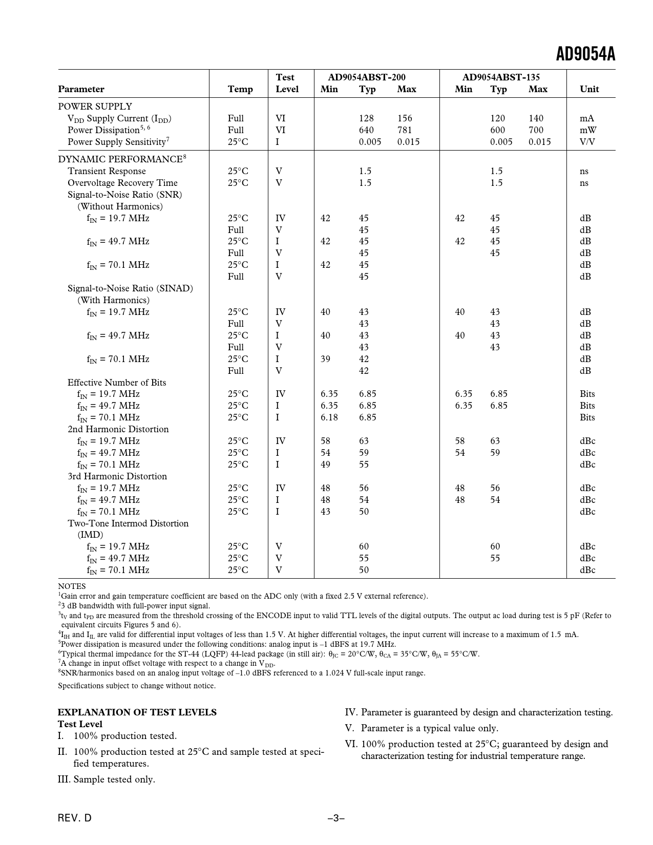

AD9054A. Test. AD9054ABST-200. AD9054ABST-135. Parameter. Temp. Level. Min. Typ. Max. Unit. EXPLANATION OF TEST LEVELS. Test Level
AD9054A Test AD9054ABST-200 AD9054ABST-135 Parameter Temp Level Min Typ Max Unit EXPLANATION OF TEST LEVELS Test Level
AD9054A Test AD9054ABST-200 AD9054ABST-135 Parameter Temp Level Min Typ Max Min Typ Max Unit
POWER SUPPLY VDD Supply Current (IDD) Full VI 128 156 120 140 mA Power Dissipation5, 6 Full VI 640 781 600 700 mW Power Supply Sensitivity7 25°C I 0.005 0.015 0.005 0.015 V/V DYNAMIC PERFORMANCE8 Transient Response 25°C V 1.5 1.5 ns Overvoltage Recovery Time 25°C V 1.5 1.5 ns Signal-to-Noise Ratio (SNR) (Without Harmonics) fIN = 19.7 MHz 25°C IV 42 45 42 45 dB Full V 45 45 dB fIN = 49.7 MHz 25°C I 42 45 42 45 dB Full V 45 45 dB fIN = 70.1 MHz 25°C I 42 45 dB Full V 45 dB Signal-to-Noise Ratio (SINAD) (With Harmonics) fIN = 19.7 MHz 25°C IV 40 43 40 43 dB Full V 43 43 dB fIN = 49.7 MHz 25°C I 40 43 40 43 dB Full V 43 43 dB fIN = 70.1 MHz 25°C I 39 42 dB Full V 42 dB Effective Number of Bits fIN = 19.7 MHz 25°C IV 6.35 6.85 6.35 6.85 Bits fIN = 49.7 MHz 25°C I 6.35 6.85 6.35 6.85 Bits fIN = 70.1 MHz 25°C I 6.18 6.85 Bits 2nd Harmonic Distortion fIN = 19.7 MHz 25°C IV 58 63 58 63 dBc fIN = 49.7 MHz 25°C I 54 59 54 59 dBc fIN = 70.1 MHz 25°C I 49 55 dBc 3rd Harmonic Distortion fIN = 19.7 MHz 25°C IV 48 56 48 56 dBc fIN = 49.7 MHz 25°C I 48 54 48 54 dBc fIN = 70.1 MHz 25°C I 43 50 dBc Two-Tone Intermod Distortion (IMD) fIN = 19.7 MHz 25°C V 60 60 dBc fIN = 49.7 MHz 25°C V 55 55 dBc fIN = 70.1 MHz 25°C V 50 dBc NOTES 1Gain error and gain temperature coefficient are based on the ADC only (with a fixed 2.5 V external reference). 23 dB bandwidth with full-power input signal. 3tV and tPD are measured from the threshold crossing of the ENCODE input to valid TTL levels of the digital outputs. The output ac load during test is 5 pF (Refer to equivalent circuits Figures 5 and 6). 4IIH and IIL are valid for differential input voltages of less than 1.5 V. At higher differential voltages, the input current will increase to a maximum of 1.5 mA. 5Power dissipation is measured under the following conditions: analog input is –1 dBFS at 19.7 MHz. 6Typical thermal impedance for the ST-44 (LQFP) 44-lead package (in still air): θJC = 20°C/W, θCA = 35°C/W, θJA = 55°C/W. 7A change in input offset voltage with respect to a change in VDD. 8SNR/harmonics based on an analog input voltage of –1.0 dBFS referenced to a 1.024 V full-scale input range. Specifications subject to change without notice.
IV. Parameter is guaranteed by design and characterization testing.
Test Level
V. Parameter is a typical value only. I. 100% production tested. VI. 100% production tested at 25°C; guaranteed by design and II. 100% production tested at 25°C and sample tested at speci- characterization testing for industrial temperature range. fied temperatures. III. Sample tested only. REV. D –3–
