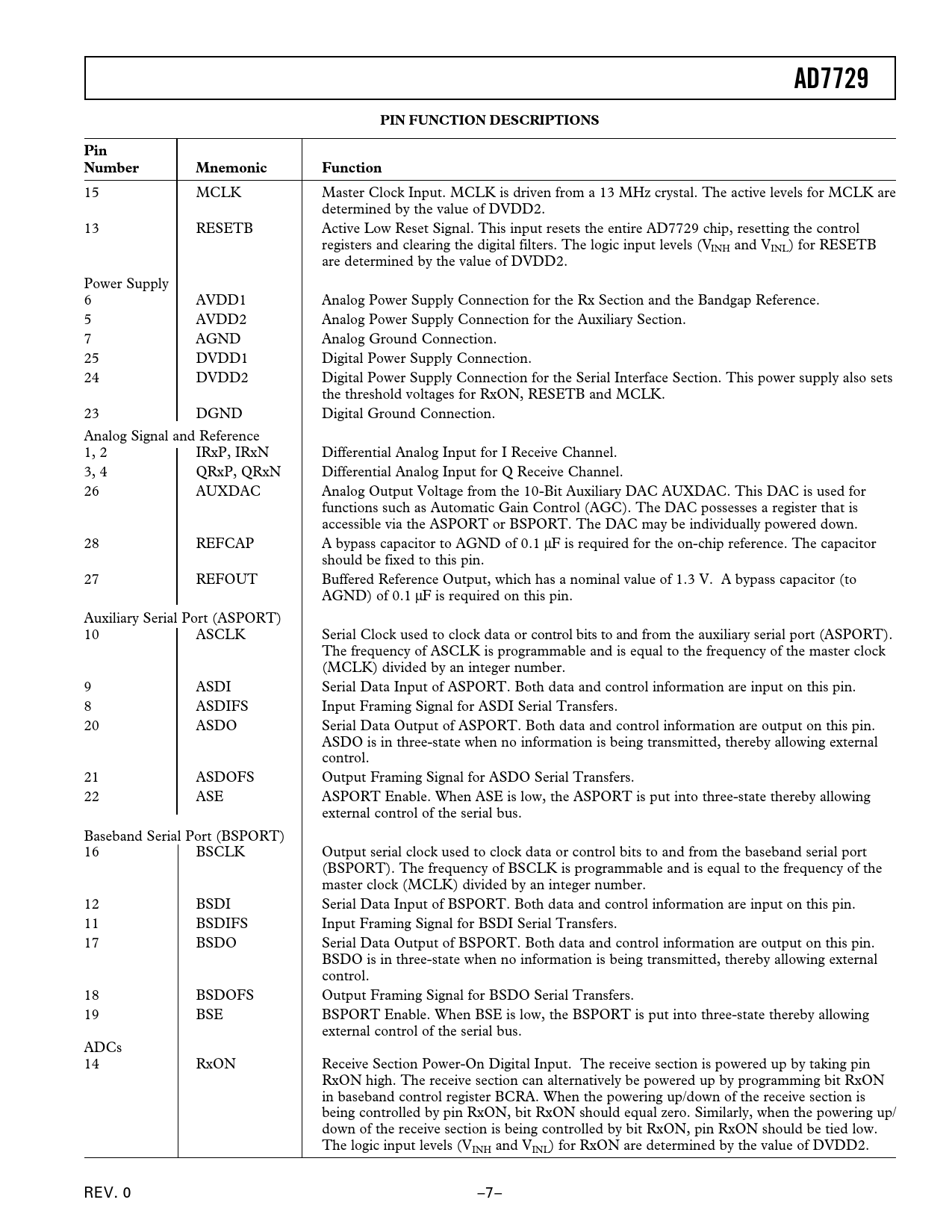

AD7729. PIN FUNCTION DESCRIPTIONS. Pin Number. Mnemonic. Function
AD7729 PIN FUNCTION DESCRIPTIONS Pin Number Mnemonic Function
15 MCLK Master Clock Input. MCLK is driven from a 13 MHz crystal. The active levels for MCLK are determined by the value of DVDD2. 13 RESETB Active Low Reset Signal. This input resets the entire AD7729 chip, resetting the control registers and clearing the digital filters. The logic input levels (VINH and VINL) for RESETB are determined by the value of DVDD2. Power Supply 6 AVDD1 Analog Power Supply Connection for the Rx Section and the Bandgap Reference. 5 AVDD2 Analog Power Supply Connection for the Auxiliary Section. 7 AGND Analog Ground Connection. 25 DVDD1 Digital Power Supply Connection. 24 DVDD2 Digital Power Supply Connection for the Serial Interface Section. This power supply also sets the threshold voltages for RxON, RESETB and MCLK. 23 DGND Digital Ground Connection. Analog Signal and Reference 1, 2 IRxP, IRxN Differential Analog Input for I Receive Channel. 3, 4 QRxP, QRxN Differential Analog Input for Q Receive Channel. 26 AUXDAC Analog Output Voltage from the 10-Bit Auxiliary DAC AUXDAC. This DAC is used for functions such as Automatic Gain Control (AGC). The DAC possesses a register that is accessible via the ASPORT or BSPORT. The DAC may be individually powered down. 28 REFCAP A bypass capacitor to AGND of 0.1 µF is required for the on-chip reference. The capacitor should be fixed to this pin. 27 REFOUT Buffered Reference Output, which has a nominal value of 1.3 V. A bypass capacitor (to AGND) of 0.1 µF is required on this pin. Auxiliary Serial Port (ASPORT) 10 ASCLK Serial Clock used to clock data or control bits to and from the auxiliary serial port (ASPORT). The frequency of ASCLK is programmable and is equal to the frequency of the master clock (MCLK) divided by an integer number. 9 ASDI Serial Data Input of ASPORT. Both data and control information are input on this pin. 8 ASDIFS Input Framing Signal for ASDI Serial Transfers. 20 ASDO Serial Data Output of ASPORT. Both data and control information are output on this pin. ASDO is in three-state when no information is being transmitted, thereby allowing external control. 21 ASDOFS Output Framing Signal for ASDO Serial Transfers. 22 ASE ASPORT Enable. When ASE is low, the ASPORT is put into three-state thereby allowing external control of the serial bus. Baseband Serial Port (BSPORT) 16 BSCLK Output serial clock used to clock data or control bits to and from the baseband serial port (BSPORT). The frequency of BSCLK is programmable and is equal to the frequency of the master clock (MCLK) divided by an integer number. 12 BSDI Serial Data Input of BSPORT. Both data and control information are input on this pin. 11 BSDIFS Input Framing Signal for BSDI Serial Transfers. 17 BSDO Serial Data Output of BSPORT. Both data and control information are output on this pin. BSDO is in three-state when no information is being transmitted, thereby allowing external control. 18 BSDOFS Output Framing Signal for BSDO Serial Transfers. 19 BSE BSPORT Enable. When BSE is low, the BSPORT is put into three-state thereby allowing external control of the serial bus. ADCs 14 RxON Receive Section Power-On Digital Input. The receive section is powered up by taking pin RxON high. The receive section can alternatively be powered up by programming bit RxON in baseband control register BCRA. When the powering up/down of the receive section is being controlled by pin RxON, bit RxON should equal zero. Similarly, when the powering up/ down of the receive section is being controlled by bit RxON, pin RxON should be tied low. The logic input levels (VINH and VINL) for RxON are determined by the value of DVDD2. REV. 0 –7–
