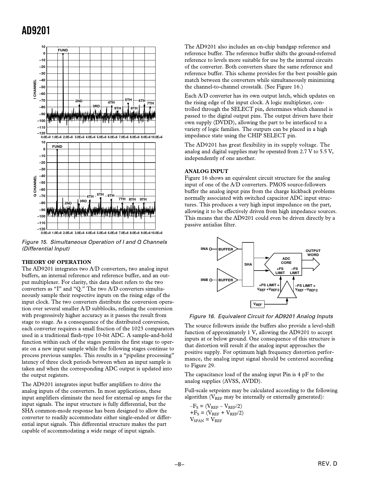

The AD9201 also includes an on-chip bandgap reference and
FUND 0
reference buffer. The reference buffer shifts the ground-referred
–10
reference to levels more suitable for use by the internal circuits
–20
of the converter. Both converters share the same reference and
–30
reference buffer. This scheme provides for the best possible gain
–40
match between the converters while simultaneously minimizing
–50
the channel-to-channel crosstalk. (See Figure 16.)
–60
Each A/D converter has its own output latch, which updates on
I CHANNEL –70 2ND 5TH 6TH 4TH 7TH
the rising edge of the input clock. A logic multiplexer, con-
–80 3RD 9TH 8TH
trolled through the SELECT pin, determines which channel is
–90
passed to the digital output pins. The output drivers have their
–100
own supply (DVDD), allowing the part to be interfaced to a
–110
variety of logic families. The outputs can be placed in a high
–120 0.0E+0 1.0E+6 2.0E+6 3.0E+6 4.0E+6 5.0E+6 6.0E+6 7.0E+6 8.0E+6 9.0E+6 10.0E+6
impedance state using the CHIP SELECT pin.

The AD9201 has great flexibility in its supply voltage. The
FUND 0
analog and digital supplies may be operated from 2.7 V to 5.5 V,
–10
independently of one another.
–20 –30 ANALOG INPUT –40
Figure 16 shows an equivalent circuit structure for the analog
–50
input of one of the A/D converters. PMOS source-followers
–60
buffer the analog input pins from the charge kickback problems
Q CHANNEL –70 5TH 4TH 6TH 7TH 8TH 9TH
normally associated with switched capacitor ADC input struc-
–80 3RD 2ND
tures. This produces a very high input impedance on the part,
–90
allowing it to be effectively driven from high impedance sources.
–100
This means that the AD9201 could even be driven directly by a
–110
passive antialias filter.
Figure 15. Simultaneous Operation of I and Q Channels (Differential Input)
