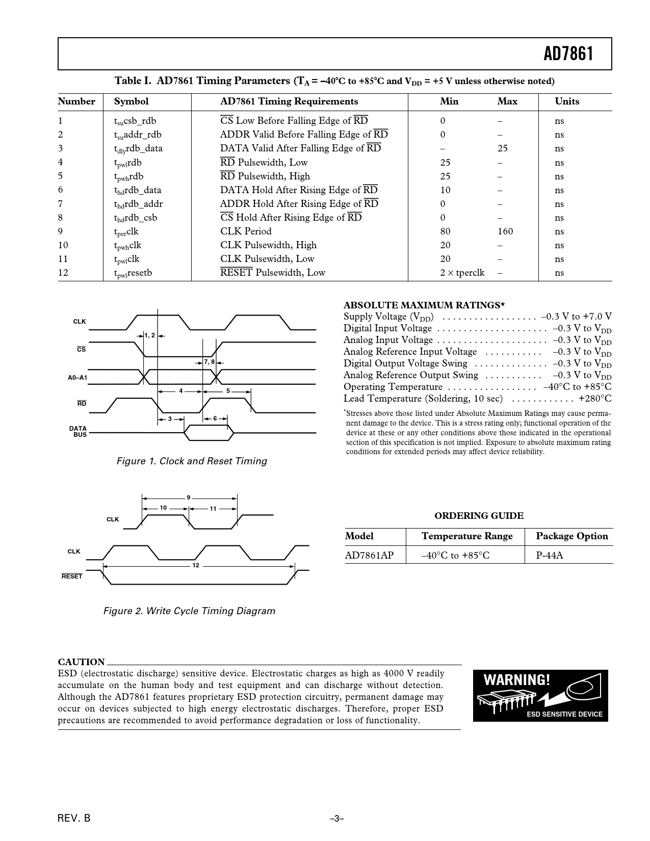

AD7861. Table I. AD7861 Timing Parameters (TA = –40. C to +85. C and VDD = +5 V unless otherwise noted). Number. Symbol
AD7861 Table I AD7861 Timing Parameters (TA = –40 C to +85 C and VDD = +5 V unless otherwise noted) Number Symbol
AD7861 Table I. AD7861 Timing Parameters (TA = –40
C to +85
C and VDD = +5 V unless otherwise noted) Number Symbol AD7861 Timing Requirements Min Max Units
1 tsucsb_rdb CS Low Before Falling Edge of RD 0 – ns 2 tsuaddr_rdb ADDR Valid Before Falling Edge of RD 0 – ns 3 tdlyrdb_data DATA Valid After Falling Edge of RD – 25 ns 4 tpwlrdb RD Pulsewidth, Low 25 – ns 5 tpwhrdb RD Pulsewidth, High 25 – ns 6 thdrdb_data DATA Hold After Rising Edge of RD 10 – ns 7 thdrdb_addr ADDR Hold After Rising Edge of RD 0 – ns 8 thdrdb_csb CS Hold After Rising Edge of RD 0 – ns 9 tperclk CLK Period 80 160 ns 10 tpwhclk CLK Pulsewidth, High 20 – ns 11 tpwlclk CLK Pulsewidth, Low 20 – ns 12 tpwlresetb RESET Pulsewidth, Low 2 × tperclk – ns
ABSOLUTE MAXIMUM RATINGS*
Supply Voltage (V
CLK
DD) . –0.3 V to +7.0 V Digital Input Voltage . –0.3 V to VDD
1, 2
Analog Input Voltage . –0.3 V to VDD
CS
Analog Reference Input Voltage . –0.3 V to VDD
7, 8
Digital Output Voltage Swing . –0.3 V to VDD
A0–A1
Analog Reference Output Swing . –0.3 V to VDD Operating Temperature . –40°C to +85°C
4 5
Lead Temperature (Soldering, 10 sec) . +280°C
RD
*Stresses above those listed under Absolute Maximum Ratings may cause perma-
3 6
nent damage to the device. This is a stress rating only; functional operation of the
DATA BUS
device at these or any other conditions above those indicated in the operational section of this specification is not implied. Exposure to absolute maximum rating conditions for extended periods may affect device reliability. Figure 1. Clock and Reset Timing
9 10 11 ORDERING GUIDE CLK Model Temperature Range Package Option CLK
AD7861AP –40°C to +85°C P-44A
12 RESET
Figure 2. Write Cycle Timing Diagram
