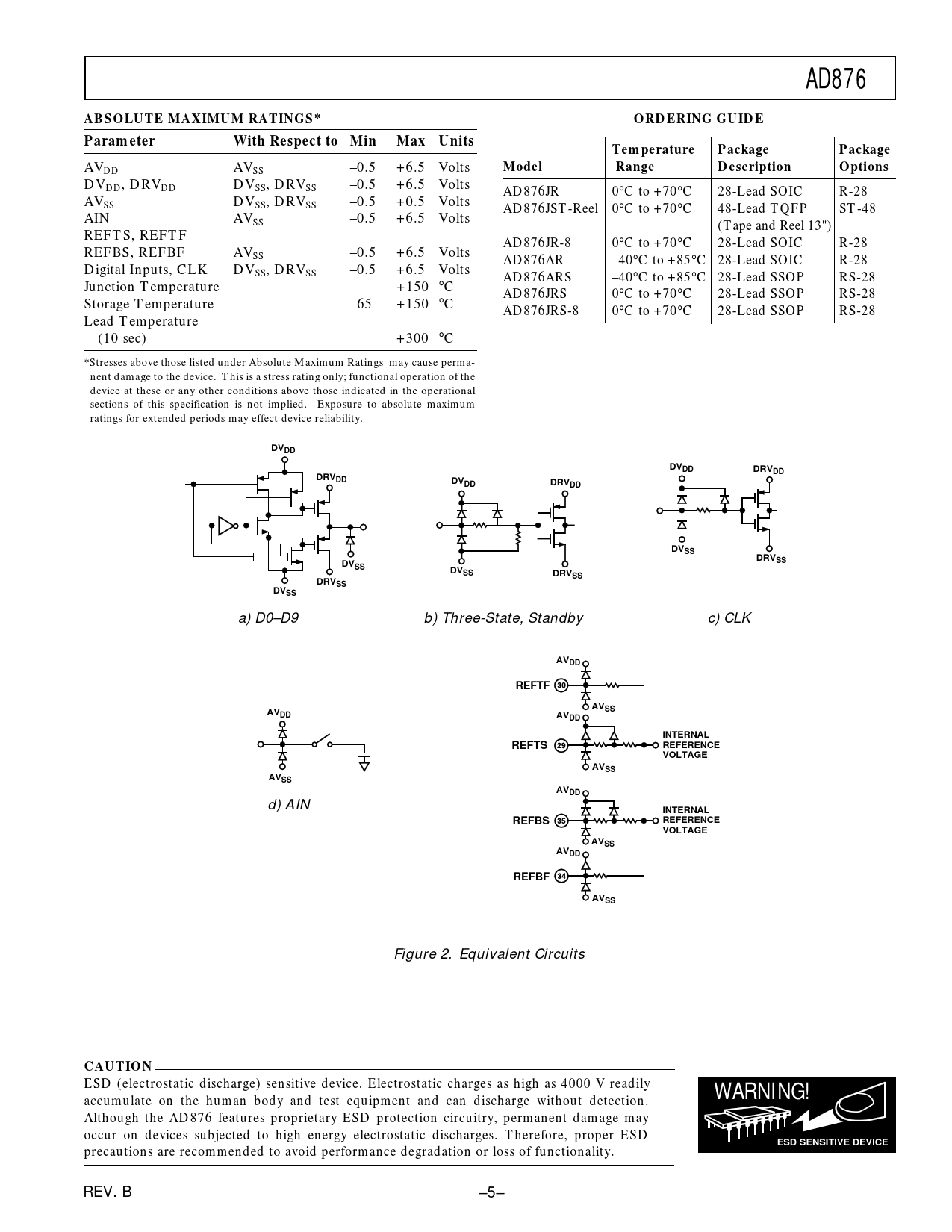

AD876. ABSOLUTE MAXIMUM RATINGS*. ORDERING GUIDE. Parameter. With Respect to Min. Max Units. Temperature. Package. Model. Range
AD876 ABSOLUTE MAXIMUM RATINGS* ORDERING GUIDE Parameter With Respect to Min Max Units Temperature Package Model Range
AD876 ABSOLUTE MAXIMUM RATINGS* ORDERING GUIDE Parameter With Respect to Min Max Units Temperature Package Package
AV
Model Range Description Options
DD AVSS –0.5 +6.5 Volts DVDD, DRVDD DVSS, DRVSS –0.5 +6.5 Volts AD876JR 0°C to +70°C 28-Lead SOIC R-28 AVSS DVSS, DRVSS –0.5 +0.5 Volts AD876JST-Reel 0°C to +70°C 48-Lead TQFP ST-48 AIN AVSS –0.5 +6.5 Volts (Tape and Reel 13") REFTS, REFTF AD876JR-8 0°C to +70°C 28-Lead SOIC R-28 REFBS, REFBF AVSS –0.5 +6.5 Volts AD876AR –40°C to +85°C 28-Lead SOIC R-28 Digital Inputs, CLK DVSS, DRVSS –0.5 +6.5 Volts AD876ARS –40°C to +85°C 28-Lead SSOP RS-28 Junction Temperature +150 °C AD876JRS 0°C to +70°C 28-Lead SSOP RS-28 Storage Temperature –65 +150 °C AD876JRS-8 0°C to +70°C 28-Lead SSOP RS-28 Lead Temperature (10 sec) +300 °C *Stresses above those listed under Absolute Maximum Ratings may cause perma- nent damage to the device. This is a stress rating only; functional operation of the device at these or any other conditions above those indicated in the operational sections of this specification is not implied. Exposure to absolute maximum ratings for extended periods may effect device reliability.
DVDD DVDD DRVDD DRVDD DVDD DRVDD DVSS DRV DV SS SS DVSS DRVSS DRVSS DVSS
a) D0–D9 b) Three-State, Standby c) CLK
AVDD REFTF AVSS AVDD AVDD INTERNAL REFTS REFERENCE VOLTAGE AVSS AVSS AVDD
d) AIN
INTERNAL REFBS REFERENCE VOLTAGE AVSS AVDD REFBF AVSS
Figure 2. Equivalent Circuits
