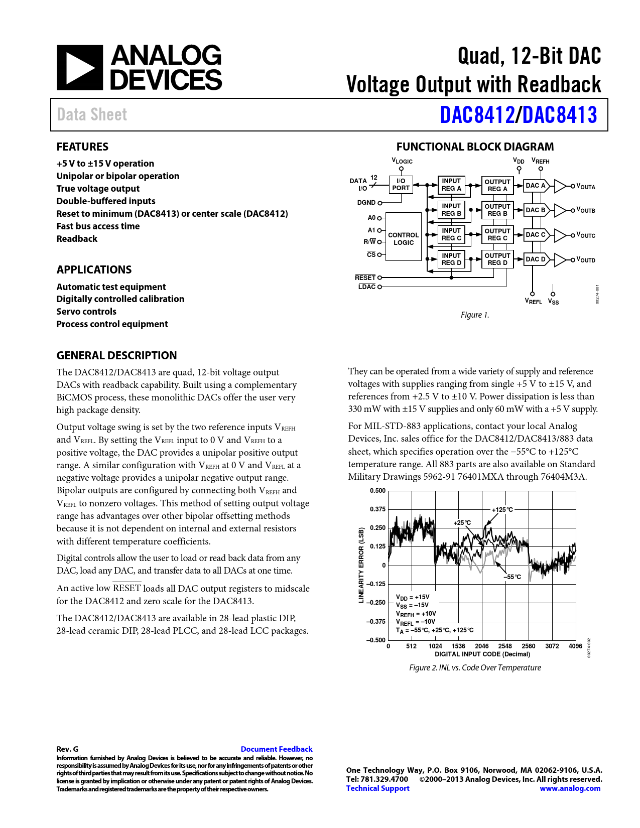

Quad, 12-Bit DAC. Voltage Output with Readback. Data Sheet. DAC8412/. DAC8413. FEATURES. FUNCTIONAL BLOCK DIAGRAM
Datasheet DAC8412, DAC8413 Analog Devices, Revision: G
Quad, 12-Bit DAC Voltage Output with Readback Data Sheet DAC8412/ DAC8413 FEATURES FUNCTIONAL BLOCK DIAGRAM +5 V to ±15 V operation VLOGIC VDD VREFH Unipolar or bipolar operation 12 DATA I/O INPUT OUTPUT True voltage output V I/O PORT REG A DAC A REG A OUTA Double-buffered inputs DGND INPUT OUTPUT Reset to minimum (DAC8413) or center scale (DAC8412) DAC B V REG B REG B OUTB A0 Fast bus access time A1 INPUT OUTPUT Readback CONTROL DAC C V REG C REG C OUTC R/W LOGIC CS INPUT OUTPUT DAC D VOUTD APPLICATIONS REG D REG D RESET Automatic test equipment LDAC

Figure 1.

The DAC8412/DAC8413 are quad, 12-bit voltage output They can be operated from a wide variety of supply and reference DACs with readback capability. Built using a complementary voltages with supplies ranging from single +5 V to ±15 V, and BiCMOS process, these monolithic DACs offer the user very references from +2.5 V to ±10 V. Power dissipation is less than high package density. 330 mW with ±15 V supplies and only 60 mW with a +5 V supply. Output voltage swing is set by the two reference inputs VREFH For MIL-STD-883 applications, contact your local Analog and VREFL. By setting the VREFL input to 0 V and VREFH to a Devices, Inc. sales office for the DAC8412/DAC8413/883 data positive voltage, the DAC provides a unipolar positive output sheet, which specifies operation over the −55°C to +125°C range. A similar configuration with VREFH at 0 V and VREFL at a temperature range. Al 883 parts are also available on Standard negative voltage provides a unipolar negative output range. Military Drawings 5962-91 76401MXA through 76404M3A. Bipolar outputs are configured by connecting both VREFH and
0.500
VREFL to nonzero voltages. This method of setting output voltage
0.375
range has advantages over other bipolar offsetting methods
+125°C
because it is not dependent on internal and external resistors
+25°C 0.250 B)
with different temperature coefficients.
S L 0.125 R (
Digital controls al ow the user to load or read back data from any
RRO
DAC, load any DAC, and transfer data to al DACs at one time.
E 0 Y T –55°C
An active low RESET loads all DAC output registers to midscale
ARI –0.125
for the DAC8412 and zero scale for the DAC8413.
INE V L DD = +15V –0.250 VSS = –15V
The DAC8412/DAC8413 are available in 28-lead plastic DIP,
VREFH = +10V –0.375 VREFL = –10V
28-lead ceramic DIP, 28-lead PLCC, and 28-lead LCC packages.
TA = –55°C, +25°C, +125°C –0.500 0 512 1024 1536 2046 2548 2560 3072 4096
002
DIGITAL INPUT CODE (Decimal)
00274- Figure 2. INL vs. Code Over Temperature
