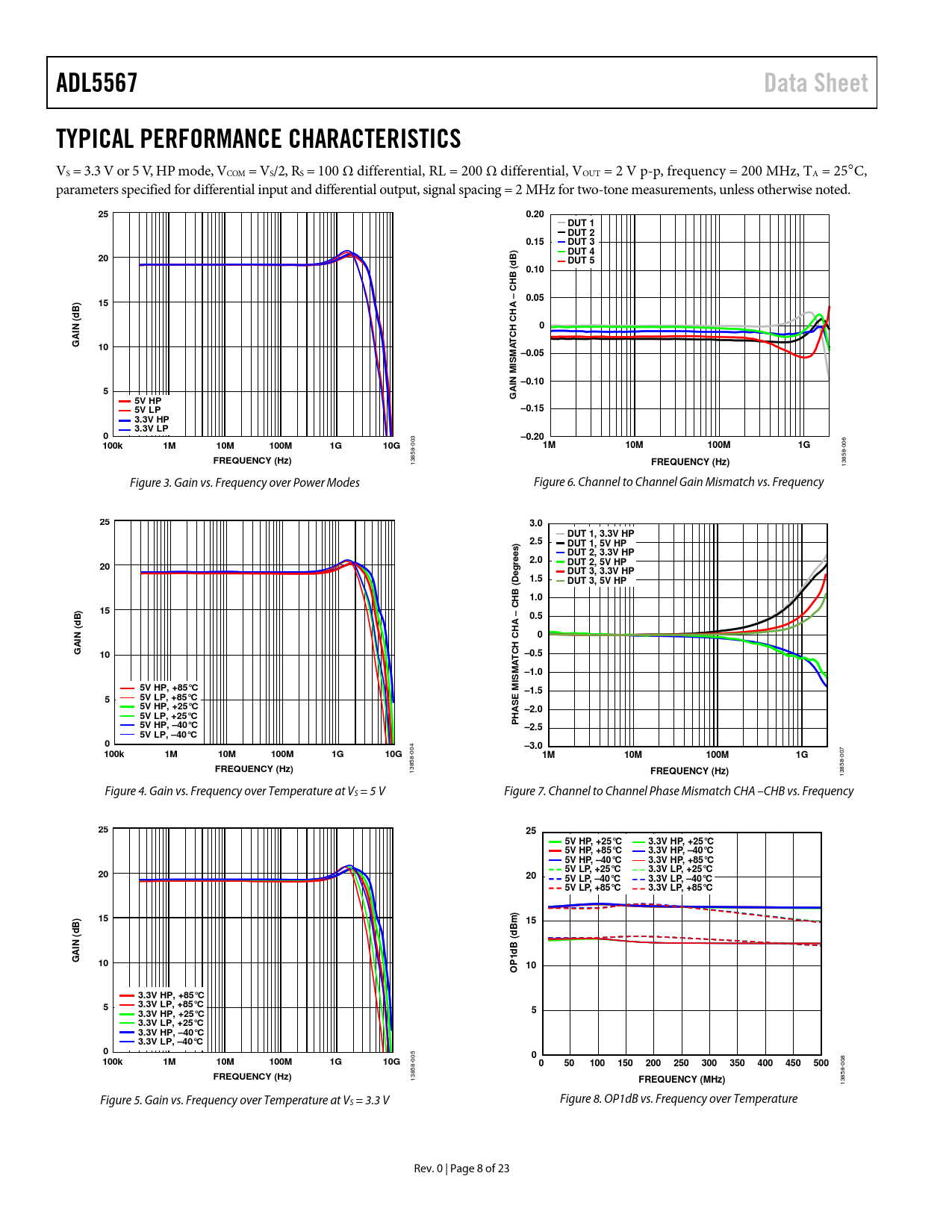

ADL5567. Data Sheet. TYPICAL PERFORMANCE CHARACTERISTICS. 0.20. DUT 1 DUT 2. 0.15. DUT 3 DUT 4. B) d. DUT 5. 0.10. – CHB (. 0.05. d N (. CH CH
ADL5567 Data Sheet TYPICAL PERFORMANCE CHARACTERISTICS 0.20 DUT 1 DUT 2 0.15 DUT 3 DUT 4 B) d DUT 5 0.10 – CHB ( 0.05 d N ( CH CH
VS = 3.3 V or 5 V, HP mode, VCOM = VS/2, RS = 100 Ω differential, RL = 200 Ω differential, VOUT = 2 V p-p, frequency = 200 MHz, TA = 25°C, parameters specified for differential input and differential output, signal spacing = 2 MHz for two-tone measurements, unless otherwise noted.
25 0.20 DUT 1 DUT 2 0.15 DUT 3 DUT 4 20 B) d DUT 5 0.10 – CHB ( 0.05 15 B) A d N ( 0 AI CH CH G T 10 A M –0.05 IS M IN –0.10 5 GA 5V HP 5V LP –0.15 3.3V HP 3.3V LP 0 –0.20 100k 1M 10M 100M 1G 10G
003
1M 10M 100M 1G
006
FREQUENCY (Hz)
13858-
FREQUENCY (Hz)
13858- Figure 3. Gain vs. Frequency over Power Modes Figure 6. Channel to Channel Gain Mismatch vs. Frequency
25 3.0 DUT 1, 3.3V HP 2.5 DUT 1, 5V HP DUT 2, 3.3V HP rees) 2.0 DUT 2, 5V HP 20 DUT 3, 3.3V HP Deg 1.5 DUT 3, 5V HP 1.0 15 B) – CHB ( 0.5 d A N ( 0 AI G 10 CH CH T –0.5 A –1.0 SM 5V HP, +85°C –1.5 5 5V LP, +85°C 5V HP, +25°C SE MI A –2.0 5V LP, +25°C 5V HP, –40°C PH –2.5 5V LP, –40°C 0 –3.0 100k 1M 10M 100M 1G 10G
004
1M 10M 100M 1G
007
FREQUENCY (Hz)
13858-
FREQUENCY (Hz)
13858- Figure 4. Gain vs. Frequency over Temperature at VS = 5 V Figure 7. Channel to Channel Phase Mismatch CHA –CHB vs. Frequency
25 25 5V HP, +25°C 3.3V HP, +25°C 5V HP, +85°C 3.3V HP, –40°C 5V HP, –40°C 3.3V HP, +85°C 5V LP, +25°C 3.3V LP, +25°C 20 20 5V LP, –40°C 3.3V LP, –40°C 5V LP, +85°C 3.3V LP, +85°C 15 B) 15 d Bm) d N ( B ( AI G 1d 10 P 10 O 3.3V HP, +85°C 5 3.3V LP, +85°C 3.3V HP, +25°C 5 3.3V LP, +25°C 3.3V HP, –40°C 3.3V LP, –40°C 0 0 100k 1M 10M 100M 1G 10G
005
0 50 100 150 200 250 300 350 400 450 500
008
FREQUENCY (Hz)
13858-
FREQUENCY (MHz)
13858- Figure 5. Gain vs. Frequency over Temperature at VS = 3.3 V Figure 8. OP1dB vs. Frequency over Temperature Rev. 0 | Page 8 of 23 Document Outline FEATURES APPLICATIONS FUNCTIONAL BLOCK DIAGRAM GENERAL DESCRIPTION REVISION HISTORY SPECIFICATIONS ABSOLUTE MAXIMUM RATINGS THERMAL RESISTANCE ESD CAUTION PIN CONFIGURATION AND FUNCTION DESCRIPTIONS TYPICAL PERFORMANCE CHARACTERISTICS THEORY OF OPERATION APPLICATIONS INFORMATION BASIC CONNECTIONS INPUT AND OUTPUT INTERFACING Single-Ended Input to Differential Output INPUT AND OUTPUT EQUIVALENT CIRCUITS GAIN ADJUSTMENT AND INTERFACING EFFECT OF LOAD CAPACITANCE ADC INTERFACING SOLDERING INFORMATION AND RECOMMENDED LAND PATTERN EVALUATION BOARD OUTLINE DIMENSIONS ORDERING GUIDE
