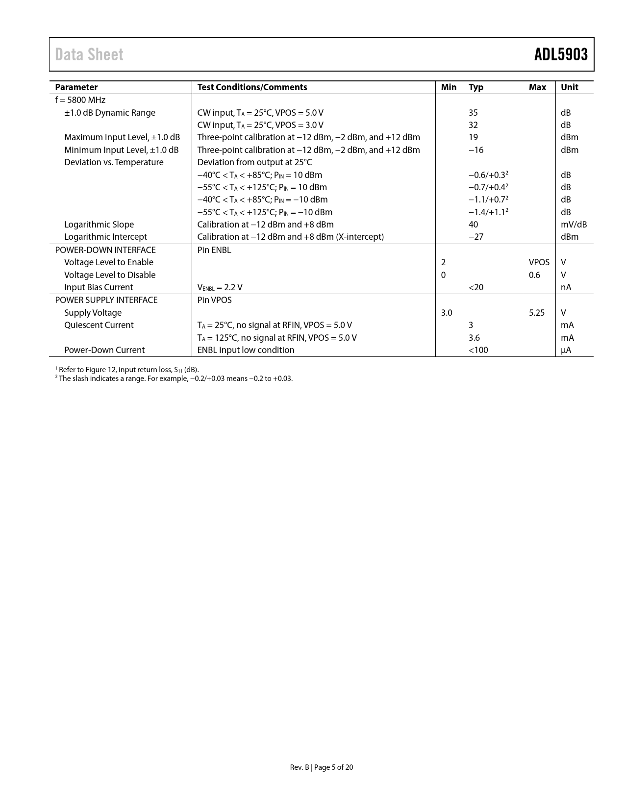

Data Sheet. ADL5903. Parameter. Test Conditions/Comments. Min Typ. Max. Unit
Data Sheet ADL5903 Parameter Test Conditions/Comments Min Typ Max Unit
link to page 11 link to page 7
f = 5800 MHz ±1.0 dB Dynamic Range CW input, TA = 25°C, VPOS = 5.0 V 35 dB CW input, TA = 25°C, VPOS = 3.0 V 32 dB Maximum Input Level, ±1.0 dB Three-point calibration at −12 dBm, −2 dBm, and +12 dBm 19 dBm Minimum Input Level, ±1.0 dB Three-point calibration at −12 dBm, −2 dBm, and +12 dBm −16 dBm Deviation vs. Temperature Deviation from output at 25°C −40°C < TA < +85°C; PIN = 10 dBm −0.6/+0.32 dB −55°C < TA < +125°C; PIN = 10 dBm −0.7/+0.42 dB −40°C < TA < +85°C; PIN = −10 dBm −1.1/+0.72 dB −55°C < TA < +125°C; PIN = −10 dBm −1.4/+1.12 dB Logarithmic Slope Calibration at −12 dBm and +8 dBm 40 mV/dB Logarithmic Intercept Calibration at −12 dBm and +8 dBm (X-intercept) −27 dBm POWER-DOWN INTERFACE Pin ENBL Voltage Level to Enable 2 VPOS V Voltage Level to Disable 0 0.6 V Input Bias Current VENBL = 2.2 V <20 nA POWER SUPPLY INTERFACE Pin VPOS Supply Voltage 3.0 5.25 V Quiescent Current TA = 25°C, no signal at RFIN, VPOS = 5.0 V 3 mA TA = 125°C, no signal at RFIN, VPOS = 5.0 V 3.6 mA Power-Down Current ENBL input low condition <100 µA 1 Refer to Figure 12, input return loss, S11 (dB). 2 The slash indicates a range. For example, −0.2/+0.03 means −0.2 to +0.03. Rev. B | Page 5 of 20 Document Outline FEATURES APPLICATIONS FUNCTIONAL BLOCK DIAGRAM GENERAL DESCRIPTION TABLE OF CONTENTS REVISION HISTORY SPECIFICATIONS ABSOLUTE MAXIMUM RATINGS ESD CAUTION PIN CONFIGURATION AND FUNCTION DESCRIPTIONS TYPICAL PERFORMANCE CHARACTERISTICS MEASUREMENT SETUPS THEORY OF OPERATION RF INPUT INTERFACE BASIC CONNECTIONS CHOOSING A VALUE FOR CRMS DEVICE CALIBRATION AND ERROR CALCULATION EVALUATION BOARD SCHEMATIC AND CONFIGURATION OPTIONS OUTLINE DIMENSIONS ORDERING GUIDE
